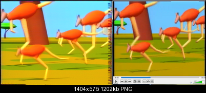

    Since several months I use QTGMC, but I have a problem with subtitles which are incorrectly deinterlaced.
    Original videos are captured in 768x576 MJPEG 24-bit with VirtualDub and an old Pinnacle DC10+.
    Usually I open videos in VirtualDub and save them to allow opening them with AVISynth scripts.
    (When I do that, videos are converted from MJPEG 24-bit to RGB 24-bit, but they can't be deinterlaced by softwares like VLC, I didn't manage to find how to avoid that).

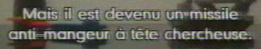

    Subtitles look like this :
Name:	Sans titre 01.png
    I use the following AVISynth Script :
    AviSource("xxxxx.avi").ConvertToYV12()
    QTGMC (Preset="Slow")
    SelectEven()
Name:	Sans titre 02.png
    Instead of :
Name:	Sans titre 03.png

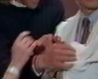

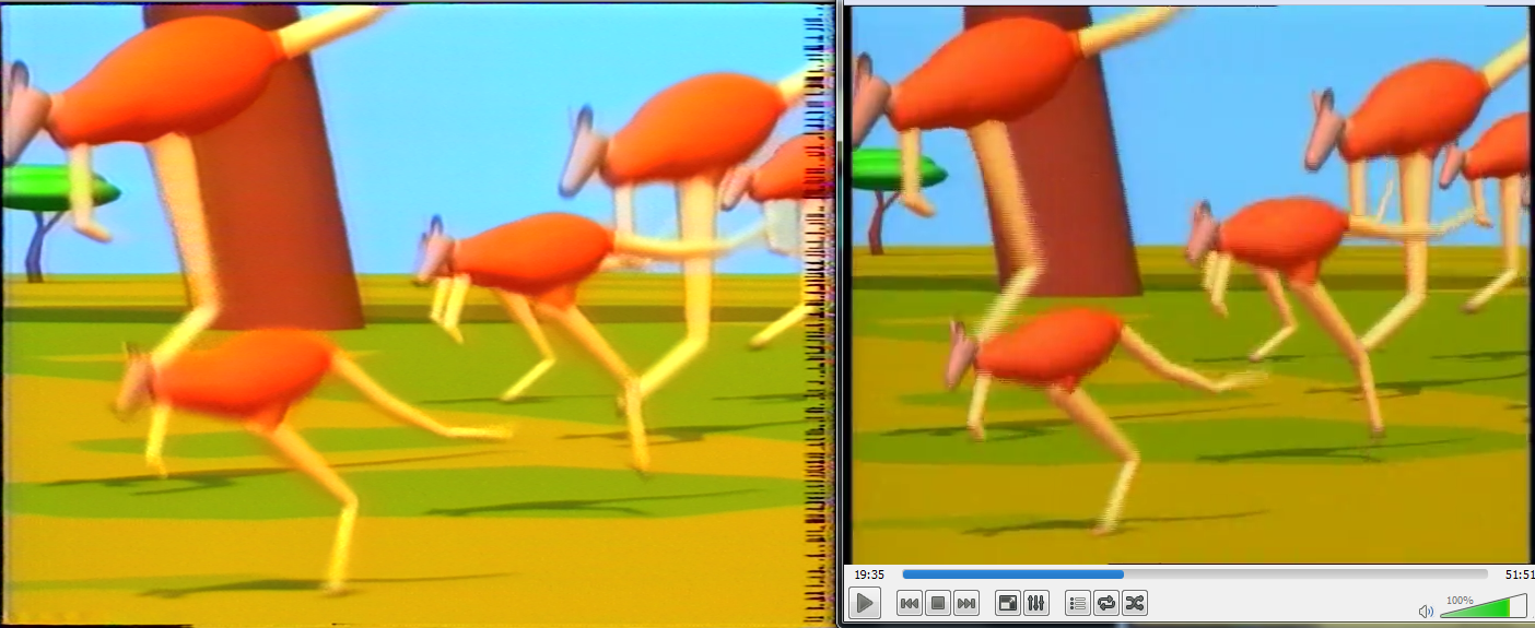

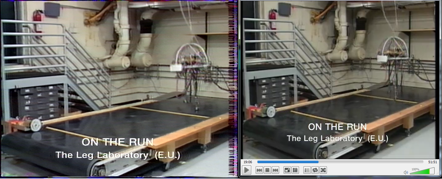

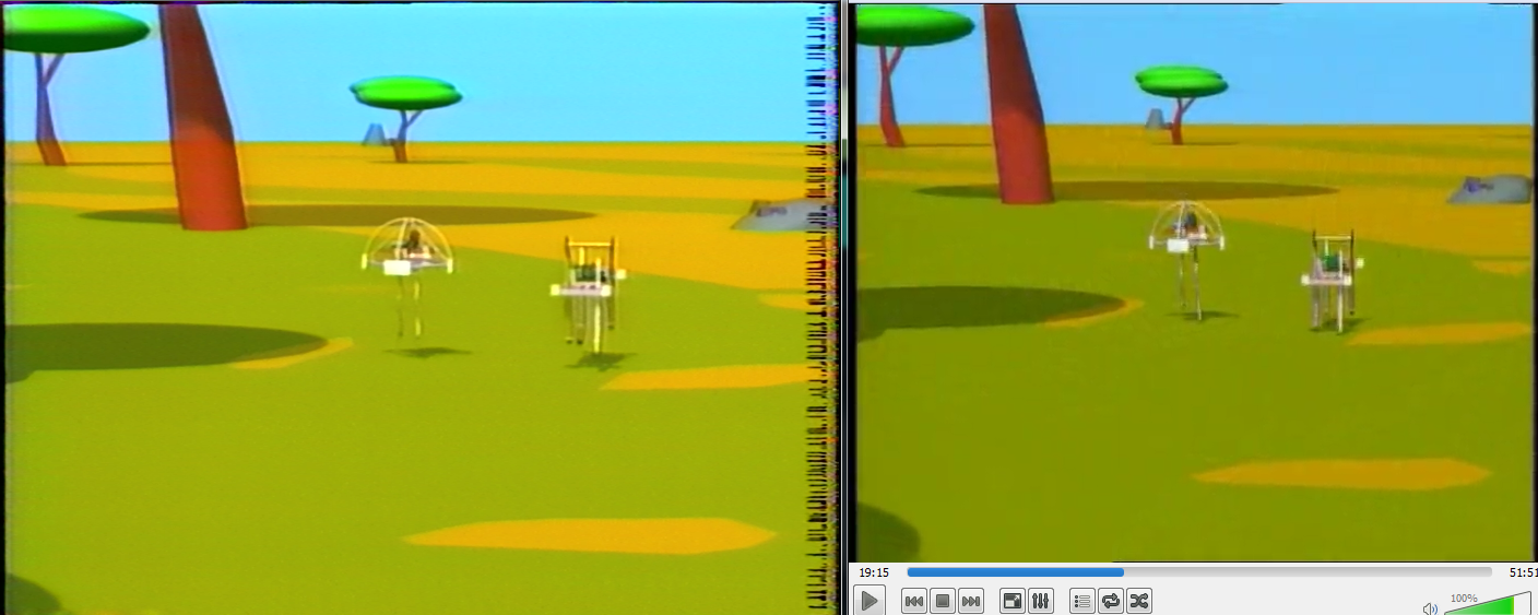

    I tried another method, as mentionned in another site :
    - Opening videos with an AVISynth script with separatefields parameter,
    - Using Deinterlaced Smooth filter,
    but videos suffers from quality issues.
    Name:  Sans Titre 04.png
    I don't know what to do.
    Any help would be greatly appreciated. It's driving me mad !

  2. Upload a sample of your source -- with no filtering or reencoding. But your first video looks like the fields are in the wrong position -- the top field is one scan line below the bottom field rather than one scan line above it. This is a problem with some capture devices and is usually fixed by a swap fields option in the decompression codec or in AviSynth with SwapFields().
  3. Why do you want to deinterlace? If you are going to watch on a TV set, deinterlacing is totally unnecessary.
    Remember that deinterlacing always degrades your video, and that degradation can never be undone. Also, remember that still image captures of interlaced video show the characteristic "teeth" because alternate scan lines come from different points in time, but these "teeth" never show up during video playback, and your eye is completely unaware that they exist.
  4. First of all, thanks to both of you for your answers.
    jagabo
    I uploaded a sample at the following link : https://1fichier.com/?mhweikgtni
    I tried with the SwapFields() parameters and it works. Many thanks for this advice.

  7. You can open the MJPEG AVI with ffVideoSource(). After SwapFields() I would add vInverse() to eliminate some mild horizontal lines where fiels have different brightness. I'd forget using VirtualDub and try a motion compensated grain remover like TemporalDegrain() instead. Consider RemoveSpots() to get rid of a lot of those spots -- unless they're supposed to be there.
    I tried this:
    ffVideoSource("Test_MJPEG24.avi")
    SwapFields()
    ConvertToYV12()
    ColorYUV(cont_y=100, off_y=10, gamma_y=50, cont_u=50, cont_v=50)
    vInverse()
    BilinearResize(400,height)
    TemporalDegrain()
    RemoveSpots()
    MergeChroma(aWarpSharp(depth=5), aWarpSharp(depth=20))
    Sharpen(0.3, 0.0)
    nnedi3_rpow2(2, cshift="Spline36Resize", fwidth=768, fheight=height)
    It still needs work but that's something of a start. Be careful with RemoveSpots(), it can remove real detail too. Especially in panning shots.

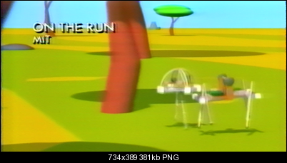

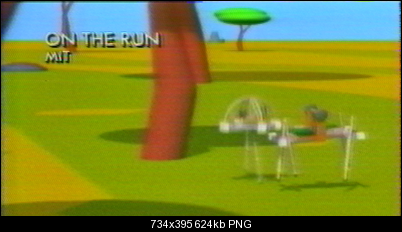

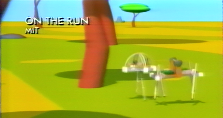

  9. I tried with a sample from a broadcast dedicated to Imagina festival of 1992. Wow.
  10. The reason for the downsize and upsize was to sharpen the video a bit without introducing aliasing artifacts (nnedi3). PAL VHS has an inherent resolution of about 360x576. Also, the bilinear downscale gets a little natural noise reduction and reduces horizontal time base jitter a bit. Applying TemporalDegrain while the video is small makes it run faster. Play around with TD's SAD1, SAD2, and sigma parameters. The defaults are 400, 300, and 16 respectively. Smaller values remove less noise but are also less prone to ghosting when there is motion (especially panning shots). The aWarpSharps sharpen luma lightly and chroma more strongly (VHS has very low chroma resolution) and reduce the time base jitter a little more. I guess you want to remove the RemoveSpots() since you want to keep the spots. ColorYUV was used to increase the contrast, gamma and saturation. I think it's a bit overdone in the new image you posted. You have to tailor that to the particular video.
    If you haven't already, learn to use Histogram() and/or VideoScope() to check levels.

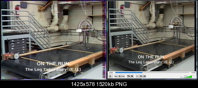

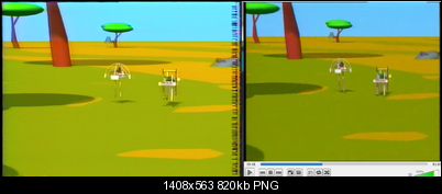

  13. Most of those filters only work with progressive frames. One way to deal with that is to SeparateFields(), filter, then Weave() the fields back together. That isn't optimal because you end up treating scan lines that aren't next to each other as if they were. Another method is to convert fields to frames with QTGMC(), filter, then pull fields out of the frames to weave together: SeparateFields().SelectEvery(4,0,3).Weave().
  14. Hi,
    I found a french broadcast captured by the man who worked on its credits.
    The colors seem to be more natural and accurate.
    So I worked with a sample of my captured VHS and tried to approach them.
    https://1fichier.com/?t1r3c1o3w3
    I kept the script unchanged, except for the ColorYUV line.
    SwapFields()
    ConvertToYV12()
    ColorYUV(cont_y=50, cont_u=25, cont_v=25, off_y=0, off_u=0, off_v=0, gain_y=0, gain_u=5, gain_v=5, gamma_y=50, gamma_u=0, gamma_v=0)
    vInverse()
    TemporalDegrain()
    Sharpen(0.3, 0.0)
    This is the closest I can approach.
    I understood how to work with off_y and gain_y parameters and Histogram() function, to increase ou decrease black and white levels.
    But I don't clearly understand how to work with off, gain and cont parameters, and Histogram(Mode="Levels") by example.
    In this image, wrong colors are clearly noticeable :
    But if I change a parameter, results are worse.
    I was wondering if using Tweak and Levels functions, to increase saturation and levels, are necessary ? It seems that one can only deal with ColorYUV or am I wrong ?
