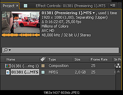

    Does his screenshot help?
    My output settings is currently set at default (uncompressed avi).

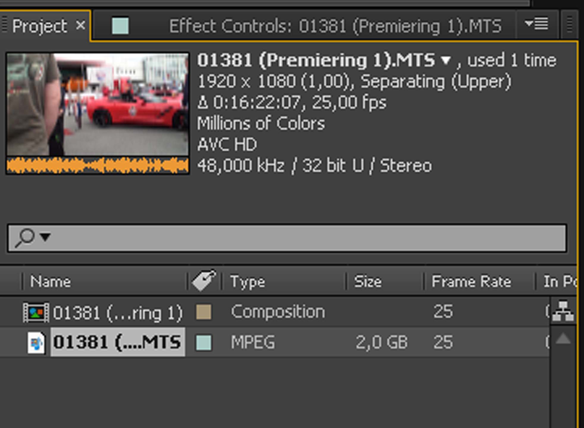

  5. Okay, your project shows that your files are run-of-the-mill AVCHD mts files. 1920x1080 interlaced (indicated by separating upper.) 48000KHz 32bit audio -- probably AAC since it's straight out of the camera.
    Take a look at this tutorial to be sure you know how and why to get your compositions into Adobe Media Encoder. (You can also simply drag your composition from your AE project window into the AME queue.)
    https://helpx.adobe.com/after-effects/how-to/ame-export-compositions-cc.html
    With your material, as a starting point, you should try one of the DVD & Blu-ray presets in Adobe Media Encoder.
    Specifically, start with the HD 1080i 25 H.264 Blu-ray preset.
    In the Audio tab, switch from PCM to Dolby Digital
    In the Multiplexer tab switch from none to TS
    This will give you very good quality at a slightly higher bitrate than your original. As I said, use this as a starting point -- experiment with different parameters from here.

    I tried this and it works wonderfully. Thanks a bunch
