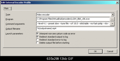

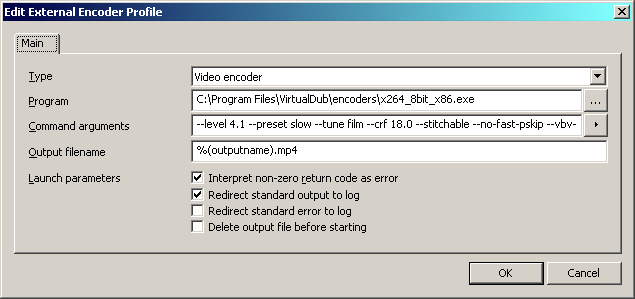

    You don't have to. VirtualDub normally uses video for windows codecs for encoding but newer versions have an "external encoders" feature under the Options menu. That'll allow it to use any command line encoder (video or audio). There, you can slowly drive yourself mad configuring it and trying to get it to work. There's builds of the x264 command line encoder able to write directly to MP4 (the standard builds only write MKV or raw video streams). Attached is an MP4 capable build of x264. I can't remember where I got it and it's a year or so old. Someone else may be able to tell you where to find newer one. Or see what Google has to say about it.
    Here's a command line that works (anything prior to --demuxer are optional x264 settings):
    --level 4.1 --preset slow --tune film --crf 18.0 --stitchable --no-fast-pskip --vbv-bufsize 78125 --vbv-maxrate 62500 --demuxer raw --input-csp i420 --input-res %(width)x%(height) --fps %(fpsnum)/%(fpsden) -o "%(tempvideofile)" -
    Here's what the external encoder configuration window looks like:
    Aside from pointing out you'd use the File/Export menu for encoding, that's about as much as I can help. If you want to output the audio as well, you need to set up an audio encoder and an "encoder set", and a muxer if you don't want to mux the video and audio into a single file manually, although it's possibly easier to do it yourself with something like MP4Box. I virtually (no pun intended) never use VirtualDub for encoding myself so I'm nowhere near an expert. I just configured a few command line video and audio encoders a while back to see if I could get it to work, and in case I needed it one day.
