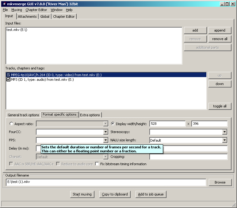

  6. One way to test if the video is variable frame rate.....
    Open one of the MKVs with MKVMergeGUI. In the appropriate section (the GUI has changed and I'm still using the old version so I can't tell you exactly where) specify a frame rate (ie 25fps). Remux that as a new MKV. When you specify a frame rate using MKVMergeGUI it outputs a constant frame rate.
    Open the original MKV with gMKVExtractGUI. Select the video track. Down the bottom, select "timecodes" as the extraction mode and extract. Repeat the process for the new MKV. You can then compare the two timecodes files. Do they seem any different? For a constant 25fps frame rate, the timecodes should be a nice and consistent 40ms apart. Like this:

  8. MediaInfo sometimes shows VFR for Handbrake encodes that are constant frame rate. I can't remember why exactly. Something about the time base used for the frame rate and any rounding of frame durations that might be required. I think. Maybe.... Don't quote me.....
    I've no idea why there's an extra 5ms/10ms duration for the first frame, but I'd imaging it's nothing to stress about. It might be something to do with any audio delay being required (if the original DVD audio used one) and if it's a negative delay an appropriate amount will be removed from the beginning of the audio stream, and maybe, if an exact amount to match the delay can't be removed, there's a bit of fiddling going on to make up the difference. I think normally (and I'm just making up numbers as an example) if the audio delay is -120ms and the closest amount that can be removed is 130ms, it'll be removed and an audio delay of 10ms will be written to make up the difference. Maybe, instead of an audio delay, there's some fiddling with the first frame duration happening instead. That's just an idea. A theory. It's probably complete bullocks. And thinking about it, if it was making up for an audio delay, the frame duration would need to be less, not more. Oh well. It was a thought.....
    Here's where you change the frame rate using the old MKVMergeGUI. I don't know how different the new version is.

  9. Hi,
    With regards to MKVMergeGUI ... to coin the phrase: I'm "blind as bat" (in reality a very poor phrase since bats aren't blind & have similar eyesight to us!!!).
    Re-muxing a MKV file in MKVMerge with FPS:25 specified does the trick. But, as you say, it's probably nothing really to worry about anyway.
