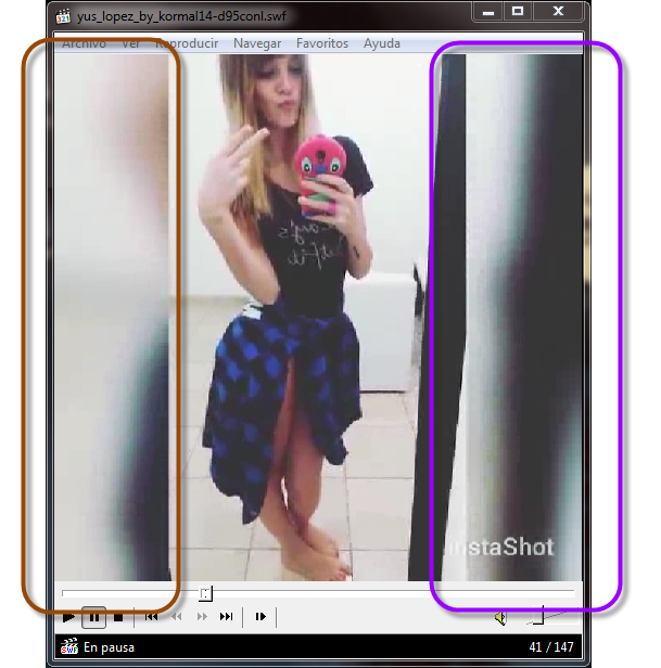

    example :
    in Virtualdub or AviSynth or other free tool
    pliz, this efect:
Name:	12-08-2015 10-24-03 a-m-.png

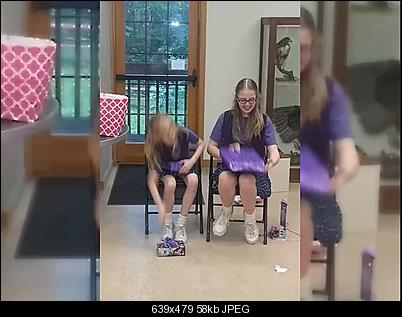

  5. Member Budman1's Avatar
    Jul 2012
    NORTHWEST ILLINOIS, USA
    Works perfectly but I went with stackhorizontal because it was easier than overlay for me. I might have oversized the edges but I went for nice round numbers and it only took about 15 minutes with calculations. In order to make it look right the sides must be a crop from middle areas to show distance from subject.
    Image was 640x480 and left crop was x=160, y=0, w=80, h=480. This was resized and blurred to 160x960 and recropped to x=0, y=240, w=160, h=480 in the same operation as the crop. Similar calculations for right side and then Stackhorizontal
    v1=DirectShowSource(("C:\Users\Bud\Desktop\Temp\bi rthday with audio_Timed_1.flv"), Pixel_Type="yuy2").Crop(0,0,-0,-0)
    v2=DirectShowSource(("C:\Users\Bud\Desktop\Temp\bi rthday with audio_Timed_3.flv"), Pixel_Type="yuy2").Crop(0,0,-0,-0)
    v3=DirectShowSource(("C:\Users\Bud\Desktop\Temp\bi rthday with audio_Timed_5.flv"), Pixel_Type="yuy2").Crop(0,0,-0,-0)
    stackhorizontal(v2, v1, v3)
    The 'Timed' thingy is just something my program throws in by default.
Name:	ScreenHunter_159 Aug. 12 23.54.jpg

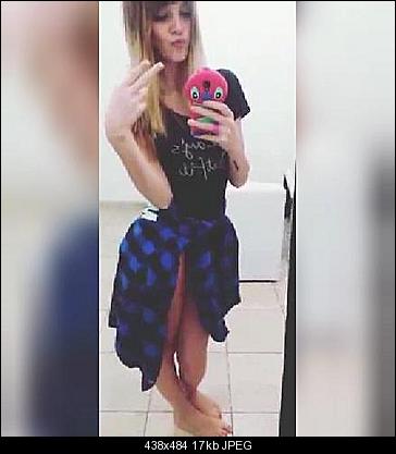

  6. Starting with the png image in the first post, cropping it to use just the center portion as a starting point:
    ImageSource("attachment.png") # get the image, use an appropriate source filter for your video
    fg=Crop(176,50,-214,-82) # remove existing borders, may not be necessary for your video source
    bg=fg.BilinearResize(16,32).BicubicResize(fg.width*2,fg.height*2) # create a blurred background 2x as big
    Overlay(bg, fg, x=bg.width/4, y=bg.height/4) # overlay the image onto the background
    Crop(0, bg.height/4, -0, fg.height) # crop the top and bottom borders

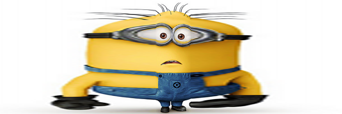

  7. I would never use a warped resize.
  8. Originally Posted by jagabo View Post
    Why?
  9. Originally Posted by pandy View Post
    Why?
    Because it does weird things to your image.
    [Attachment 33143 - Click to enlarge]
  10. Originally Posted by smrpix View Post
    Why?
    I think this is exactly as it should be - nonlinear scaling - use this one as background and overlay on top unresized one...
