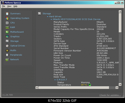

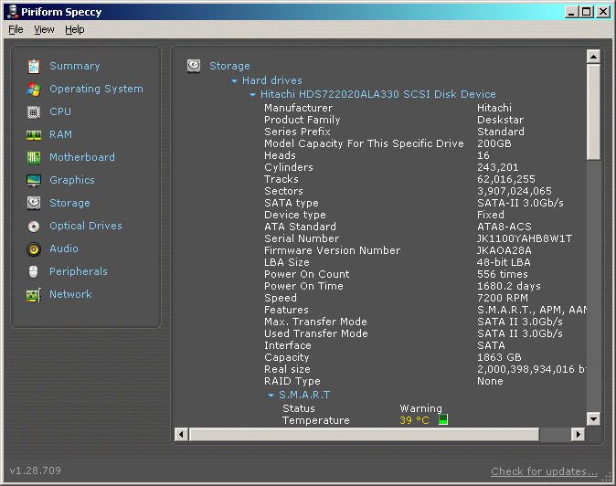

  9. I've got one drive here that's convinced me not to stress about hard drive heat too much, although having said that if it was in a case it'd probably need a fan. It's an early 5 platter, 2TB model. Even though it lives in a dock exposed to the open air and it's currently a cool night it's running at about 40 degrees. Hot summer days push it over 50 degrees. Almost too hot to hold in your hand. Still..... it doesn't seem bothered. The platters have been spinning for over four and a half years now, almost continuously.
