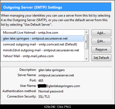

    that's because the email app already knows the host and rest from when you first set it up. verizon has to allow smtp because that's what all email clients use to send your email from your computer to verizon which then forwards it to the addressee.
    if you look hard enough in the settings of outlook you can find the outgoing server settings. the same with gmail thunderbird and the rest.
    here's one from thunderbird.
