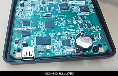

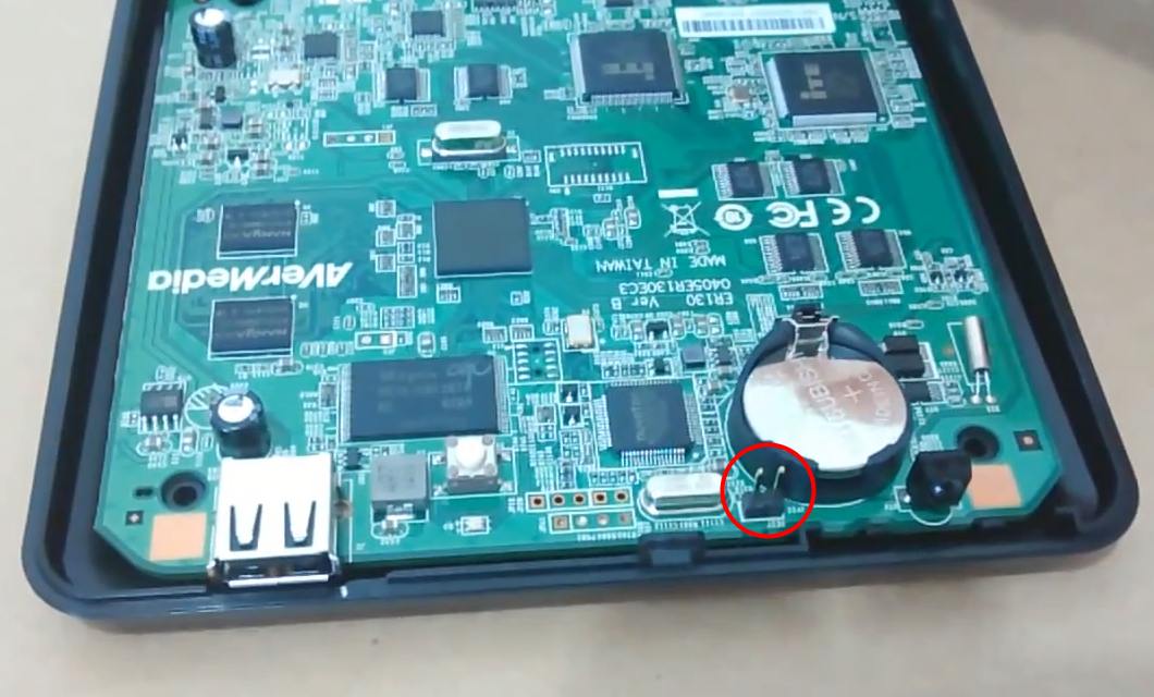

    If you are interested, one of our members posted information in another thread indicating that it's possible to disable HDCP by installing a jumper inside the EzRecorder 130 that connects 2 pins on a header. The only difficulty is that the narration explaining the process is in Portuguese, so its hard to figure out what sort of jumper is needed. https://forum.videohelp.com/threads/374044-Video-Quality-of-AVerMedia-vs-Hauppauge-vs-O...=1#post2410735
    I hope that Claudio can provide the missing information.
  10. In the video it looks like a standard 1/10 inch jumper:
    Compare the spacing of the pins to the open through holes a little to the left -- those are obviously 1/10 inch spacing. And 5 of them are the same width as the USB connector on the left -- 1/2 inch.
    http://www.amazon.com/2-54mm-Standard-Computer-Jumper-100pack/dp/B00N552DWK/
    If you have any old ISA, AGP, PCI, etc. cards sitting around you probably have one already. You can even take the CMOS discharge jumper off a motherboard. Any PC repair shop will probably just give you one. Or if you're brave you can just wind a little bare wire around the pins.

    The video also states that a firmware update (not official) is required after installing the jumper.
    They provide a link to the update (1.0.2) that must be renamed to .bin and installed via USB pendrive.
    There is no information if the new firmware works when removing the jumper.

    On new board EZ130 revisions, the jumpers are out. Not possible enable HDCP remover firmware.
    Claudio
  13. Originally Posted by Cauptain View Post
    Are you saying the new boards no long have the pins? Are the through holes still there? If so, you can solder pins in the holes or just bridge the holes with solder. Will the firmware update work then?
    Yes Jagabo.
    I contacted an owner of a new version of that card and asked him to take a picture and send me. Unanswered so far.
    Claudio
    Aug 2006
    I'm sorry I brought it up as a possible solution for Master Tape, since apparently the hardware part of this exploit was already disabled by AVerMedia before the details of the exploit were posted here. Jumpering pins is one thing. That is very easy to do and easily reversible if necessary. Soldering is harder and not easily reversible.
