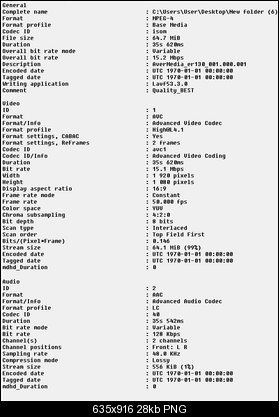

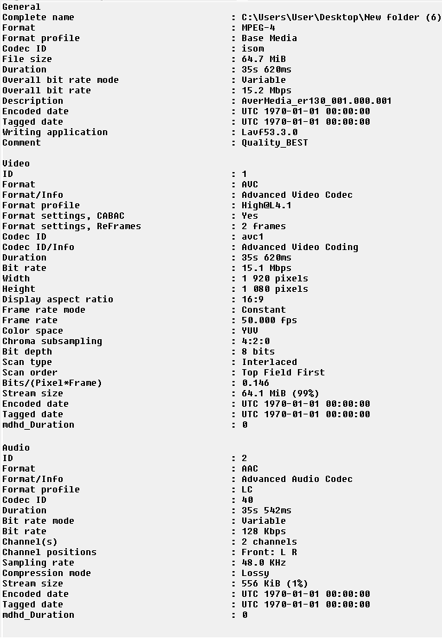

    Having a problem with the Avermedia EzRecorder 130 box. I captured some footage yesterday and deleted it from the V+ box soon after, but thought it looked a bit smooth and soon realised it had been captured as 50 fps. No idea why or how it's doing this, but the footage should be 25 fps. Is there a way to set it to the correct amount on frames on the box, and with the already captured footage, can the number of frames be corrected in a video editing program, by changing it from 50 frames to 25?
    Aug 2006
    Some programs (VLC is one) erroneously report twice the actual number of frames per second for interlaced video. Also, sometimes the notation 1080i50 is used, which counts the number of fields per second. There are two fields per frame, so the frames per second works out to 25.
    Download the zip file containing latest MediaInfo portable from the direct link on MediaInfo's page in VideoHelp's tools section. Note that if you use the installer version from the author's website instead, you must be careful to avoid installing adware and toolbars too.
    Post the MediaInfo report for this capture, which will provide more accurate information. Open the file with MediaInfo. Select View->Text. Cut and paste from the resulting report.
    Aug 2013
    Scotland
    Thanks. Here is a screenshot of the report.
  22. Some programs/devices are starting to flag interlaced mp4 files with the field rate, not the frame rate. But if you examine the timestamps of the frames you'll find that the true frame rate is half the number MediaInfo reports. You can use ffprobe (comes with ffmpeg) to display frame properties:
    "C:\Program Files\ffmpeg\bin\ffprobe.exe" -threads %NUMBER_OF_PROCESSORS%*1.5  -v quiet -pretty -print_format json -show_entries "frame=coded_picture_number,pkt_pts_time,width,height" -select_streams v:0 %1 > %1.json
    Here's what ffprobe shows for a similar MP4 file from a Sanyo HD1000GX camcorder:
        "frames": [
                "pkt_pts_time": "0:00:00.000000",
                "width": 1920,
                "height": 1080,
                "coded_picture_number": 0
                "pkt_pts_time": "0:00:00.033367",
                "width": 1920,
                "height": 1080,
                "coded_picture_number": 1
                "pkt_pts_time": "0:00:00.066733",
                "width": 1920,
                "height": 1080,
                "coded_picture_number": 2
                "pkt_pts_time": "0:00:01.001000",
                "width": 1920,
                "height": 1080,
                "coded_picture_number": 30
                "pkt_pts_time": "0:00:37.437400",
                "width": 1920,
                "height": 1080,
                "coded_picture_number": 1122
    Note that the timestamps increase at 33.367 ms per frame. One second is reached at frame 30. The entire 37.44 second video has 1122 frames. Ie, the video is 29.97 fps. MediaInfo shows this file as 59.94 fps interlaced.
  23. Member
    Aug 2006
    Thanks for the explanation jagabo. I have never encountered this situation before.
    To actually capture 50 interlaced frames per second from a 1080i 25 fps source, the AVerMedia EzRecorder 130 would have to duplicate each interlaced frame, which would serve no purpose.
  24. A lot of players will attempt to play the video at 50 fps, displaying each frame twice. When bob deinterlacing they will output 100 fields per second. But since interlaced frames were duplicated before bobbing you get very fast back-and-forth motion. Ie, instead of fields being played back in order, 1, 2, 3, 4... at 50 fields per second you get 1, 2, 1, 2, 3, 4, 3, 4... at 100 fields per second. That's fast enough that it just looks blurry and flickery. And most players can't bob to 100 fps (or 120 fps for NTSC) so you get jerky playback as frames are skipped in an attempt to keep the running time.
    This confusion comes about because marketing people renamed 25i to 50i (and 30i to 60i) just because it sounds better. Then, probably because users started complaining that their "50i" camcorder produced files that MediaInfo (and other programs) reported as 25i, they started marking the actual video files 50i.
  25. Member
    Aug 2006
    I'm probably the only member here who never uses MP4. LOL Do you know of a way to correct the flag to show 25 frames per second? This question may come up again. In fact it has already come up here.
  26. Member
    Aug 2013
    Scotland
    Thanks for the info, so despite what codec information from several sources state, it's always been in it's original 25fps. So am i alright to continue capturing from my V+ box? I would assume i can deinterlace then encode at 1080p/25fps for Youtube videos, and leave the interlaced footage as is, for future viewing on my tv.
  27. Member
    Aug 2006
    You don't have much of a choice at this late date but to go ahead and capture with the device you already have. I'm hoping jagabo might come back with a way to correctly flag your captured video as 25 frames per second to ensure it will be processed correctly.
    The question is can your preferred video players and encoding software handle your captures when they are flagged with the wrong frame rate? Based on what jagabo wrote, it is possible some players and encoding software might be confused by video that is flagged as 50 frames per second even though it is really 25 frames per second. Assuming your encoder can handle your captures, YouTube allows uploading 1080p50 now, if you would like to re-encode your video that way.
  28. When using such a source in AviSynth I override the frame rate with
    ffVideoSource("filename.mp4", fpsnum=25000, fpsden=1000)  # or 30000, 1001 for NTSC
    You may also have to specify AssumeTFF() or AssumeBFF().
    I've used My MP4Box GUI to demux the audio and video streams, then remux them with the frame rate set to 29.97 fps. That works for most players. Some may still get the field order backwards. I haven't found an mp4 header editor that lets you change the flagged frame rate.
  29. Member
    Aug 2006
    Just to avoid any possibility of confusion, in Master Tape's case he would set the frame rate to 25 fps when remultiplexing with my MP4Box GUI.

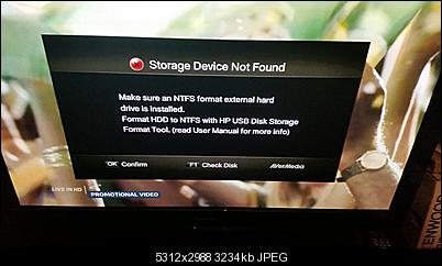

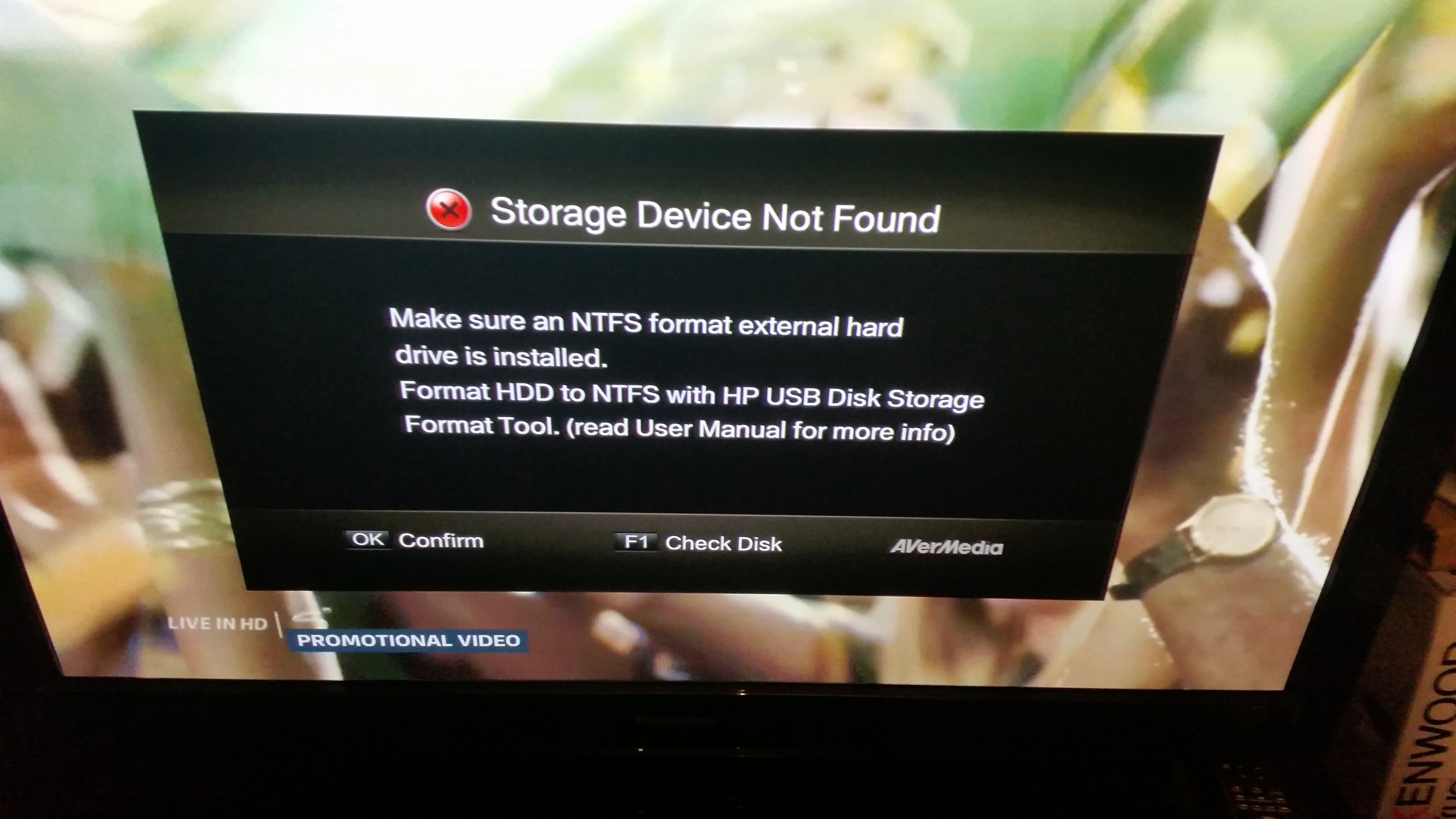

    Was working fine before, but i now keep getting this error.
