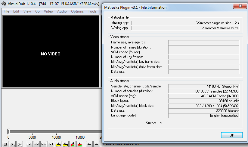

    I use a free onscreen recorder which saves the recorded video by default in mkv container with MPEG-4 visual video and AC3 audio formats.
    I tried to open the video in VirtualDub to edit the video, but it does not show up. What plugin do I install in virtualdub? I would appreciate for any help by giving the link too.

    Originally Posted by sum_guy View Post
    I have downloaded the directshow plugin from the above link and put it into plugins32 folder. Eventhen it does not open the video.

  4. You need an MPEG 4 Part 2 decoder like Xvid, Divx, or ffmpeg.
    There may be another problem: The video is encoded with an odd frame height, 351 lines. Most decoders will not like that. Some decoders won't like the mod2 frame width either (566 columns).

    Delete the DirectShow plugin and put the latest ffmpeg input driver in there instead. Now drag and drop your video into Virtualdub.
    http://forums.virtualdub.org/index.php?act=ST&f=7&t=20025&

    Mar 2011
    India
    I have put the latest ffmpeg static plugin into plugins32 folder. However, the video didn't open. When I changed the 'Files of type" to 'FFMpeg supported files' in the files open window, it finally showed up and I could do further processing. I could even open an odd frame sized video too. Thank you.

  7. Originally Posted by shans View Post
    When there are multiple plugins that can open a file type VirtualDub picks the first one it encounters. So if you didn't delete the DirectShow plugin, or if you had some other plugin that can open the container, it picked one of those instead.

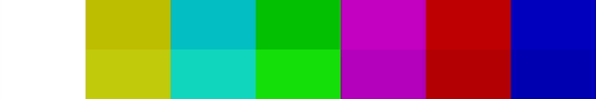

  9. Well further to my post above, I've done some experiments to try and quantify what actually happens - color display wise - when opening my .MTS files in Virtualdub, wiith the ffMpeg input driver installed.
    I created a color bar video clip using the generator on my camcorder. Playing that back using WMP or MPC-HC shows the camera color bar generator has created bars with a 75% SMPTE value (RGB values of c.191)
    If I open the same raw .MTS file from within Vdub, it displays the color bars with 100% values in the Vdub window.
    The video clip itself reports a 'YUV 420' color space. The list of Vdub color depth decompression formats does not include that option. Using the most obvious candidate from their list -( 4:2:2 YCbCr (YUY2)) - generates an HQX or Cineform file with the same 75% values, so that would seem to be the best option.
    Using their 24bit RGB (888) option generates an HQX file with 100% values -- the same as the original MTS file when displayed in the Vdub window.

  10. First try using Video -> Fast Recompress Mode. That will pass decompressed frames of the source directly to the output codec.
    VirtualDub almost always displays videos with the standard rec.601 matrix. HD camcorders normally use rec.709. But DSLRs often use PC.601. Upload a short sample of your color bars video.

    Attached is a 'raw' sample of my color bar clip. As I say, its from my Panasonic SD5, so it's interlaced - and it's PAL. (Don't think that makes any difference here though?...)
  12. The color bars use rec.709. If you use Fast Recompress mode there will be no conversion to RGB so you should get the correct colors in the output file. If the codec has some way of flagging the matrix set it to rec.709 (aka bt.709). VirtualDub may or may not display the correct colors depending on how it's set up. The RGB components should be either 192 or 0 (rounding errors when converting YUV to RGB will result in plus or minus one unit deviation) except for the white bar which should be 255. Here's what the colors should look like on the top, and the incorrect rec.601 interpretation on the bottom:

    Some more info on color matrices:
    https://forum.videohelp.com/threads/329866-incorrect-collor-display-in-video-playback?p...=1#post2045481
    https://forum.videohelp.com/threads/329866-incorrect-collor-display-in-video-playback?p...=1#post2045830

  14. Be careful, VirtualDub does not handle the chroma channels of interlaced YV12 (YUV 4:2:0) video correctly. It will blur colors of the two fields together. This will be noticeable when colored objects move quickly.
  15. So if I did want to de-interlace within Vdub, I would be better to convert to RGB and de-interlace in that color space, and then convert back to YUV 4:2:0 in my final x.264 output conversion?.....
  16. Yes, or YUY2. But the best deinterlacer by far is QTGMC() in AviSynth.
