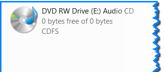

  7. Thanks for feed back How is is that when viewed in my computer the cd looks empty, there is no zero bytes free of zero bytes

  8. Member hech54's Avatar
    Jul 2001
    Yank in Europe
    It has zero bytes FREE meaning you cannot burn/add anything to it.
  9. Originally Posted by hech54 View Post
    Ok how do you know how big the cd is then?

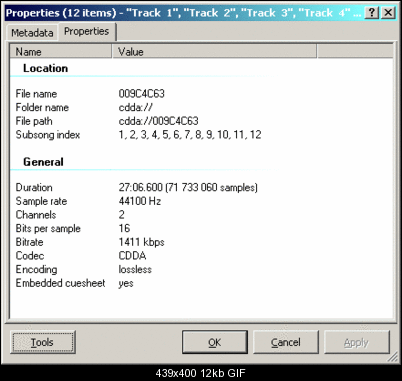

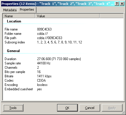

    Depending on the software you're using, you might be able to get the total playing time, and you could work it out from there. 80mins would be the maximum (officially 74minutes, but I think 80min CDs are somewhat common now). This is foobar2000 showing the properties for all the tracks of a CD loaded into a playlist.
