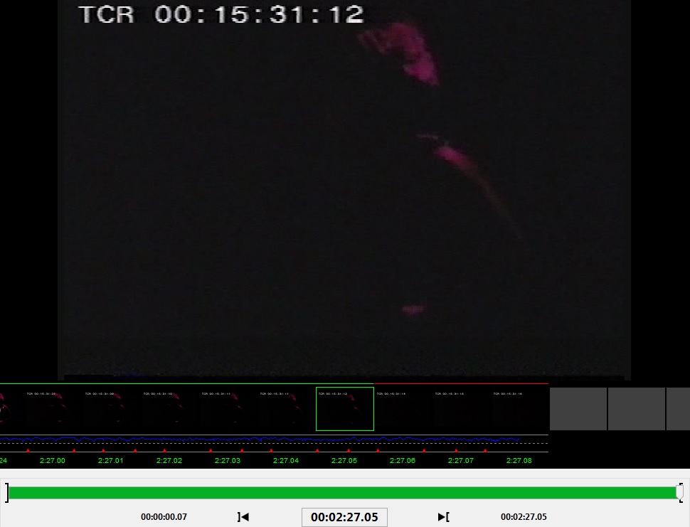

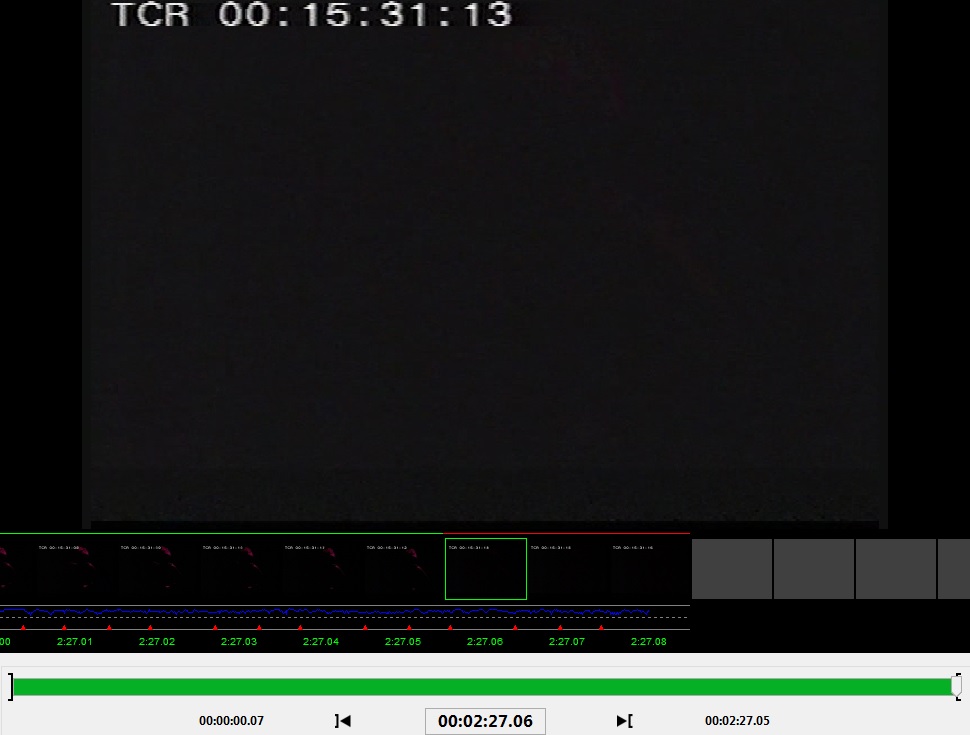

    OK here's the samples and info.
    In VideoRedo the only setting I changed since downloading the trial is in Edit-Options I have selected "Scene Mode" as I believe that saves the first frame to last frame you select/highlight.
    My original uncut VOB is 3684 frames, I can see in VideoRedo there are 7 frames before the first frame I highlight to keep and 3 frames after the last frame I highlight to keep, the output m2v I make is 3674 frames so that indicates only the selection I make is kept.
    The first screenshot I have posted is the original file loaded into VideoRedo before I've edited it, you can see the last frame I've highlighted to keep is 2min27secs5frames into the file (and you can see the clock/timer in the actual video footage from my DVD is 15min31secs.12frames, this is the last frame I highlight in videoRedo as it's the last frame you can see any picture of the person in the footage, if I progress by highlighting the next frame 2min27secs6frames you can see the screen is black and the clock/timer in the actual video footage has also progressed 1 frame to 15mins31secs.13frames, but I don't want to keep that frame as you can see the persons image has faded out and the video is just black now.
    Once I have cut/smart rendered and output an m2v if I load that output m2v into VideoRedo it shows the first and last frame are indeed the ones I selected to keep, eg. in the last frame you can see the clock/timer in the actual video is at 15mins31.secs12frames which is the same frame/image shown in my last frame to keep selection before I made the cut.

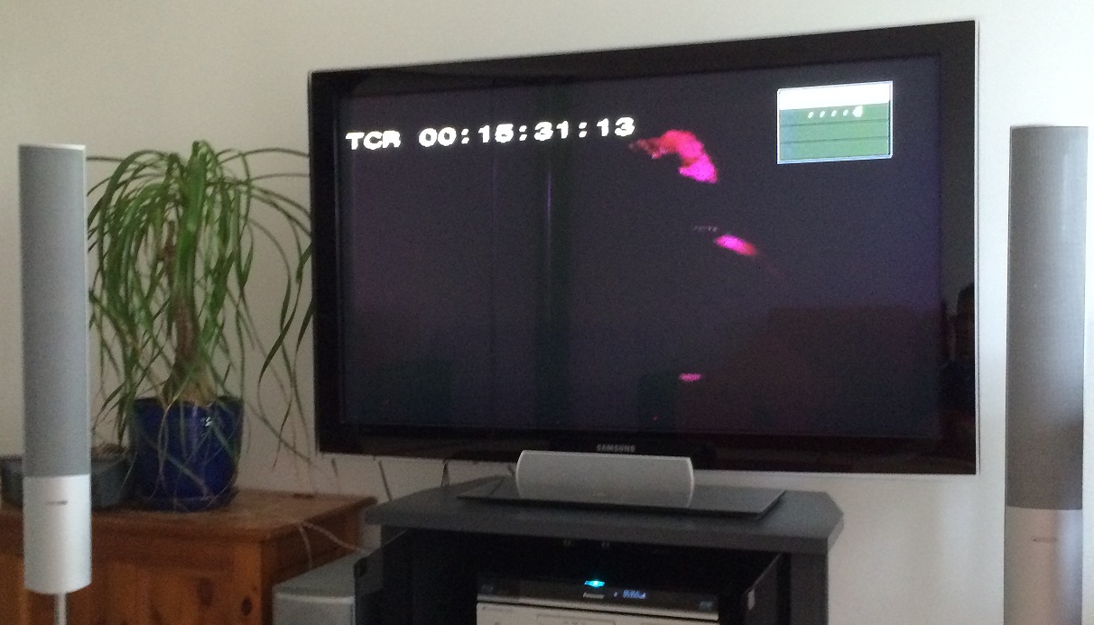

    So I muxed all my m2v's and audio together and burned a dual layer DVD.
    When I played the DVD in my Bluray player and got to the end of that piece of footage, I hit pause, then rewind, I think it rewinds frame by frame as I see that counter clock in the actual video footage count consecutive frames, in forward slow motion the last frame I see is 12 (the one which I selected as last frame to keep), however in rewind slow motion you actually see the counter/clock in the video footage at 15mins31secs13frames, how did this happen when the last frame I selected to keep was showing frame 12 not 13?, it's also odd to note that you can also see the image of the person with the clock which is in the actual video at the top left of the screen showing frame 13, even though when you see frame 13 in VideoRedo it's the first black frame after the persons image has faded out.
    I guess I have misunderstood something, as I thought the single frames you see when you select them in VideoRedo are all the frame consists of, but I guess there's more 'image' in the single frame than VideoRedo actually shows in the still picture?

  14. It's probably because of frames vs. fields mentioned eariler
    The scene change is right where the first field of that frame belongs to the previous scene, but the next field belongs to the next scene (black)
    Because when you single rate deinterlace, you throw out the 2nd field (ie. you are only looking at the 1st field in the preview, the 2nd field isn't visible, but it's still there in the stream - you just can't see it in the preview)
    However - On the TV, it gets bob deinterlaced (double rate deinterlaced) - so essentially every field becomes a frame, thus you see everything
    It's impossible to cut only on a field (you can only cut on frames).
    (BTW , this is poor editing technique - a "faux pas" in the editing world, or lazy editors do this sort of thing - you should edit it so everything is on frame boundaries. Similar "problems" occur with interlaced fades and interrupted telecine cadences)
