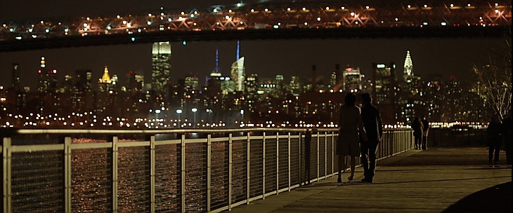

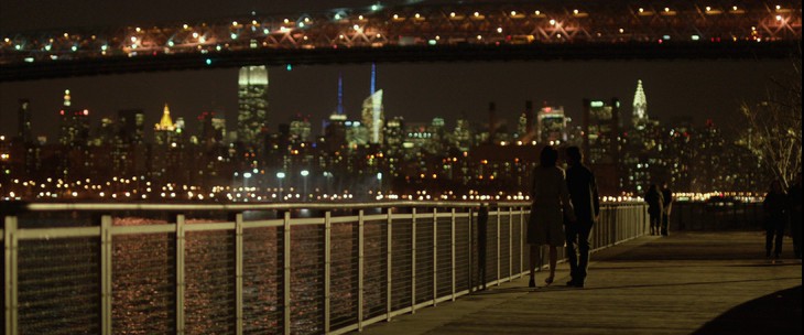

    Here is an example:
    A frame resized using Irfanview
    The same frame resized using Avidemux with swsresize filter
    The question is: is there a (quite easy) way to have an alternate filter that can reduce an image without smoothing it?

    Your video appears to be 2.4:1 image ratio (wide Panavision). You can't completely fill a 16:9 frame with an image that's wider than the frame, without distorting the image in some way.
    The video above is only a sample to demonstrate the smoothing introduced by the swsresize filter. I mentioned the anamorphic and the letterbox only as a workaround to avoid resizing. I haven't opened this thread to talk about aspect ratios; the problem is the smoothing.

  9. Originally Posted by Marco Bux View Post
    Here is an example:
    The first image is way over sharpened. It's full of over sharpening halos, has blown out brights, and will be full of buzzing edges when viewed in motion.

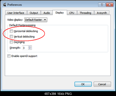

  17. Thanks to everybody for the contributions and suggestions. I found more than some post of people complaining about similar problems. Someone of them suggest to turn off Horizontal Deblocking and Vertical Deblocking, that in Avidemux are turned on by default. I'm doing some test right now. I'll update this thread as soon as I'll have some news.
  18. Disabling deblocking won't help with your "blurry" downscales. You'll just end up with more blocky artifacts.

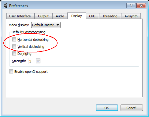

  19. Unfortunately I obtained exactly the same results.
    I think these settings were already disabled...
  20. You typically want to use deblocking with MPEG 2 and Divx/Xvid sources.
