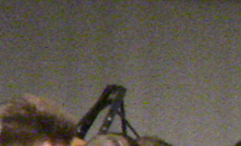

  3. Thanks. The main noise I am dealing with is due to low light when filming concert hall performances. I don't have the best camcorder and the lighting is very poor. Spotlights on the performers causes over exposure of their faces while the background and everything else is super dark. Here is a very small sample of what I am talking about that shows how the background is super noisy. I don't know what kind of noise this is called and what the best tool is to reduce it. This is 1920x1080p30 video. Thanks.

    The type of clumpy noise that's in the posted image is really tough to remove -- not just for NeatVideo, dfttst ,MvDegrain, or any other filter. Only part of it is "grain". Much of it is chroma grunge that's the residual noise level of the camera and its circuits --a noise level that was either equal to or stronger than the signal that was being recorded. NeatVideo can remove some of it, especially the pixels that move. But examine your noisy low-signal film carefully: you'll find that most of the time the noise doesn't move, or it moves very slowly, and the more of it you remove the more you see that what remains is an almost stagnant pattern that follows the camera's motion.
    Even if you could discard 100% of that stuff, you'd have very little image left -- because the noise and the details in some of the objects are one and the same pixel or clump of pixels. What's often done with this kind of noise is to apply moderate doses of two or three denoisers -- NeatVideo being one possibility. Not specific "degrainers", but grain and chroma cleaners like dfttest, fftd3d, TemporalDeGrain, QTGMC, or others. Then run a gradient smoother or unblocker that adds fine grain and dithering to the result. If you don't cover the gaps that were formerly defined by noise removed, you'll have an oddball denuded video with funky edge noise every time something moves. What you would be doing, then, is removing the worst of the noisy crapf and replacing part of it with better controlled, fine-textured, less obvious noise.
    Most people try to use NeatVideo as their only video cleaner. That's a mistake. There is no filter that cleans everything. In the image posted, grain isn't the only noise problem in that video.
