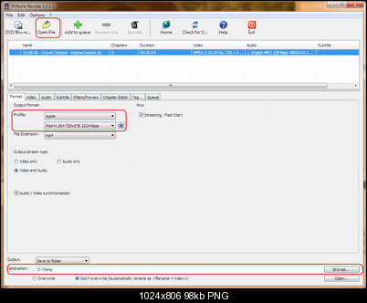

    I had huge sync problems hardcode subtitles from a DVB video source with the easy to use VidCoder but it works perfect with Xmedia Recode. You can also adjust subtitle colors with Xmedia Recode.
    Software required:
    Xmedia Recode

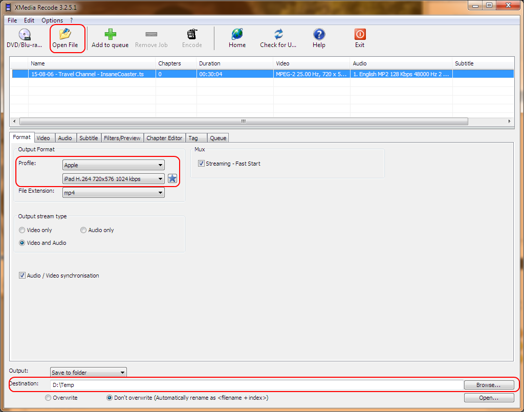

    Open your video. My video source is a .ts file with srt subtitles extracted using ccextractor.
    Select Profile . I use the Apple - Ipad H264 as it will work on many devices.
    Set the Destination folder.

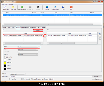

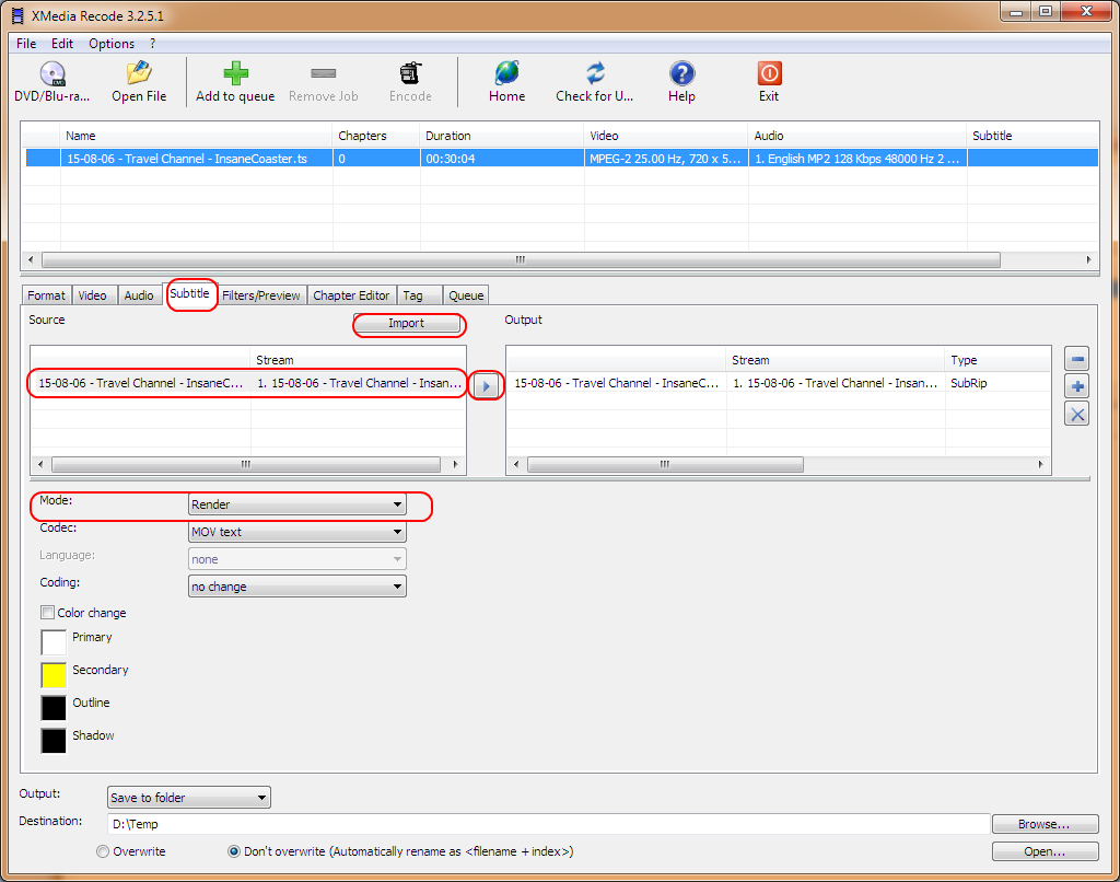

    Under the Subtitle tab Import the srt subtitle.
    Select the stream.
    Under Mode select Render. (Adjust the colors if you like)
    Click on the arrow to add the subtitle track.

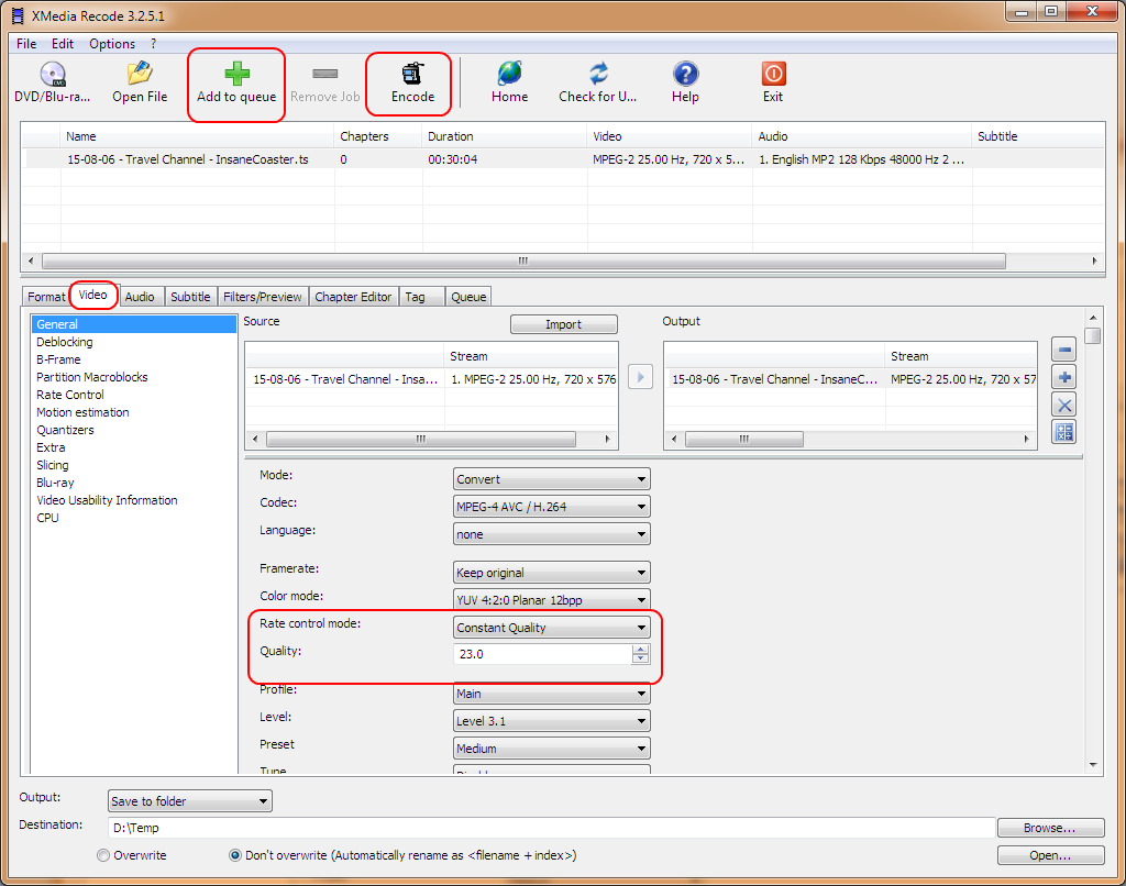

    Under the Video tab I usually change the Rate control mode to Constant Quality around 20-25. Higher value smaller file size but lower quality. Don't use Constant Quality value 0 as it will crash Xmedia Recode.
    Add the video to Queue.
    Encode.

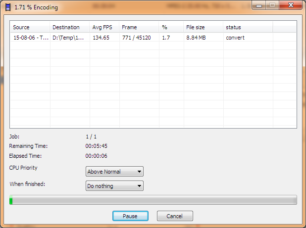

    Wait.

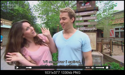

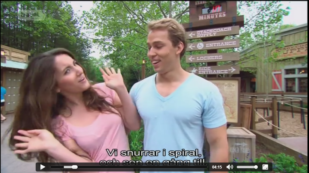

    Play!

  2. I keep trying this but it's just not working for me. I don't know what I'm doing wrong. I just keep getting a message that says an error occurred when converting, but no clue as to what the error is.
    EDIT: I figured it out. I was trying to set the Rate control mode to Constant Quality at 0 for the highest possible quality. That was the problem. 0 doesn't work. The minimum you can set it to is 1.
    Adding it to the guide.
  4. Originally Posted by Baldrick View Post
    Through further experimentation, it seems you can set it to 0 if Profile is set to High 4:4:4.
