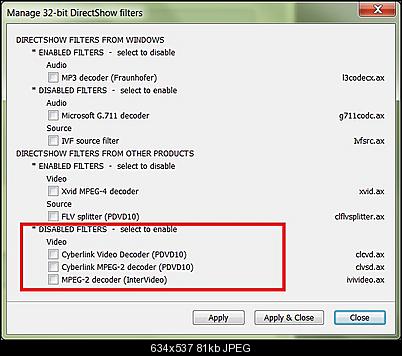

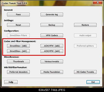

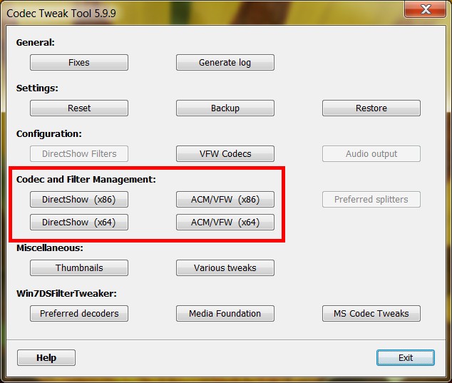

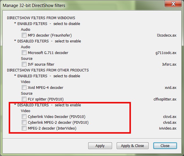

  11. First try disable ALL codecs and filters with lastest version CodecTweakTool in this section, but remember what was enabled:
    don't enable codecs if you have already disabled from the list, remember what was disabled:
    now try select in VirtualDub video -> compression...
    still closed?

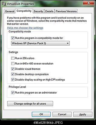

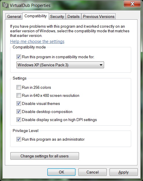

  15. Originally Posted by roma_turok View Post
    Did you try run in compatibility mode selected?
    Yes, different compatibility modes, as administrator, in Safe Mode. Nothing works
