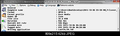

    threehappypenguins, are you looking to just change the Recorded date? Not the created,modified accessed dates from Windows right?
    If so I have a small program that will do it for you. The link above was incorrect and has been updated now but the correct link is:
    https://files.secureserver.net/0sE1d56pH8vH3j
    This version has the created -> Recorded feature

    Great... Hope I got all the bugs out of it. LOL The Rename? check box should add the date and time to the prefix of the file name. In my example it would be something like '2011-11-11 17-11-11_1N.FLV'. If you open the created Crt2Enc.bat file in the program folder, you can see the actual ffmpeg script it uses for that. It is something like this ( if rename checked) for my example:

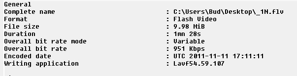

    ffmpeg -y -i "C:\Users\Bud\Desktop\1N.flv" -c copy -map 0 -metadata creation_time="2011-11-11 11-11-11" "C:\Users\Bud\Desktop\3011-11-11 11-11-11_1N.flv"

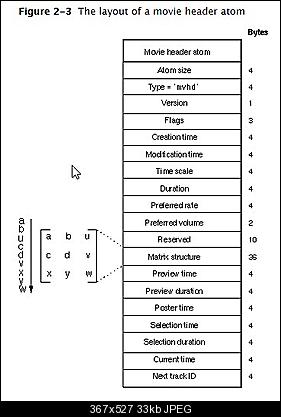

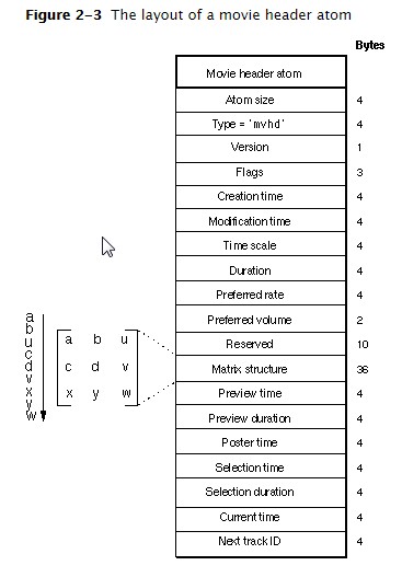

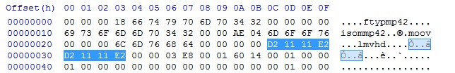

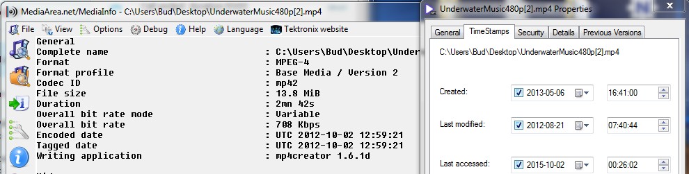

    I couldn't resist for those who really want to get into the nuts and bolts of an MP4 or need to program it instead of calling the external utility Media Info... The dates are stored multiple places but the main one is in the 'mvhd' atom of an MP4. Just open it in a hex editor like HxD and search for mvhd. The bytes are as follows:
Name:	ScreenHunter_166 Sep. 27 21.35.jpg
    Upon searching for mvhd you will find (example):
Name:	ScreenHunter_166 Sep. 27 21.37.jpg
    The 32 bit hex bytes 'D21111E2' is the number of seconds from midnight Jan 1 1804. The manual says 1904 but good luck with that. If you can program or would like to, this becomes decimal 3,524,334,050. Using code such as:
    Dim i = Convert.ToInt64("d21111e2", 16)
    Dim b As Decimal = i / 31536000
    Dim yrs As Integer = Fix(b)
    Dim dysoff As Integer = Fix(yrs / 4)
    i = i - (dysoff * 86400)
    b = i / 31536000
    yrs = Fix(b)
    Dim d As Decimal = b - yrs
    Dim f As Decimal = d * 31536000
    b = f / 86400
    Dim days As Integer = Fix(b)
    d = b - days
    f = d * 86400
    b = f / 3600
    Dim hrs As Integer = Fix(b)
    d = b - hrs
    f = d * 3600
    b = f / 60
    Dim mins As Integer = Fix(b)
    d = b - mins
    f = d * 60
    Dim secs As Integer = f
    This becomes 2015-10-02 21:40:50
    subtracting the number of leap years which add a day (111 yrs/4 = 27days) gives:
    2015-09-05 21:40:50

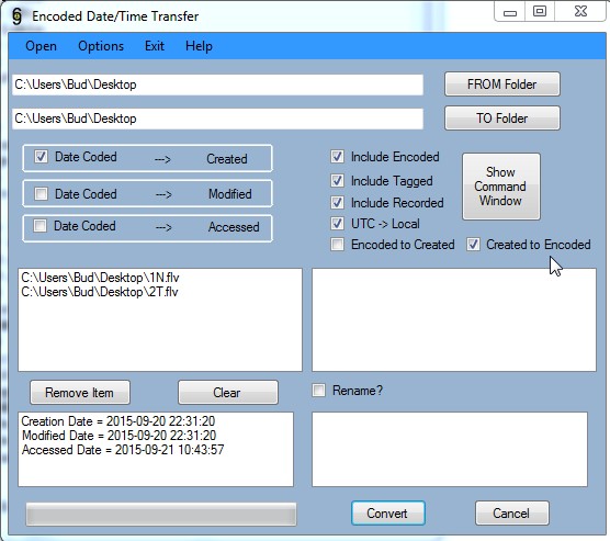

  18. Member Budman1's Avatar
    Jul 2012
    NORTHWEST ILLINOIS, USA

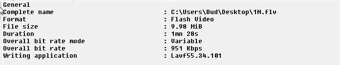

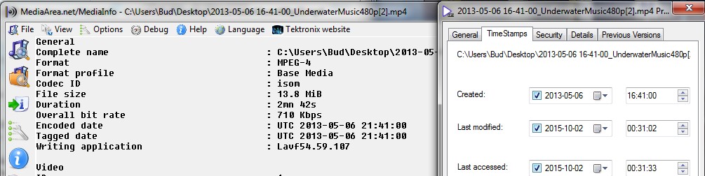

    Okay it works here and all you should need is the Created -> Encoded checked and the rename if you want that added. The other check boxes aren't used for that process. The program just reads from the created date and sets the Encoded date (and Tagged Date if it was originally there.
    THE ORIGINAL FILE WILL NOT CHANGE
    ORIGINAL MP4 Stats:
    CONVERT HERE:
Name:	ScreenHunter_166 Oct. 02 00.34.jpg
    AFTER CREATING NEW FILE WITH UNDERSCORE OR DATE IS FRONT OF ORIGINAL NAME:

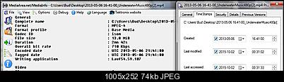

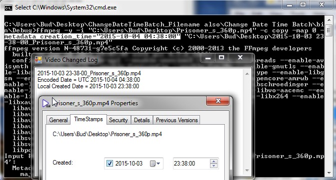

    BEAR IN MIND THE ENCODED IS ALMOST ALWAYS UTC and the created is usually local:
Name:	ScreenHunter_166 Oct. 02 00.36.jpg

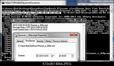

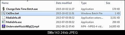

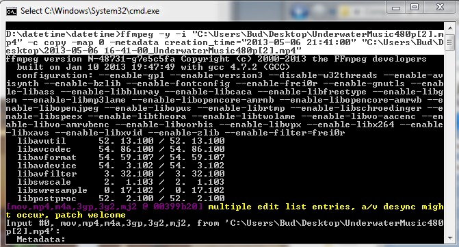

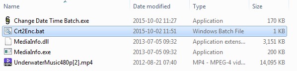

    Puzzling... There should be a file called "crt2enc.bat" being created during process in the programs folder. You might want to do an edit on it and see what the metadata is set to in there. It should be something like
    ffmpeg -y -i "D:\datetime\UnderwaterMusic480p[2].mp4" -c copy -map 0 -metadata creation_time="2013-05-06 21:41:00" "D:\datetime\2013-05-06 16-41-00_UnderwaterMusic480p[2].mp4"
    I have also uploaded a separate program that will allow the CMD window to remain open so you can see what is actually happening during FFMpeg portion. It is at https://files.secureserver.net/0sYxbHFr3A7U5t
Name:	ScreenHunter_167 Oct. 02 11.52.jpg
ID:	33912Click image for larger version
Name:	ScreenHunter_167 Oct. 02 11.51.jpg
    It may be that I am killing the CMD window too soon if your "D:" drive is like a slow USB... Possible.
    Otherwise try moving program folder and From/To folder to the C: drive and try. If that works I can alter the program.
    Let me know if you see any changes.
    Budman1

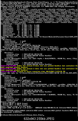

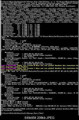

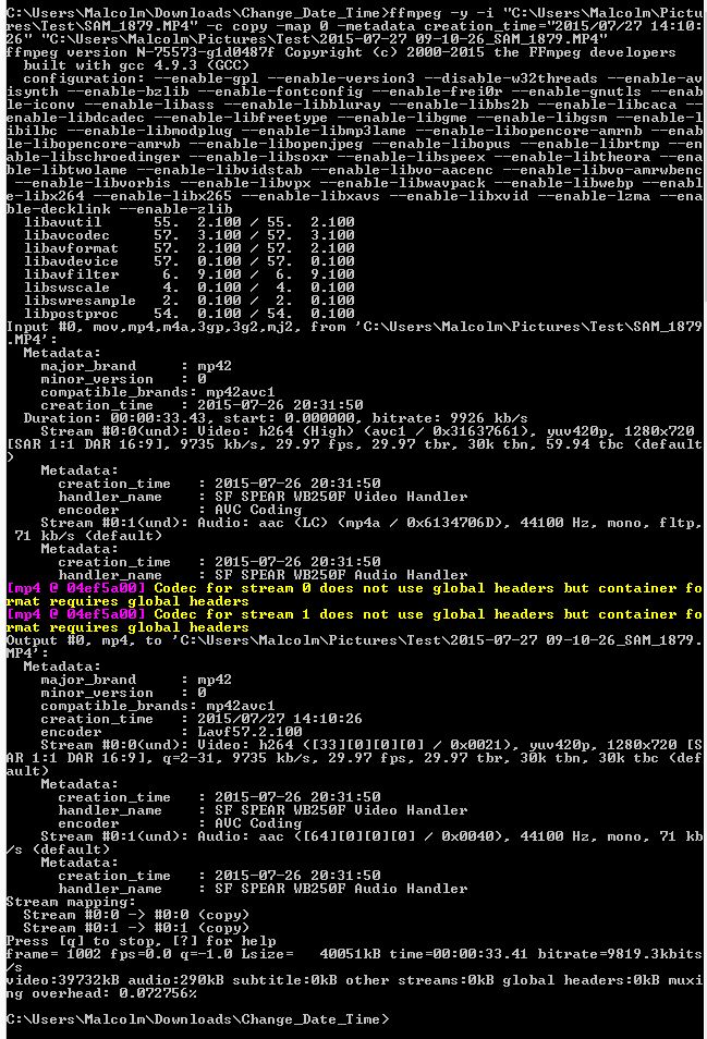

  21. So, I guess I didn't realize I already needed to have ffmpeg...I downloaded it and put the .exe in the same directory as your program, and now it's doing something...but it seems to be wiping out the Encoded Date field in the header/metadata.

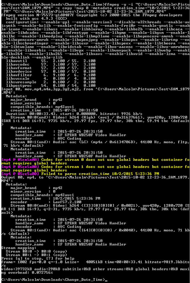

    Okay it looks like the creation date was rejected in yellow on your last try because, apparently, FFMpeg is fussier that Visual studio and wants the Year first in the Metadata. I think I fixed that by using another variable in my programs that should allow people who do not use Military time, as I do, on their computers to use this now.
    The new version I uploaded has 2 versions to leave the CMD open for test and one that closes it after enough time to actually copy the file so it can continue with the next one in batch mode. I also included FFMpeg from http://ffmpeg.zeranoe.com/builds/ with permission since I do not compile it into my program. So everything should be in one folder now.
    The new link is: https://files.secureserver.net/0sE1d56pH8vH3j
    Any changes in the future I will add below and change this link to conserve space on this thread.
    UPDATE:
    Fixed FFMPEG -metadata format from YYYY/MM/DD HH:MM:SS to correct YYYY-MM-DD HH:MM:SS

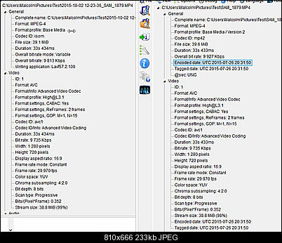

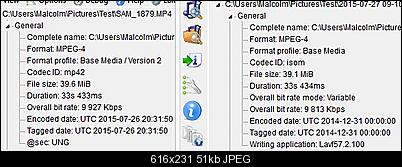

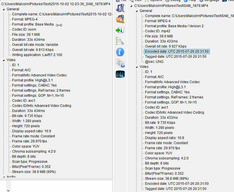

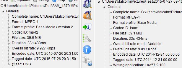

  24. Thanks for the new version and for checking in. It set the dates to midnight on 12/31/14 (see below).

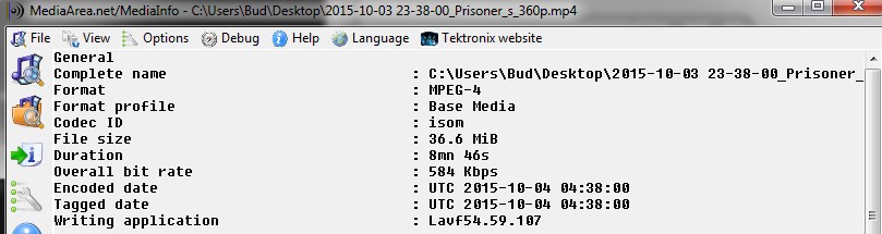

  29. FYI, a few notes/updates:
    • FYI, you're adding an underscore "_" to the beginning of the file names even when the "Rename" box is not checked
    • Google treats the Encoded UTC time as your local time, so it needs to match your local time (i.e. Created Date in local time needs to display the same numbers as Encoded Date UTC time)
    • It seems your program takes local time, converts to UTC, then writes that to Encoded date, so there's a difference between Created Date and displayed Encoded Date that Google interprets (so your album sorted by date will display videos XX hours later/earlier than pictures taken at same time)
    • To make everything jive, I had to shift the created date back by 5 hrs (UTC to CDT difference), run your program, then shift the created date forward 5 hours and remove the underscores (I used Flexible Renamer to do all of the time and file name manipulation)
    • Maybe your checkbox for "UTC --> Local" could cover this?
    • In reality, it's Google's fault...they take the raw time + your configured time zone (vs reading the time + time zone and converting to your configured time zone).
  30. Member Budman1's Avatar
    Jul 2012
    Yes I am and it is for a good reason unless someone tries the program and has no problems and doesn't mind making a possible mistake:
    Yes, That was to protect anyone making the From and To folders the same with their one of a kind videos that might be overlaid. Just a debug caution.
    I don't know what Google does or where but the UTC and Local time are NOT the same. When you create a file in Windows it is in Local time Created but cameras and MP4 formats always reference the Date time in UTC. Notice in the the ffmpeg - metadata entry there is no 'UTC' shown but it shows up that way. I can change it but if your Camera puts UTC 15:00:00 time for a video that was shot at 10:00 AM. then the file will show created (Windows) at 10:00:00 but the CORRECT UTC time would be UTC 15:00:00. I knowmaking the UTC 10:00:00 would make it nicer visually but that is not the correct UTC time. I thought it was more ACCURATE to show it accurately (Daylight Savings Time and all).
    I can make it do that but does everyone want 10:00:00 AM in USA Central Daylight Time to show the England time (UTC) as 10:00:00 also? Looks nice but it isn't correct. In my example above, UTC 15:00:00 is the correct time the video would have been encoded.
    BW... You must make that 6 hours difference instead of 5 once DST ends so hardcoding that will vary from year to year and month to month also.
    I can make any changes someone needs but for other users I thought this would be correct.
