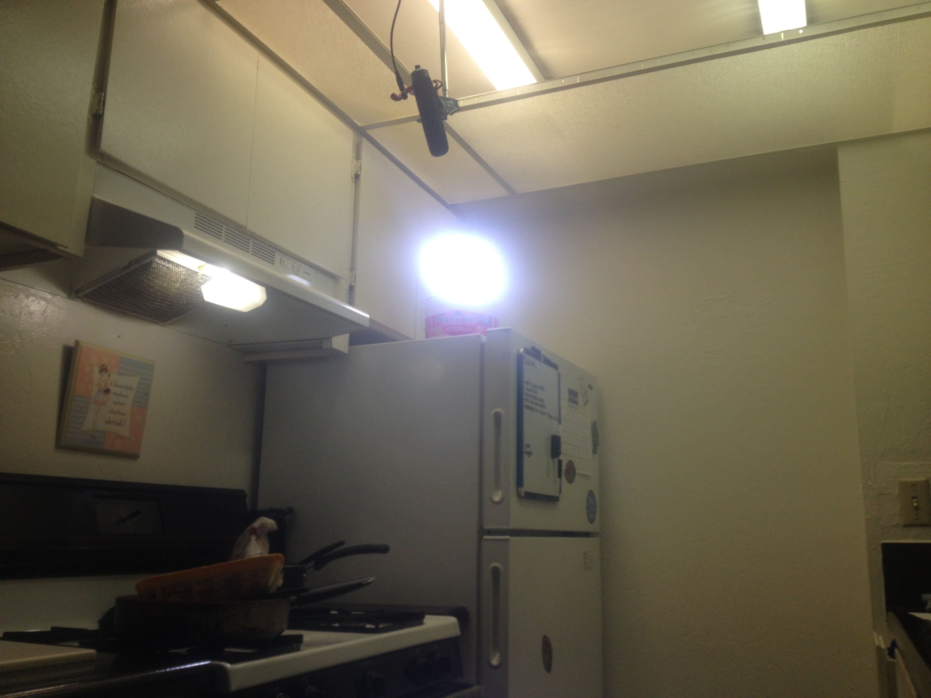

    I have also learned that when you prepare a set properly that takes time, for this movie we filmed in a kitchen. So to dress the set we had to remove all personal items, set up lighting, and remove the ceiling tiles for the sound equipment to be in place. I attached a pic of that as well.

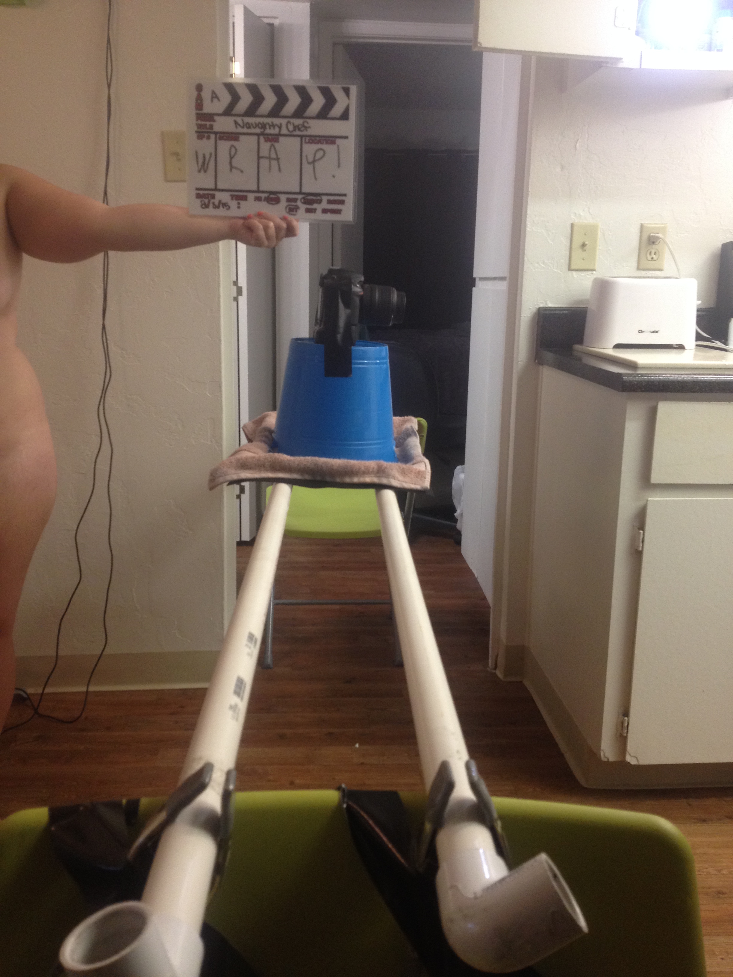

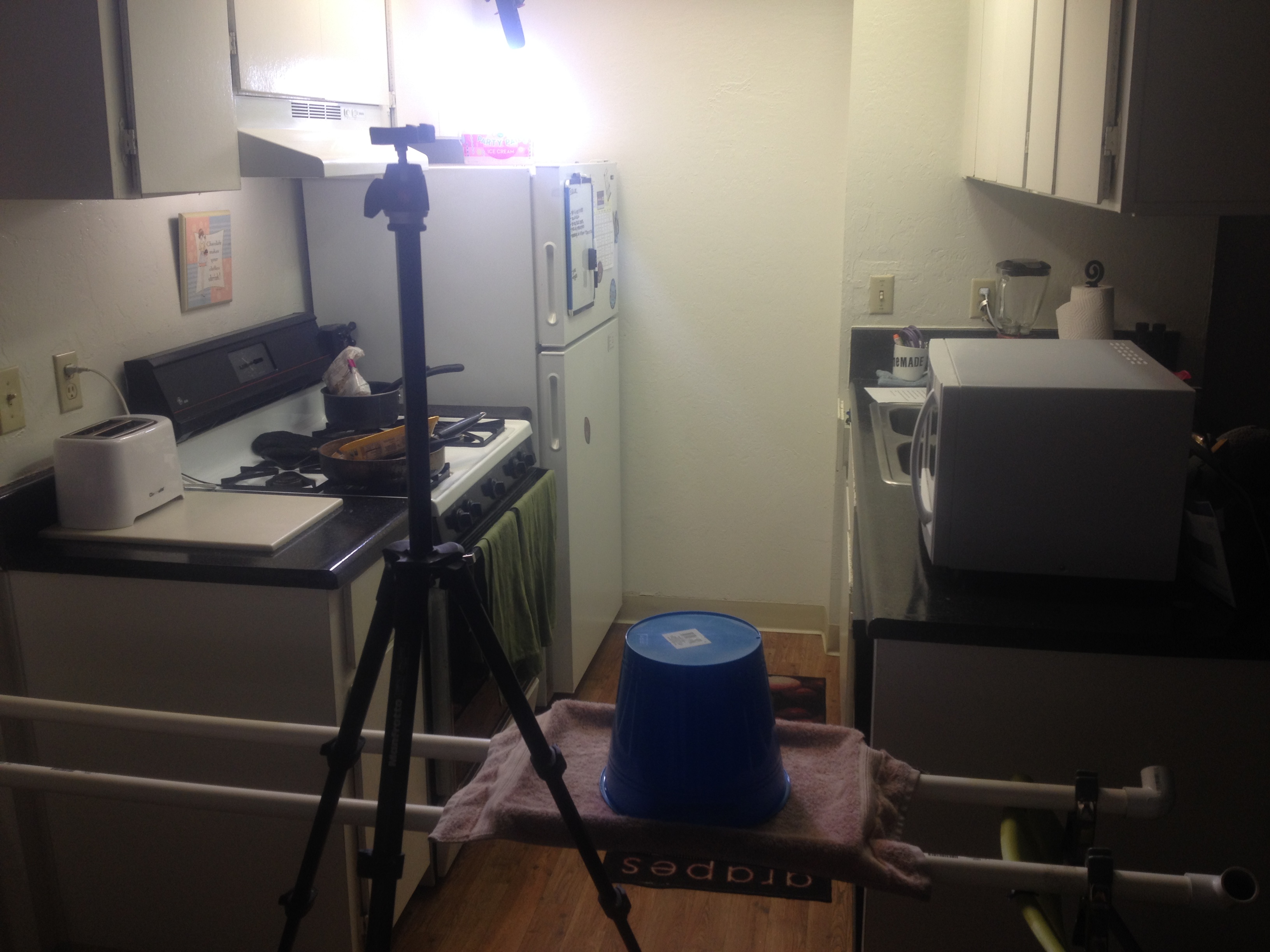

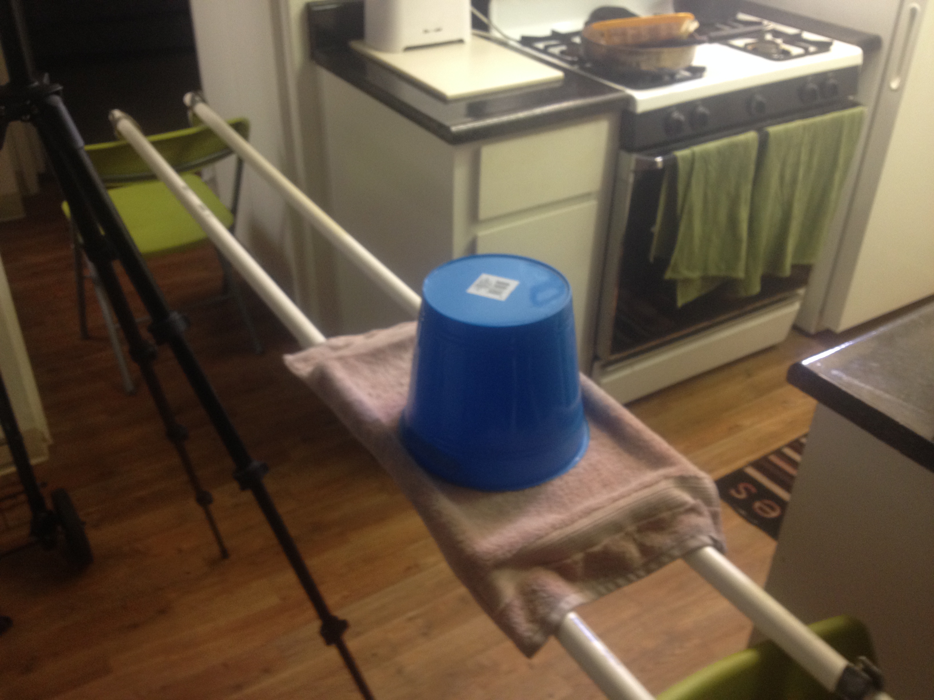

    The first one up is the dolly, In this film i wanted to have a tracking shot across the kitchen for the opening scene, with the camera in a dream like focus, so I used 2 long pieces of PVC (which we normally use for the greenscreen in the studio) and put them on two chairs, I then clamped them down and taped them off. I had my track but no wheels, what to do. I used a baking pan as well as some pvc sheeting to make the dolly slide, I then took a bucket and a small towel to avoid any loud echos, I then taped the camera to the bucket. Believe it or not overall I felt like this added a nice touch. attached is a picture of my dolly, as well as one of one of the actresses at the end of filming next to the dolly

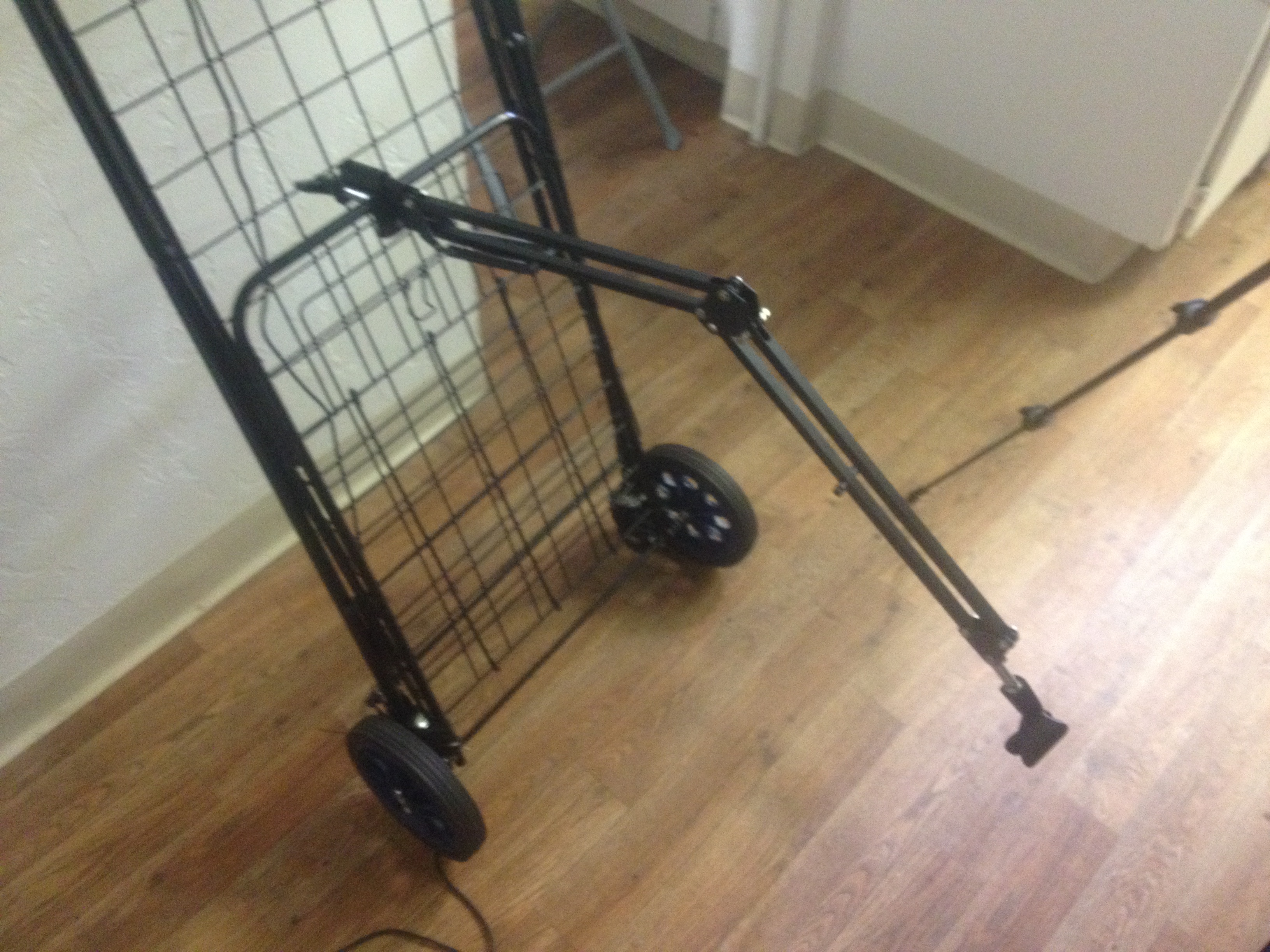

    The second addition I made was creating a jib crane for a shot that started at the actresses waist and slid down as she stepped out of her underwear. the problem with this shot was I wanted it to be a smooth lowering, and not handheld. For the "jib" I used a grocery cart (which had the large wheels for smooth rolling motion) an arm you use to hold mics (from a radio studio we own) a lot of tape, and some foam.
