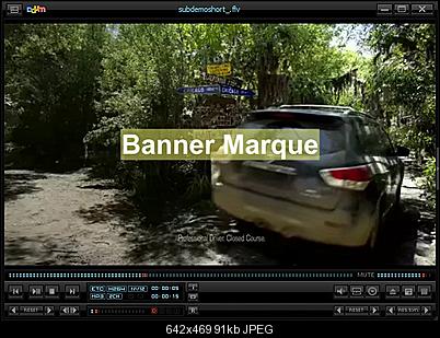

    Using vlc media player i can make a background with adjustable opacity like this
    now i want do the same styling but embedded in the subtitles (.ass) file. Is it possible ?!

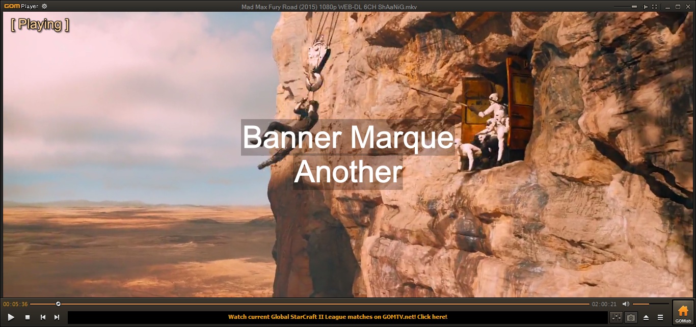

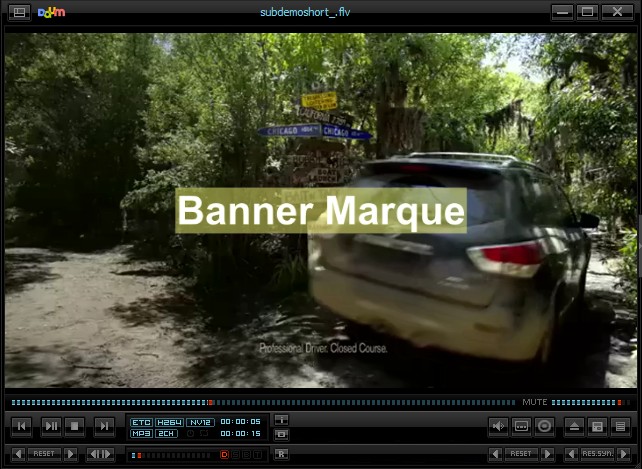

    If you want a transLUCENT box with subtitles, First download the reference manuals I listed earlier then create your .ASS subs like so:
    [Script Info]
    ; Script generated by Aegisub 2.1.9
    ; http://www.aegisub.org/
    Title: Translucent Subs Background demonstration
    Original Script: Mine
    ScriptType: v4.00+
    Collisions: Normal
    PlayResY: 240
    PlayDepth: 0
    Timer: 100.0000
    Video Aspect Ratio: 0
    Video Zoom: 6
    Video Position: 0
    [V4+ Styles]
    Format: Name, Fontname, Fontsize, PrimaryColour, SecondaryColour, TertiaryColour, BackColour, Bold, Italic,BorderStyle, Outline, Shadow, Alignment, MarginL, MarginR, MarginV, AlphaLevel, Encoding
    Style: Default,Arial,30,16777215,65535,65535,65535,-1,0,3,0,0,9,30,30,30,0,0
    [Events]
    Format: Layer, Start, End, Style, Name, MarginL, MarginR, MarginV, Effect, Text
    Dialogue: 0,0:00:00.00,0:00:10.00,Banner,,0000,0000,0000,!Ef fect,{\bord1\3a&c0\an5}Banner Marque
    The "+" sign denotes .ASS subtitles and many decoders/codecs do not handle all the additional parameters of .ASS subtitles so DO NOT INCLUDE them. You can label the subtitle file .SSA or .ASS and they seem to work with the minimum list of format attributes.
    The 3 in the style line means show background "Rectangle"
    The \bord1 means make the border minimum around the text
    The \3a&c0 means make the transparency of the "rectangle" (c0=hex for 192 . 0 =opaque, 255 =transparent)
    The yellow 65535 is the decimal of hex data 40FFFF (BBGGRR=Yellow)

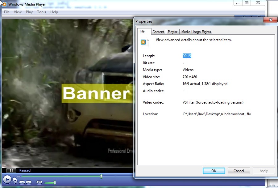

    VLC 2.2.1 , MWindows 7 Media Player and Potplayer plays the subs as so:
Name:	ScreenHunter_159 Aug. 06 02.26.jpg
ID:	33003Click image for larger version
Name:	ScreenHunter_159 Aug. 06 02.33.jpg
ID:	33004Click image for larger version
Name:	ScreenHunter_159 Aug. 06 02.34.jpg
    [Attachment 33003 - Click to enlarge]
    [Attachment 33004 - Click to enlarge]
    [Attachment 33005 - Click to enlarge]

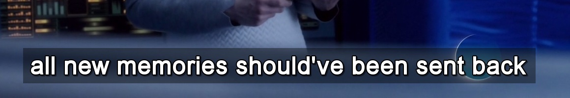

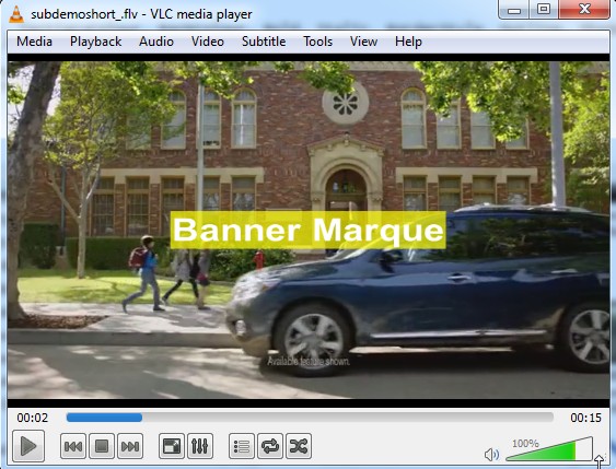

    Well, earlier today i tried setting the outline to opaque box and shadow to 0 with alpha on the outline and it worked very nice but when I tried writing more than one line in each dialogue i saw this
    the border width is set to each line of text and that's not what i want, i want one box to contain the whole dialogue rather than a box for each line.
    And your script does the same trick and shows the same problem
    This is a screen shot of your script

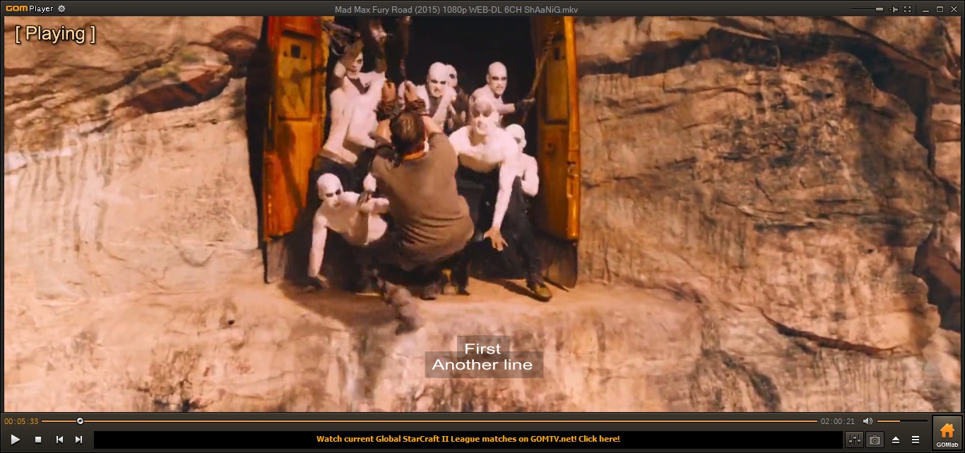

    It can be done... but the subtitles have to be 'Tweaked' with padding. You use alt + numpad 255 for the spaces and end the complete line with a \N New line character.
    You also have to use a font that the spaces are the same as the Character (monospaced). Most computers have Courier New that will work. The new .ASS script is like:
    [Script Info]
    ScriptType: v4.00
    Collisions: Normal
    PlayResY: 240
    PlayDepth: 0
    Timer: 100.0000
    Video Zoom: 6
    Video Position: 0
    [V4 Styles]
    Style: Default,Courier New,30,16777215,65535,65535,0,-1,0,3,1,0,9,30,30,30,0,0
    [Events]
    Dialogue: 0,0:00:00.00,0:02:10.00,Banner,,0000,0000,0000,!Ef fect,{\bord.1\3a&80\an5}Banner Marque\N***Another***\N
    Notice the FontName is set to Courier New and Size of 30, Back color is set to 0 and Alpha (transparency) is set to Hex 80 (128). Thats \Bord{dot}1 like one tenth and the asterisks are the the Alt + Numeric Keypad 255. Hold Alt key and enter 255 then release the Alt key. Needed 3 for front and 3 for behind 'Another' because Banner Marque = 13 spaces including the space, Another = 7, 13-7 = 6.
    Yes its funky but if you want to do it with .ASS subtitles, this will work. You can always write a program to fix the subs automatically like I did, if I ever need it. DON'T FORGET THE TRAILING \N or your trailing spaces get dropped by a lot of viewers.
Name:	ScreenHunter_159 Aug. 07 22.03.jpg

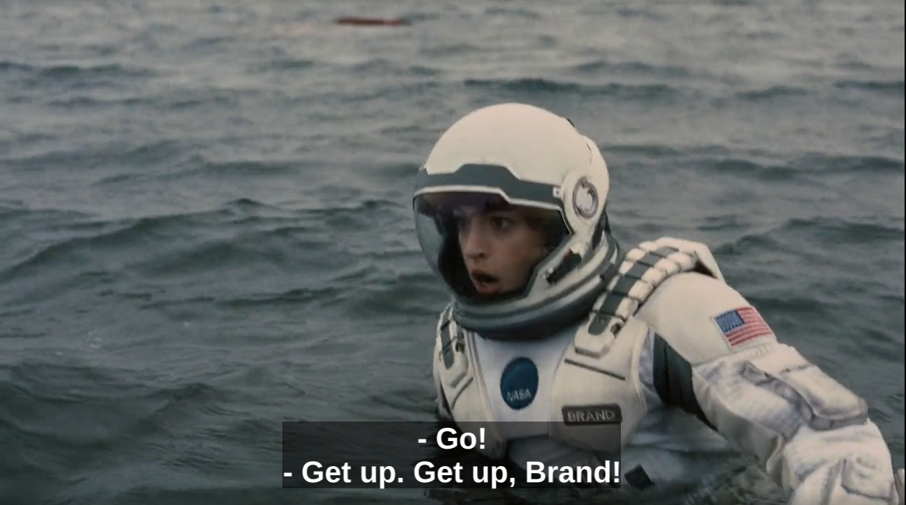

  13. I know this is an old thread but I just wanted to put the solution here in case someone faces the same problem.
    There is now an official way to achieve this by setting borderstyle=4 and controlling the transparency by adjusting the shadow alpha.
    This would result in a very elegant look:
    [Attachment 45201 - Click to enlarge]
    for more information see :
    https://stackoverflow.com/a/25880038/3770251
    https://github.com/libass/libass/issues/268
