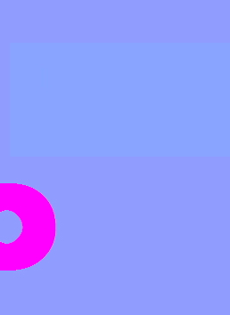

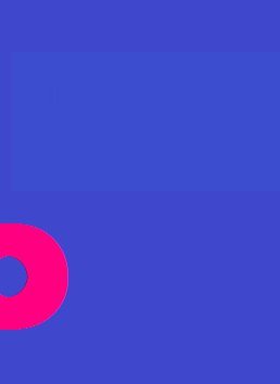

  2. If I understand your images (I'm guessing that the slightly lighter blue block was overlaid onto the darker blue background to hide something) it looks like an RGB image is being convert to YUV with the wrong matrix. rec.601 vs rec.709.

  4. You really need to be more explicit. What software are you using? What exactly are you doing? What exactly are the pictures supposed to be showing? At first I thought the two pictures were showing before and after but that seemed to be too large a difference to match what you were saying in the text.

    So MediaInfo can show the flag in AVI files. Your encoder doesn't appear to specify which matrix was used. Since you haven't supplied samples of your original source images and and encoded video I can only guess: Your video is high def so the player is probably playing it with rec.709 colors. And your encoder is probably using rec.601 colors. That would match the difference in blue shades in your left image above.
    To fix this you need to have your software convert with rec.709 colors. Or leave it as rec.601 but flag it as rec.601. The former is the better solution.

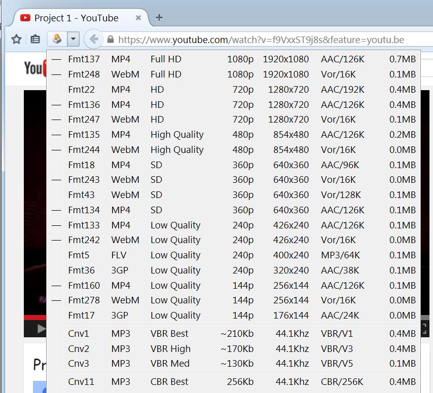

  13. Using Youtube complicates matter because you are introducing several variables: Youtube recompresses the video and may or may not change colorspaces (as I understand it, YUV uploads are not changed, RGB uploads are converted to YUV with a rec.709 matrix whether the video is SD or HD, and the matrix is not flagged). Playing the video in a browser leaves you open to effects of the browser and graphics card (depending on setup). And different browsers will play different versions of the video. For example, here's a list of available versions of your video at Youtube:
    [Attachment 32917 - Click to enlarge]
    Your sample image and the Youtube video played on my computer with Firefox have the same colors. I downloaded a 720p version and a 360p version. Neither is flagged. Both are rec.601.
