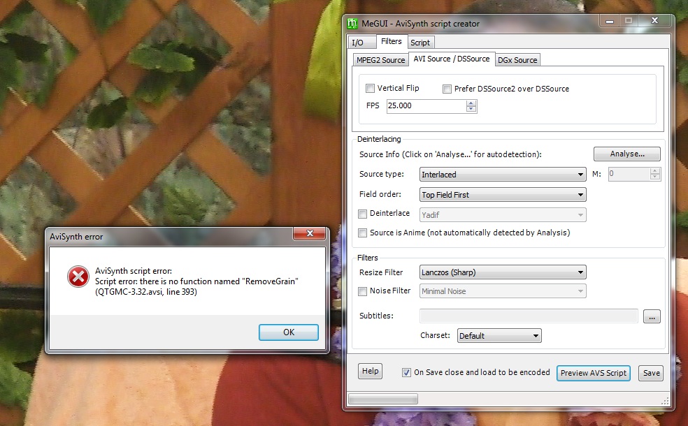

	Ok, I applied the script and it gives an error.
 [Attachment 33136 - Click to enlarge]
 I have the latest avisynth installed.
	Gathering the filter dependencies can be a pain. Some filters need a specific version of a .dll (there might be a dozen different .dll's with the same name)
 There is a package that has everything you need in a single archive (see the "plugins package" link)
 http://forum.doom9.org/showthread.php?t=156028
