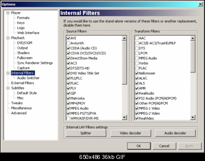

    It sounds like the k-lite options for internal filters are configuring whether MPC-HC uses it's internal filters or system (DirectShow) installed filters but I don't know for sure as I don't use k-lite. If that's what it is, the MPC-HC option for internal filters normally looks like this:
    You'd select a source filter for a file type on the left. If you de-select one, MPC-HC would use a system source filter for that file type instead, if there's an appropriate on available. Otherwise, if they're selected I think the LAV splitter is used.
    If a transform filter on the right is selected, the internal audio or video decoder will be used for that type (LAV audio or video decoder). If it's de-selected, MPC-HC will use an appropriate DirectShow decoder instead (ie something like ffdshow) assuming an appropriate directshow decoder is installed.
    In my case I have most audio types de-selected as I prefer to use the ffdshow audio decoder for decoding audio as I use some of it's filters (equaliser etc).
    Just in case it causes confusion, the LAV filters can be downloaded and installed separately, just as you can download and install the ffdshow codec, but these days MPC-HC also uses LAV for it's internal filters. Whether or not k-lite changes that, I have no idea. I kind of remember k-lite used to install a stripped down version of MPC-HC with no internal filters, but I don't know if it still does.
