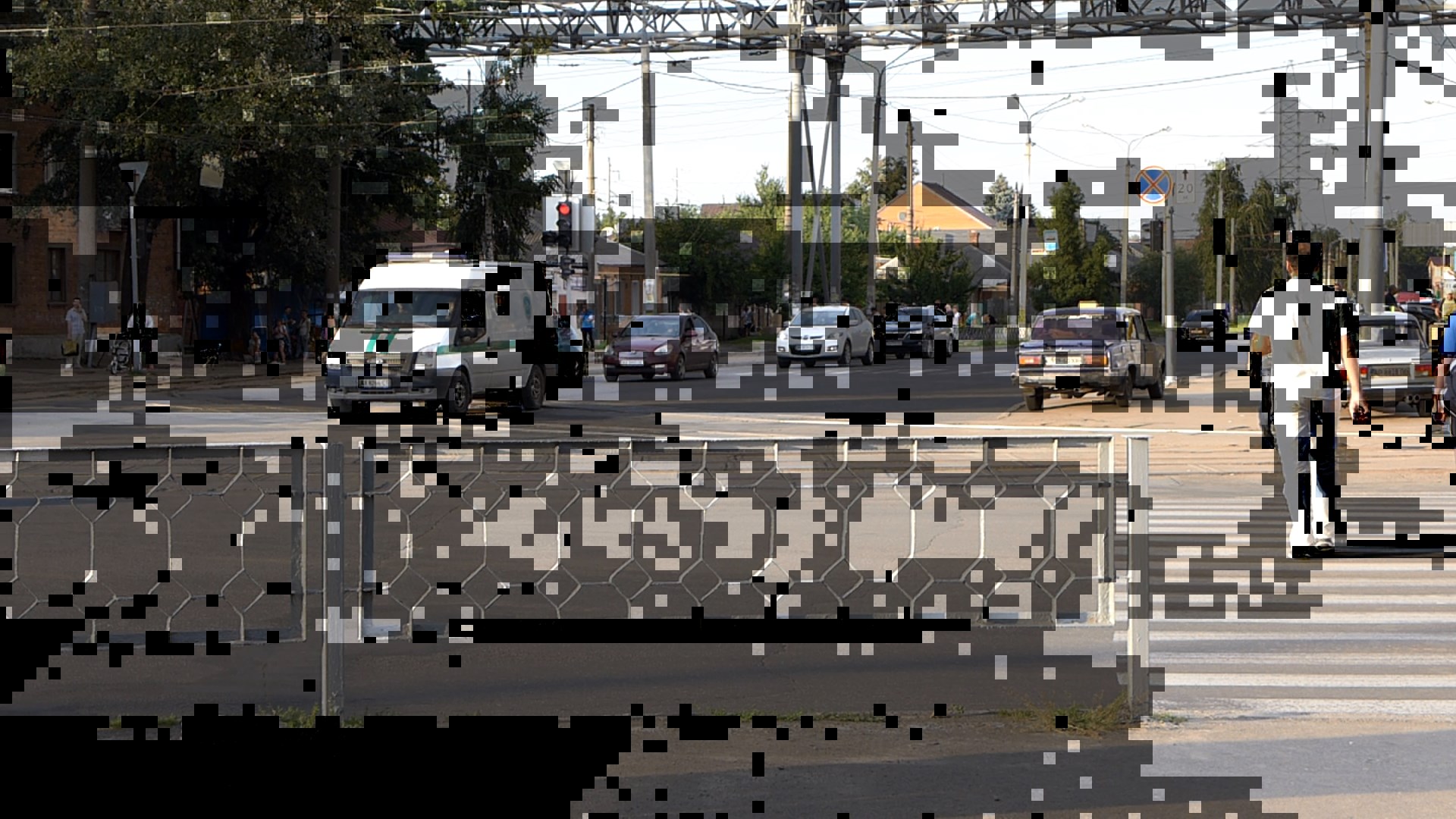

    I use I-frames as A and B to trim, but in result video there is something wrong at the beginning.
    Then (after few frames) the video becomes good.

  4. Probably open GOPs. With open GOPs the last B frames of the GOP can reference the I frame of the next GOP. That I frame has to be decoded before those B frames are decoded. So the B frames are stored AFTER the I frame within the file:
    presentation order: ...PBBI...
    stored order: ...PIBB...
    after cutting: ...IBB...
    Without the preceding P frame those B frames can no longer be decoded properly. And since they are displayed before the I frame you get junk in the first few frames.

  5. Originally Posted by jagabo View Post
    Thank you very much!
    You are right, this is exactly what I have.
    But how can I fix that?
  6. You have to reencode the cut GOPs. You could use an editor that reencodes the entire video but that will be time consuming and decrease quality of the entire video. Or you can use a smart editor like VideoRedo that only reencodes the cut GOPs (the rest of the video is only remuxed).
