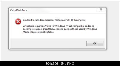

    Jul 2015
    Michigan
    Okay, I tried using Virtual Dub and this is the error I got:Click image for larger version
  20. CFHD is cineform fourcc
    You need to install gopro cineform studio to get the free codec
    Aug 2013
    Central Germany
    @ Baffled2015:
    Was it hard for you to ignore the request for a MediaInfo analysis in answer #2?

  23. Originally Posted by TorBru View Post
    VDub did the job nicely, though
    Yes, good work. He decided to answer your question with some real information, for a change, and the problem was able to be solved. However, had he answered LigH.de's request for the MediaInfo information to begin with, the problem would have been solved much earlier.

    We may have known already early that ffmpeg would probably not be able to decode it. Thus neither YouTube.
  26. Originally Posted by TorBru View Post
    What charge? MediaInfo would, AFAIK, not have been able to solve issues related to the AVI container or the index thereof...
    Of course it would have. MediaInfo would have named the Cineform Codec and as a result the suggestion would have been made immediately to install the Cineform Decoder. And, as LigH.de mentioned, it would have also been immediately obvious the reason the YouTube uploads wouldn't process - that Baffled2015 would have to convert them to a format YouTube accepts. That was the main question of this thread - why some of his uploads wouldn't complete processing.
