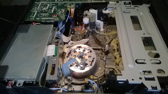

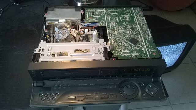

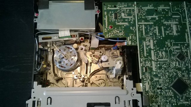

I hate to bump my own thread, but I'm still holding out hope that someone will pass by and know the answer here... I've taken a few pictures of the VCR with the cover off, perhaps someone can see wether all the cables are still where they should be?
I can't see what's wrong, but then I barely know anything about these things...
