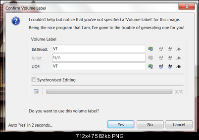

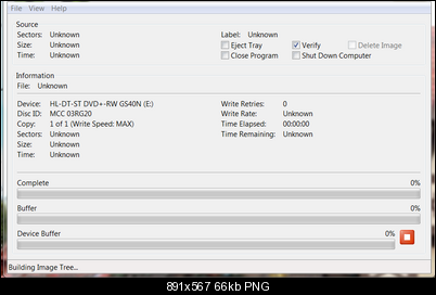

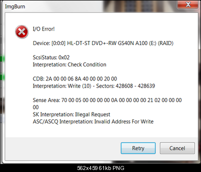

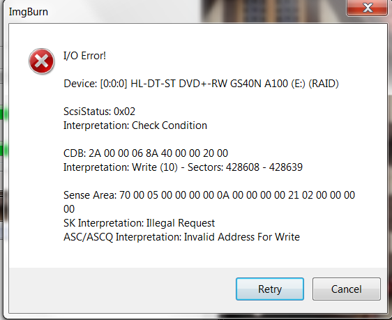

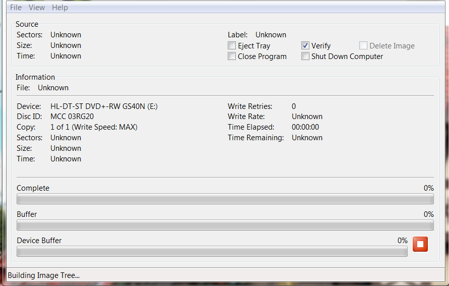

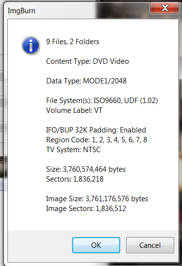

    Using Imgburn, here's my steps, error, and log.
    Open Imgburn > Mode > Build > Output > DVD drive > Browse > selected VIDEO_TS folder > Select Folder > Build
    These screen shots are what appeared in order. ImgBurn Log attached, which may include a few attempts.

  8. Member hech54's Avatar
    Jul 2001
    Yank in Europe
    The ImgBurn log says that the blank is now an "MCC" disc, which is normal for many Verbatims.
    Are you trying to burn the same exact disc over and over? Have you tried just grabbing another disc from the stack?

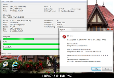

    Aug 2009

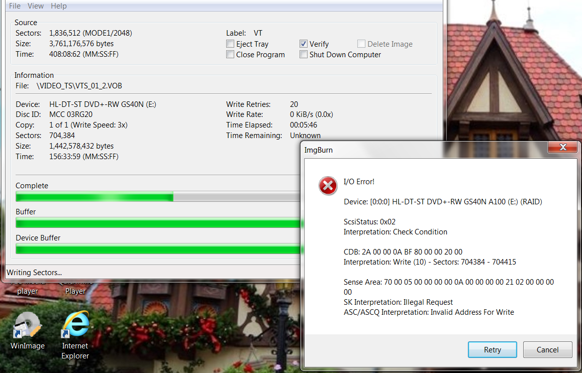

    Update
  13. If you want to upload the files I can try to make the dvd
  14. Member hech54's Avatar
    Jul 2001
    Yank in Europe
    Open the folder in VLC or another player to test it to see if the structure is intact.
    Aug 2009
    Thanks. I opened the folder in VLC. Menu pops up and content plays.
  16. Member hech54's Avatar
    Jul 2001
    Yank in Europe
    Then it's your drive or your discs. When drives (start to) die they do most things perfectly normally but refuse to cooperate while doing one or two tasks. ImgBurn is bulletproof and has been proven as bulletproof time and time again for a VERY long time.
