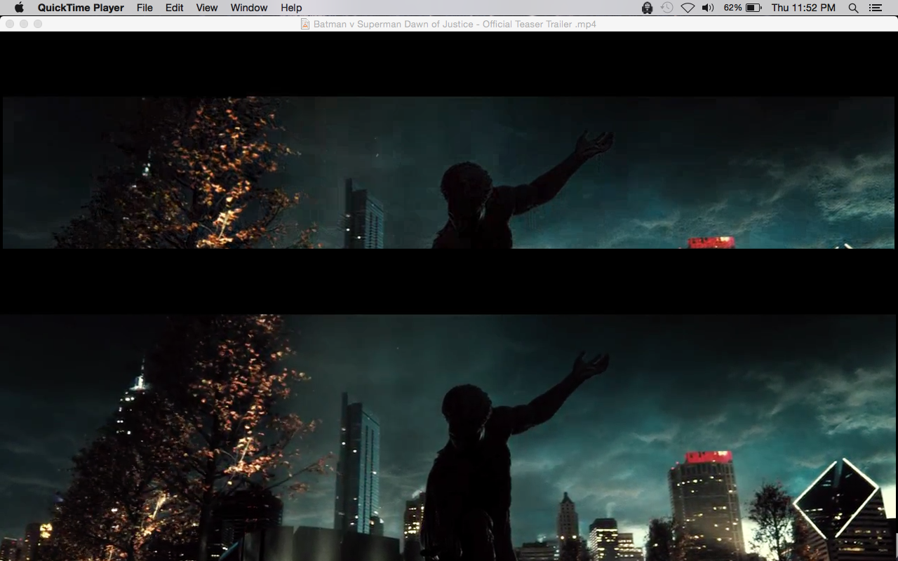

  1. Hey guys! As the title suggests, I'm having problems with the way video files look when using my macs. Up until a few months ago I didn't even know there WAS a problem, then I got an iphone 6 plus and started recording 1080p 60fps video and the video just looked choppy and bad on my computer yet silky smooth on my phone. A few days ago I accidentally opened a file using quicktime and wow, everything was smooth! There was far less blockieness in color gradients, I always thought that was just part of the video file itself but apparently VLC introduced it.
    Comparison screenshot is below, you can see on the vlc part of the frame all the distortion in the sky, how the colors are super blocky. On the quicktime version it's much more natural looking. I also am able to play 1080p 60fps video smoothly using quicktime or itunes whereas on vlc it's choppy and often times gets very blocky looking.

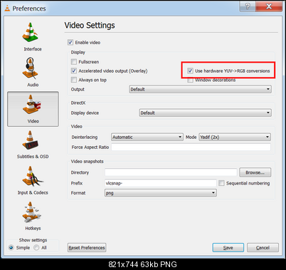

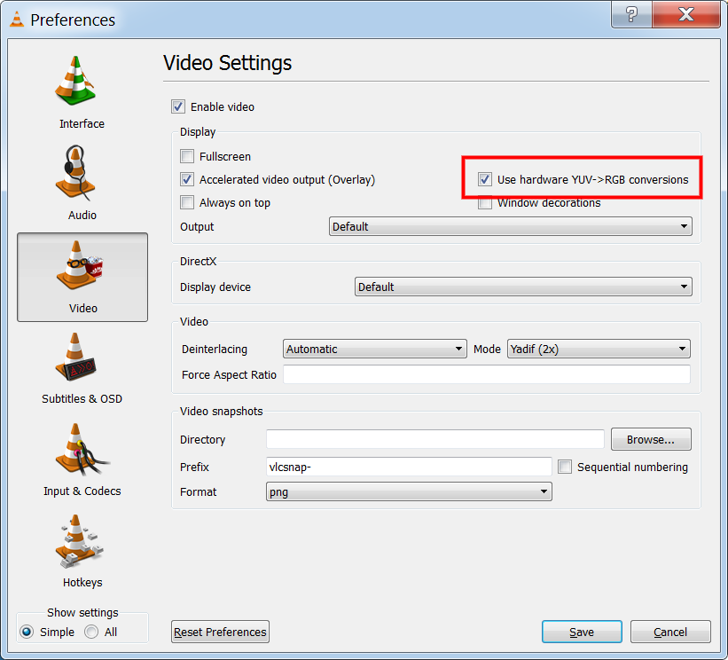

    "Hardware YUV -> RGB Conversion option" where do I find this?
    Maybe it's not in the Mac version? In the Preferences dialog of the Windows version:

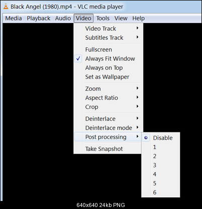

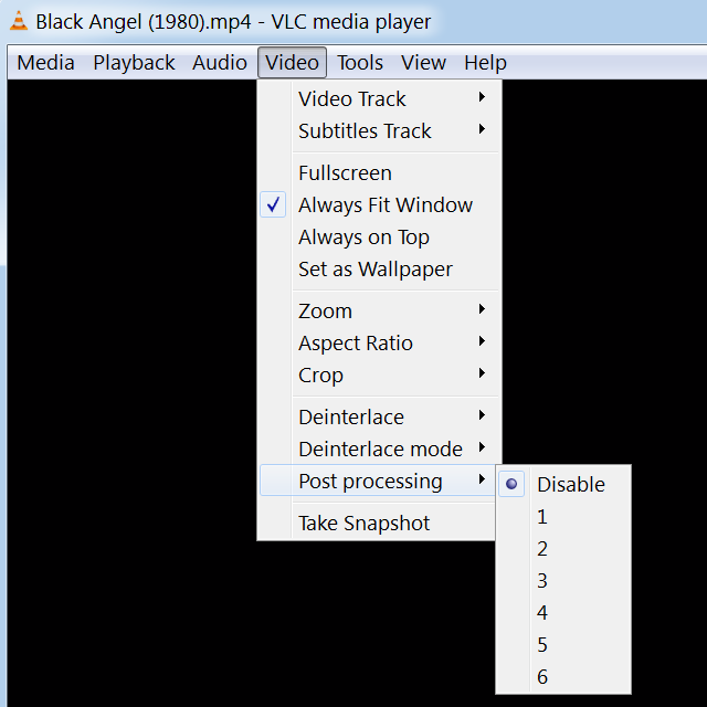

    And "Video post processing filter" where is this box?
    I couldn't find that setting in the Preference dialog. On the Video menu (Windows version again):
