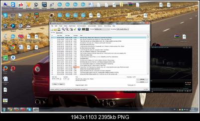

  1. Why when I insert srt file and after this convert into .scc. Timing in scc is changed and the 2 lines are splitted of 3 lines?
    I want when I export subtitle file no change in timing and the lines. Thanks.

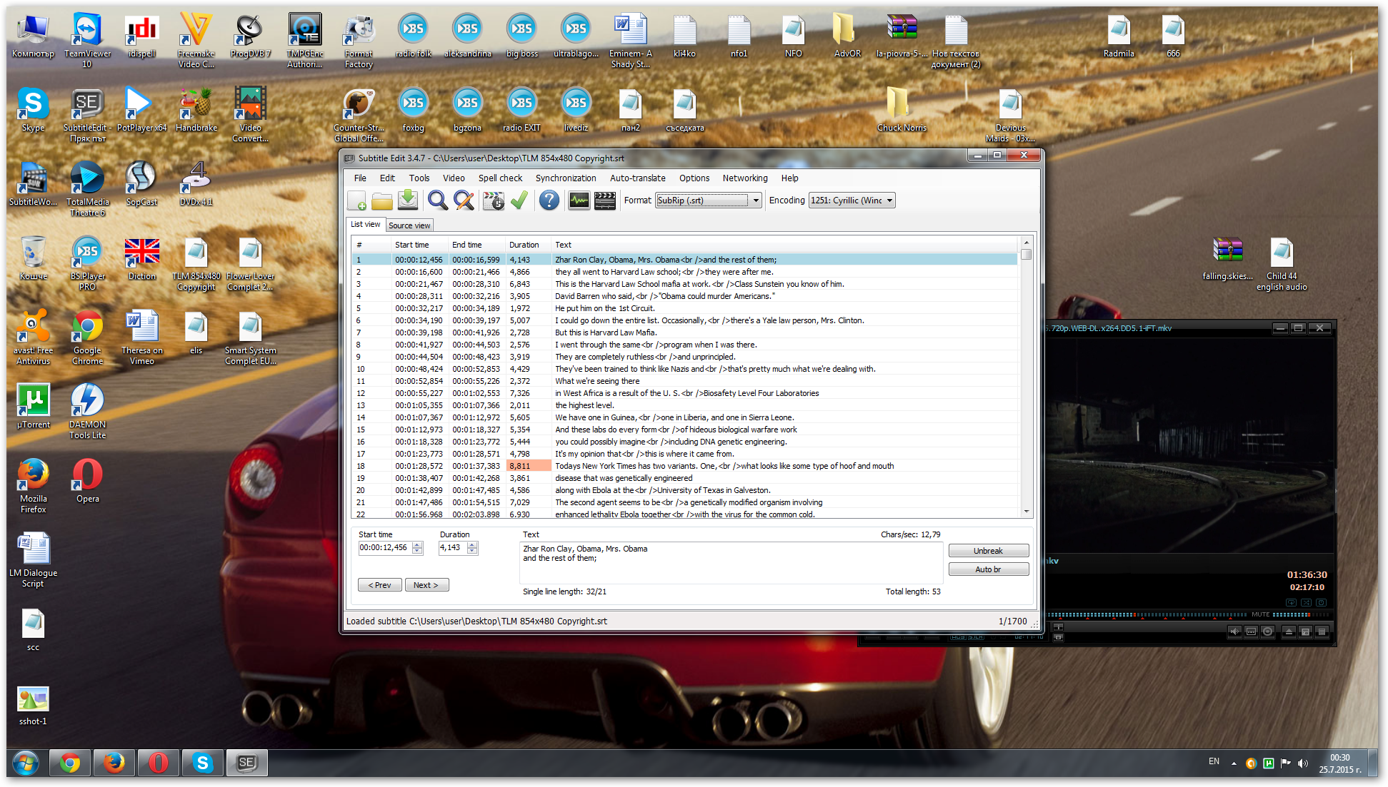

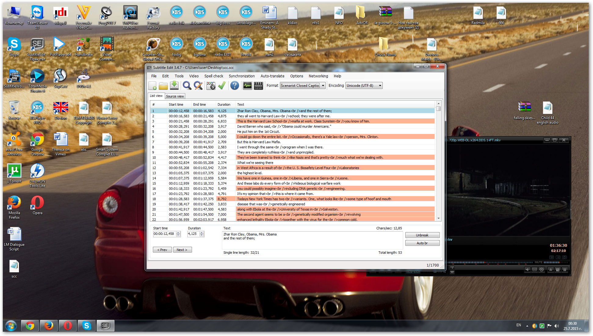

    Check before and after.

    OK, so the extra lines are being cause by the 32 character per line limitation in Closed Captions. If you're converting to closed captions there's no way around that.
    The different timings are being caused by the bandwidth limitations in Closed Captioning. Bascially, Closed Captions are an analogue NTSC standard designed to be written into Line 21 two bytes at a time 29.970 times a second, which means at an absolute maximum, without any formatting or special characters, it's possible to write only about 60 characters into Closed Captions per second.
    I have a nasty feeling the current implementation of Subtitle Edit uses the "60 characters a second" limitation as an absolute and ignores the formatting/special character bytes that are needed for every line, I haven't put it to the test yet though.
    Subtitle Extractor has to alter the timecodes to fit the subtitles into whatever speed limitation processes they're using.
    Bascially, you're encountering the Closed Caption limitations, Subtitle Edits implementation of Closed Captions may not be perfect at the moment but you'll never get an exact representation of your srt files while converting to proper Closed Captions.

    Yes, Subtitle Edit enforces max 32 chars per line and max four lines, so make sure your srt uses the same settings (better max two lines at max 32 chars).
    The time codes may not be perfect in SE for scc files (patches on github are welcome

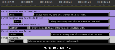

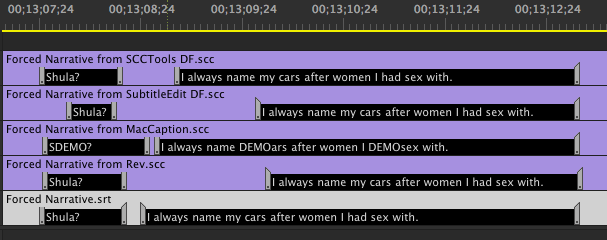

    Here is what it all looks like, in a challenging case of a long caption immediately after a short one: ((which happens to be from a crass character in a comedy))
Name:	Screen Shot 2016-08-18 at 11.55.06 PM.png
    You can see the mess. MacCaption is the best by far. Too bad it's $1,100.
