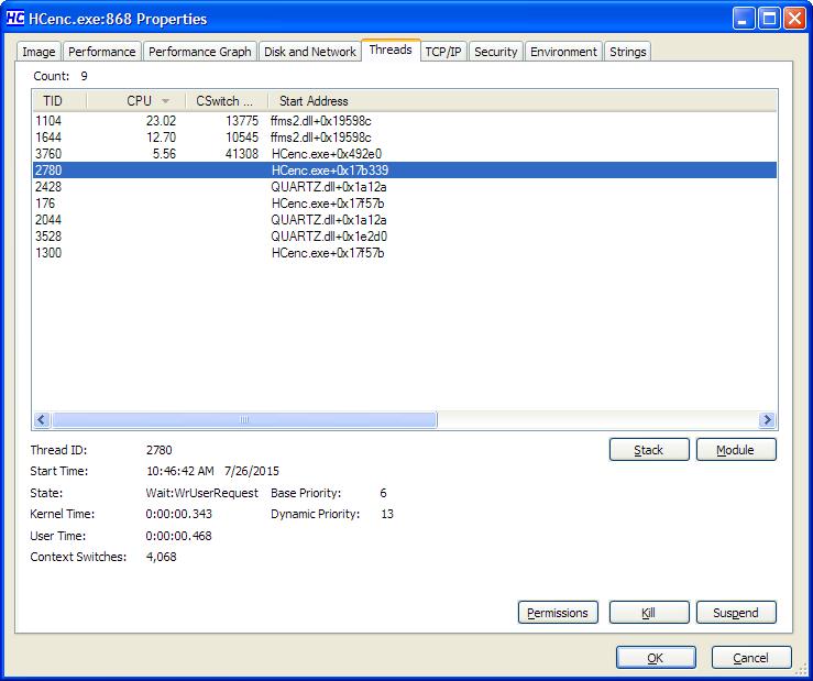

    EDIT - the combination of MotionProtectedFPS and FFmpegsource video filter when used with HCenc is the combination
    that is troublesome. Why it does not occur when FFmpeg encoder is used, I've no idea. Using directshowsource
    seems to work much better.
    The following image shows that when the combination is as above, almost all of the cpu is used in FFMS2.DLL.

    thanks for jumping in. It's actually the sampling phase of 1-pass encode that "slows to crawl".
    The combination of HCenc 1-pass + FFMS2 + MotionProtectedFPS is somehow problematic. Some more tests:
    HCenc 1p + FFMS2 + ChangeFPS -> OK
    HCenc 1p + FFMS2 + ConvertFPS -> OK
    HCenc 1p + DSS + MotionProtectedFPS -> OK
    HCenc 2p + FFMS2 + MotionProtectedFPS -> OK
    Using seekmode=1 instead of seekmode=0 (A2D default) in FFMS2 helps a bit.
