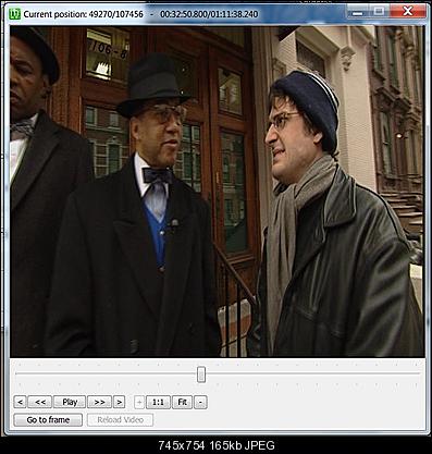

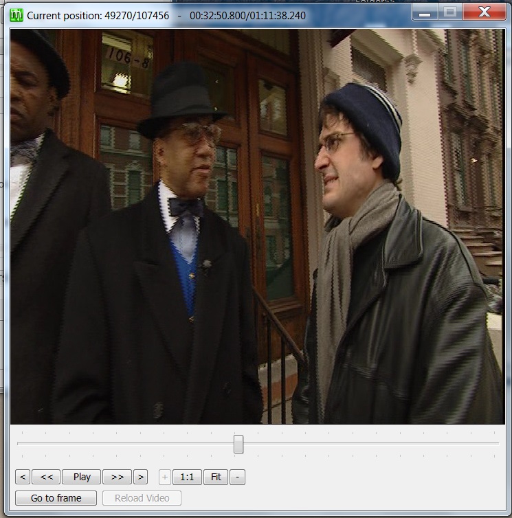

    You only get black bars directly on a dvd if that dvd is 4:3 and the picture is not.
    Even though I live in the US, I do have one 16:9 PAL DVD which seems to follow the ITU standard of 1.82, by including the black bar on the right. This is just the unstretched 720x576.

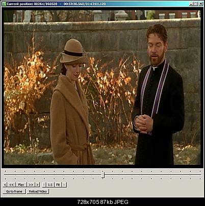

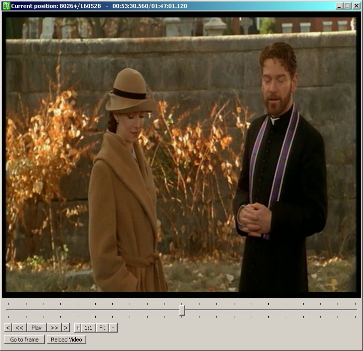

    I wouldn't count on the tiny bit of black down the right in the previous screenshot as indicating ITU. Something like this would make ITU more likely:

    Black down the sides increases the likelihood of ITU and a lack of it makes exact 16:9 more likely, but there's no guarantee either way.
    You only get black bars directly on a dvd if that dvd is 4:3 and the picture is not..
    The above screenshot is from a 16:9 DVD. Most 16:9 are probably just 1.77777, which is probably why they don't often have much black down the sides, or none at all, but they sometimes do.
