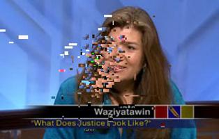

    Sorry for my english With glittering I meen pixelation, or pixel error. Like on the image. It would be so much easier if a program could do this for me, so I wouldnīt have to spend 2 hours, looking the movie through.
    I know some programs can do this, but they are not freeware! Like TS-Doctor.Name:  369737.jpg

    This looks indeed like decoding errors. Possibly a broken video bitstream due to low signal quality or brief interruptions (imagine a bird passing your LNB).
    I am not sure how to deal with this. Most video decoders will try to return a decoding result without crashing if possible, even if it may contain some previous content in case of a decoding error; you would possibly need a decoder which will not crash but instead signal an error state so that e.g. VirtualDub's feature "Scan for video errors" would record them. But I have no clue if any AviSynth decoder would be able to behave accordingly.
    Your best bet may be ffprobe, it should report decoding errors in its console output. But you may get a lot of errors even if you won't spot any issues visually.

  7. If the problem was in the broadcast (for example, satellite reception in bad weather) there will be no errors in your re-encoded file. The blocks are now part of the picture.
