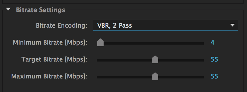

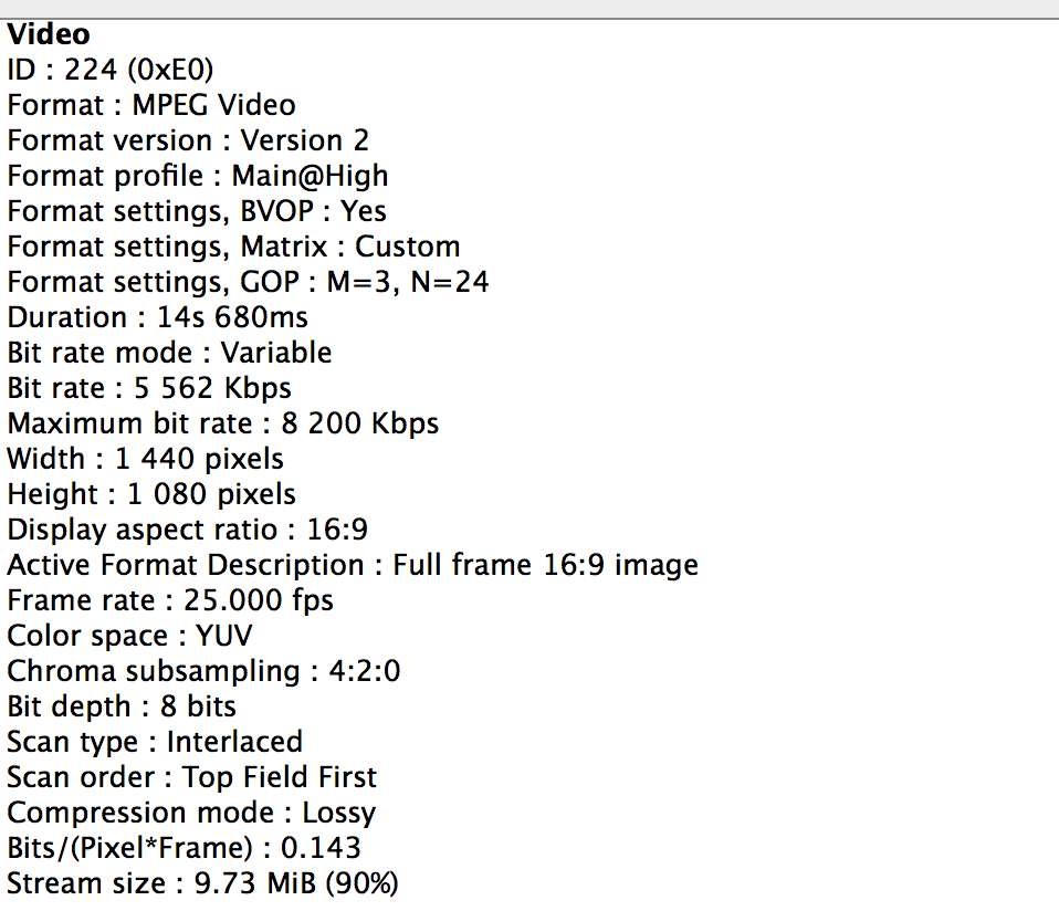

    Thank you both for the reply.
    I need to re-encode this video.
    Have a look at the video settings of the clip:
    When I use AME (second image), these are my bit-rate settings and still getting some quality loss.

    Having a target bitrate of 55Mbps is a lot even for 1080i, you could get away with the same bitrate as your source if doing a 2 Pass.

  10. Why first picture shows 5.562Kbs as bitrate and 8.200Kbs as maximum bitrate for 1440x1080 resolution? That bitrate can be used for SD resolution (720x480, 720x576), not for HD.
    If you intend to play via HDMI you can use H.264 format. It is more efficient than old MPEG2.
  11. Banned
    Oct 2014
    Northern California
    Yes, reencode to H.264 instead of old MPEG-2 and use a much higher bitrate than 5.6/8.2Mbs as that is too low for your resolution.

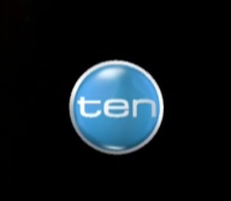

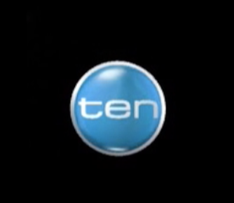

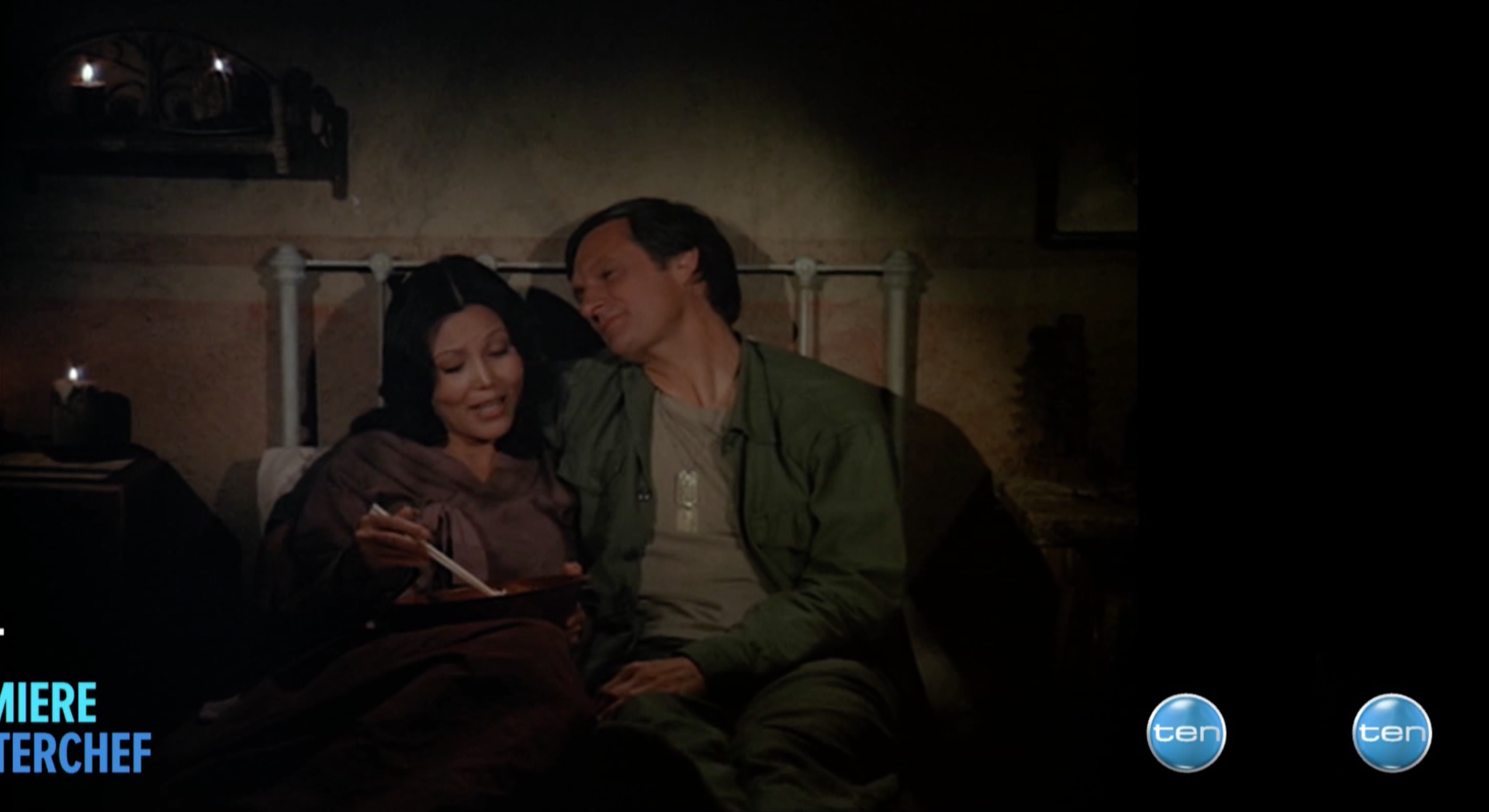

    Here is the video example. The original is on the left and mine is on the right (re-encoded file). Pay attention to the ten logo quality the most. See any difference?
    Bitrate= 55
    Target = 55
    Minimum Bitrate = 10
    Maximum checked.
    The only difference I have changed with the footage is make is 1920 by 1080 and interpret the file as square pixels in After Effects. I might be a-little picky on this one, but I can see a slight loss in sharpness, can you see it?

  14. I don't see your videos, just a confusing screenshot . Are we supposed to be comparing the two "ten" logos ?

    Sorry, I meant a screen shot comparing the quality. I mentioned before to look at the two ten logos to see if you see a drop in quality from the two (Left is original and right is re-encoded).
    The only thing I have changed with the original footage is interpret it as "square pixels 1.00" other then that, I haven't messed with anything.
  16. yes there is difference - but it's not even the same logo from the same scene (the fake reflection is even at a different angle), but a static logo is probably not where you should be looking . Look and compare scenes with high motion if you're interested in looking for mpeg2 compression artifacts. Even at high bitrates you will see fine macroblocking . So if you still wanted it "perfect", and don't care about filesize - just use uncompressed or a lossless codec
    If you crop it down so they are framed the same way (since you didn't upload 2 screenshots) and compare them in different tabs you will see what I mean

    They actually were two screen shots, one video over the other to compare and I screened it into one. (Its the same scene/video)
    I'm actually more interested in the quality of the logo over anything else and keeping the logo as original when it comes down to quality which has been difficult.
  18. Even if they were 2 overlaid and x-offset screenshots, there is a problem with the angle of the specular reflection - can't you see that ?
    Your problem is solved if it was only compression problems - use a lossless codec . Not difficult at all

  20. Originally Posted by HDBroadcast View Post
    I'm confused as to what you mean by "problem with the angle of the specular reflection". That's how the video is, if that's what you mean?
    Those "white" spots on the logo are what graphic design artists put on to make the logo appear "3D" ish. They are called "specular reflections"
    You're said you're concerned about the logo
    You compared them with a screenshot. You mentioned the same scene, but presumably they are from the same frame (that's how you're supposed to compare things)
    Here is an animated gif illustrating what I mean. It's the left and right logo in your screenshot, just cropped so they are aligned and alternating back and forth. (don't pay attention to the quality, since it's a gif. Pay attention to the movement of the reflection - notice how it shifts, but the letters don't shift)
    To me that indicates other problems. It's not just a quality difference from compression . Either with your process, method of comparing, maybe you messed up the screenshot - something. Something else is wrong.
    What about the other parts of the video? What other things are going on? What other problems are there? There is bound to be other issues
    It's easier for most people to compare things with layers. You mentioned after effects. Just put 2 versions on 2 different layers, align them and solo one of them at a time. That way you flip back & forth between them
