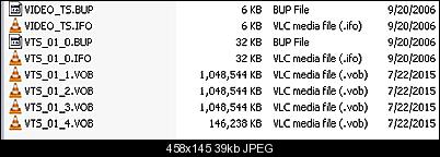

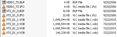

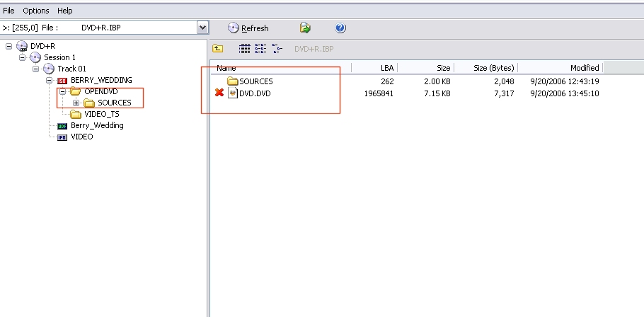

    Thanks for responses. This is a DVD+r and the file structure looks right, see image 1 .
    Having said that and in response to the point about odd looking files, I do have an OPENDVD Directory aswell as VIDEO_TS see image 2
    Just for future reference and head off all of the possible future fanboy nonsense....it doesn't matter if the disc is +R or -R.
    This disc is simply either damaged or authored badly....maybe even authored badly on purpose. Many of these companies
    that sell you a disc of a wedding add their own "poor man's copy protection" to the disc....IE it's authored incorrectly.
    Try taking one piece at a time via simply copy & paste in windows....see if you get all of the VIDEO_TS folder contents that way.
