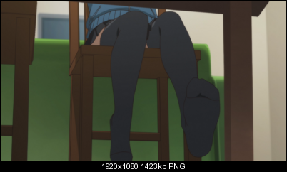

    Original disc playing as is in PowerDVD:
Name:	PowerDVD Original Disc.png

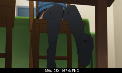

    MakeMKV VLC/PowerDVD:
    Also, I've tried playing the MKV file in PowerDVD. (I thought VLC was adding the extra bit of contrast.) But, nothing had seemed to change.

    To mention also, you can also notice more of a gradient on the MKV file on the leggings. Could be just because the video is darker.
  11. It's just a playback configuration issue. PC vs. TV levels and Rec 601 vs. 709.
    Your VLC is probably set to output full range (PC levels) and Rec709 (ie it's "mapping" standard range Y16-235, UV16-240 to RGB 0-255). That's the default behaviour for VLC if it's a fairly recent version (within the last few years)
    PowerDVD is likely using Rec601 and outputting limited range (or converting YUV to RGB for display with full range matrix)
    I say this because if you take your VLC screenshot and "undo" it with
    Levels(0,1,255,16,235,false)
    ConverttoYV24(matrix="rec709")
    ConvertToRGB(matrix="rec601")
    You get basically the same thing . Besides, makemkv can't change anything
