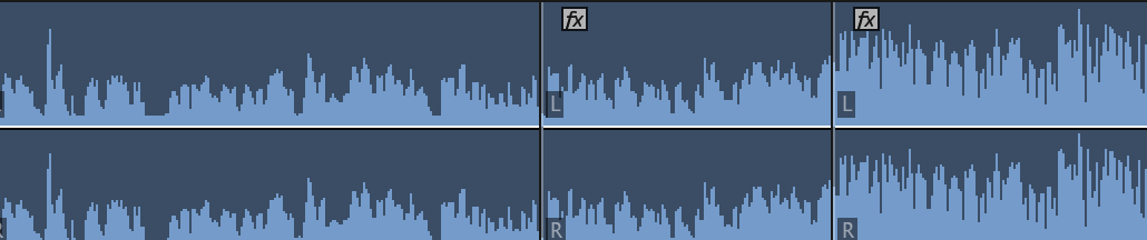

    Sorry, maybe this would be more clear?
    The range of the main clip is -18/-6. But there's an "um" in the middle, so I cut it out, resulting in two separate clips. The first clip now has a range of -18/-12. When the audio gain is applied, the -18/-12 clip goes up in range to -12/-6, but the second clip stays at -18/-6 because it's already at the peak, so there's an awkward sound change from the -12/-6 clip to the -18/-6.

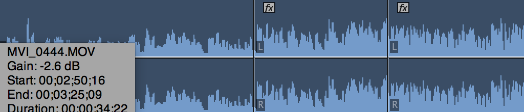

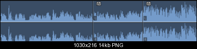

    Jul 2015
    Los Angeles
    So here's some snapshots. The first is the original volume, with the interviewee speaking louder in the third clip. All three normalized is the second pic. You can see that the middle clip jumps up in volume compared to the first, and this results in a sudden volume increase, and then it drops off again at the third clip, with another sudden volume change.
    The same thing occurs when just normalizing the first two clips (leaving the louder third clip out of the normalization)

    Sorry I am simply not getting it.
    Selecting 'normalize all peaks' for all the clips will never change the relative volume of the clips.
