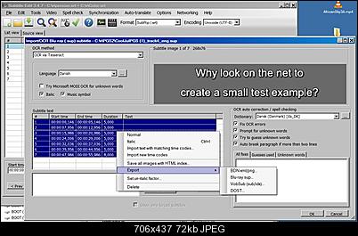

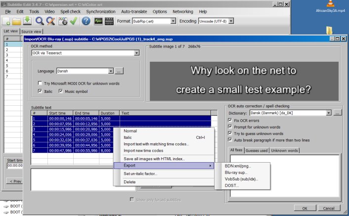

  19. and the only one I know of at present that allows this functionality.
    You can do the same in Subtitle Edit. When you open a PGS file SE prepare for OCR. Instead you can highligth all /Ctrl+A), Right click, and select to export to PGS, IDX/VOBSUB, XML/PNG with re-size and selection of FPS.

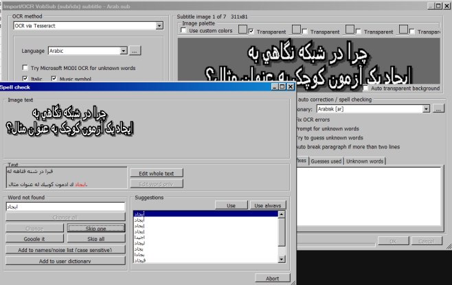

  23. me to be accurate with non-English languages
    I'm not sure if you're refering to Subtitle Edit but in the OCR window there are 3 dots next to "Language" that allows you to add Tessseract data for any language and 3 dots next to "Dictionary" where you can download appropriate dictionary. Also note you can add unknown words (Like names of characters, places etc) to "User Dictionary"
