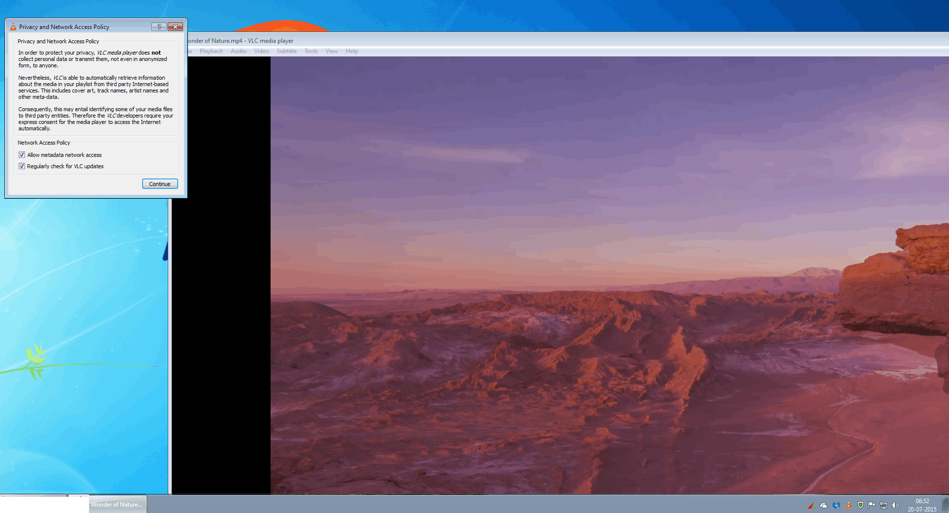

  1. A irritating thing I have with VLC Player is that it always starts off-screen, i.e. it shows -say- 3/4 of the screen, the rest is off-screen.
    I have to resize it it a lot.
    Issue has been reported a few times by others but it seems the default solution (removing preferences) does not solve the issue.
    At least not with me. Even if no preferences are set, it starts off-screen.
    VLC opens up off screen

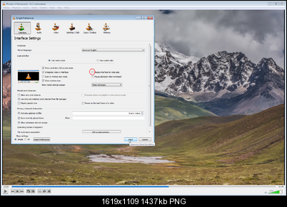

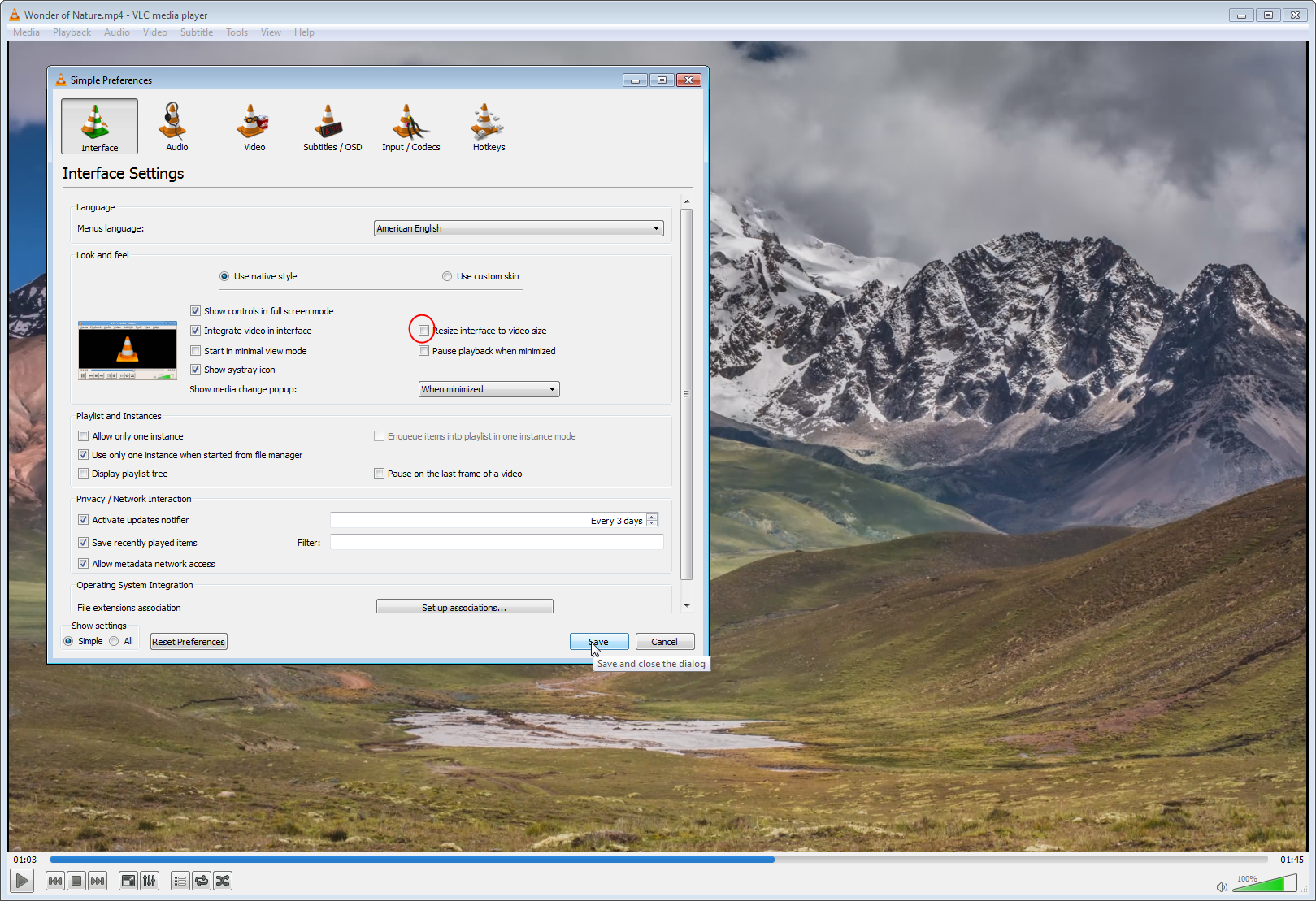

    I then continued to untag VLC Settings->"Resize interface to video size", resulting in a small playback box, which is again too small.

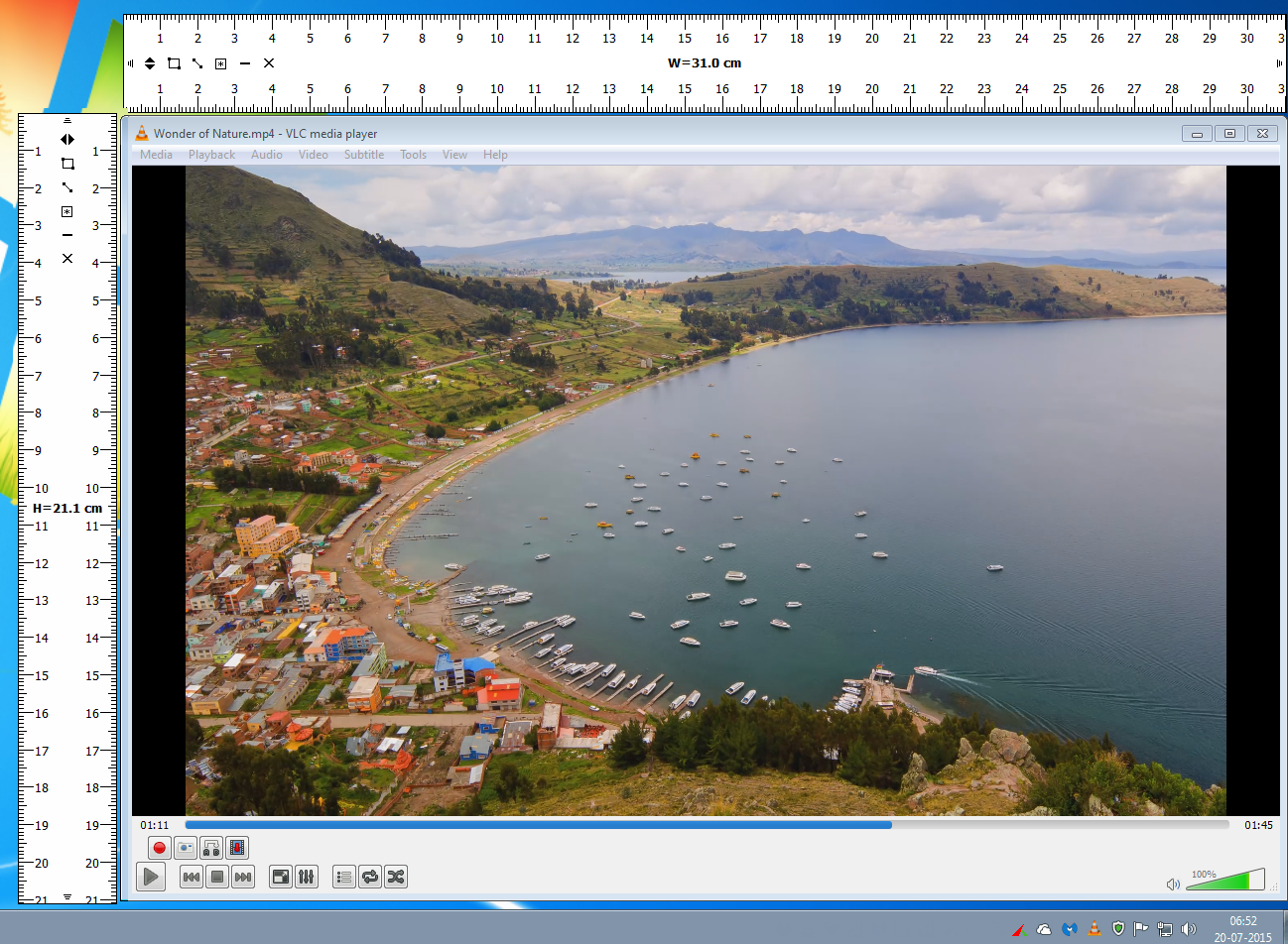

    I changed the size of the box again, moved to another place on my screen and now it stick, i.e. the size I want.
    Until next time....
