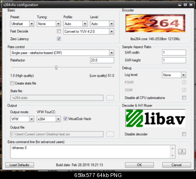

    Here are my current settings:

  9. Use mod 4 frame widths and heights.
  10. Chicken McNewblet
    Sep 2009
    God damn, that was it.
    I was recording for the purpose of fitting multiple 853x480 videos into a single 1080 frame (without having to resize). Changing the recording area to 1280x720 fixed the issue.
    Thank you muchly!
