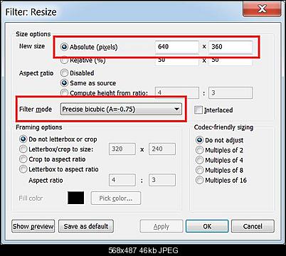

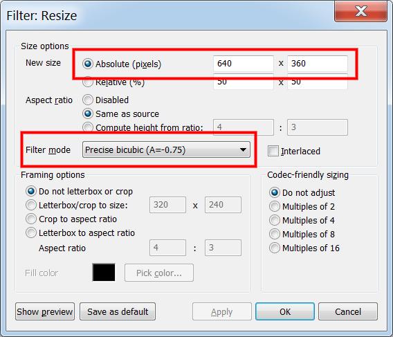

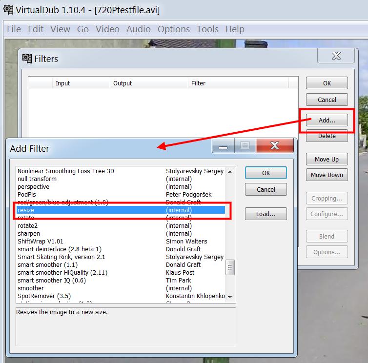

    Use the Resize filter built into VirtualDub. This is for resizing the frame, not the file size.
    In the Filter Mode pulldown are several options. In general the ones at the top are the least sharp, at the bottom most sharp.

    I will navigate to the resize option. 1280x720 would then resize to 640x360 (?)

    Select Video Filter Resize to 640 360 ( when adding 640, 360 auto completes.)
    Use whatever size you want. 640x360 will keep the correct aspect ratio.
