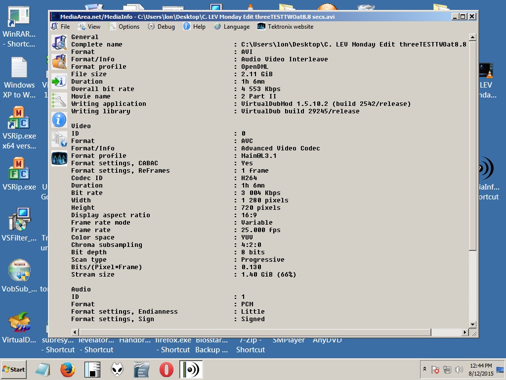

  13. You need to state exactly what you are trying to do. What are you starting with? What is your desired final product(s)? What editing and fitlering do you want to perform between those two?
  14. I'll make a list. Back shortly.
    I'll start with what I know from MediaInfo on the original, but snipped file which I viewed last night and appears 'all good.' Both audio and video.
    It's good I'm not rushing ahead at this point.
  15. Starting from the beginning, here is the info requested in the best screen shot I could make.
    Note: No matter how often I repeated the simple act of asking MediaInfo to Export to text it didn't seem to copy anywhere for all my trying. For this reason some of the aduo part is dropped off.

  16. As to your questions.
    Let's shoot for a 1.3 GB size and maintain as much resolution as possible. That's a little bit over one half the original which should be 'safe' for this routine -- that is no audio skewing or other mess-ups.
    I have made a fresh setup of Virtual dub 1.10.4 (x86) on my scratch disk. I have run UT video utils and FFdshow.
    MediaInfo is a fresh download of 1.76

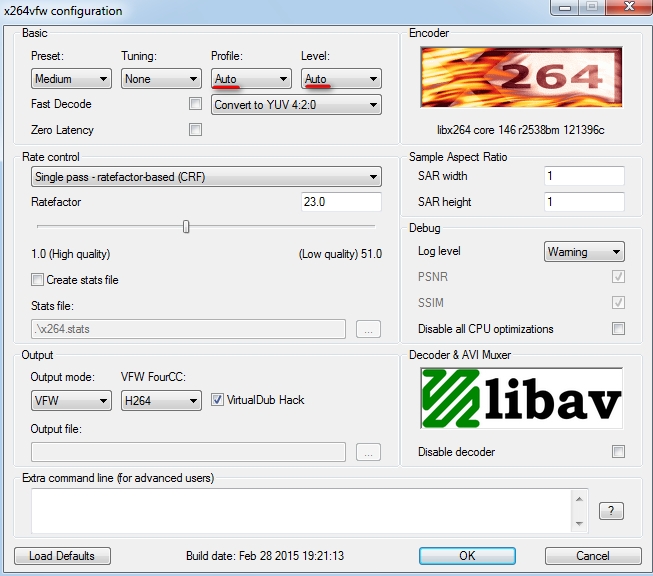

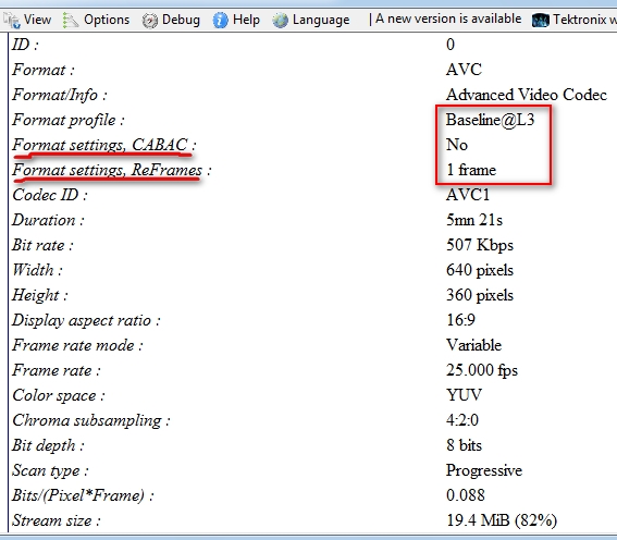

    sorry to bump. I did so as my topic is relevant to this. I use virtualdub for editing as it is easy and also possible framewise. I edited a video with "Baseline@L3" profile, 1 ref, No Cabac AVC and re-encoded with smart rendering feature using the auto profile setting. The resultant video details as viewed in 'MediaInfo" is shown here:
    It is seen that the encoded video parameters are different from that of the original. Can I conclude that this is because I used the Smart Rendering feature?

  22. Originally Posted by shans View Post
    I edited a video with "Baseline@L3" profile, 1 ref, No Cabac AVC and re-encoded with smart rendering feature using the auto profile setting. The resultant video details as viewed in 'MediaInfo" is shown here...
    I think so. Did you set the encoder to no cabac or a preset with no cabac? It doesn't automatically detect the properties of the source and match them. It doesn't have any idea what the properties of the source are. It just renders with the settings you specify.
    Though, to tell you the truth, I don't really know if the smart rendering feature of VirtualDub works with AVC. I've only used it with Divx/Xvid.
    The "MediaInfo" of the original video and the x264vfw setting I used in virtualdub are attached. Actually, after editing I chose "Fast recompress"; smart rendering and then compression as seen here. I think the edited portion alone was re-encoded with revised setting as appplicable for "auto" setting leaving the original video to its own setting.
Name:	Original video.jpg
Name:	x264vfw setting.jpg
  24. The medium preset enables cabac. Setting Profile and Level to Auto doesn't mean automatically match the source. It means automatically set the profile and level to the settings corresponding to the medium preset and the other video properties (frame size, frame rate, etc.). If you want Profile=Baseline, Level=3.0 should specify that with the pulldowns.
    Other things you can do to disable cabac are to use the Ultrafast preset, or enter --no-cabac in the extra options box.
