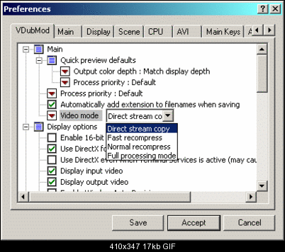

    I am using VirtualdubMod 1.5.10 whatevs beta installed from Videohelp software.
    This, by the way, shows streams list but Virtual 1.7 the newer one does not. It's all confusing.
    I put the default.vcf in the root directory for Virtual Dub Mod 1.5.10... beta.
    It does not change the full stream processing.
    In Preferences there is no "Startup" anything and I don't know how to move the pcf there if there was.
    Maybe a screen shot would help. I'm not being thick (as is usually imagined.) But I don't want to be tested either.
    Why is the mode "full processing" the default in the first place where a new user can make such

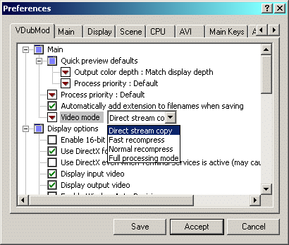

    Just pointing out I have mentioned it.
    You could always use VirtualDubMod. It'll still edit and mux just as well and it has a setting in it's options for specifying the default video processing mode.....
    VirtualDubMod:

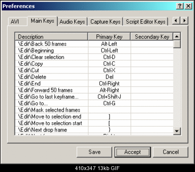

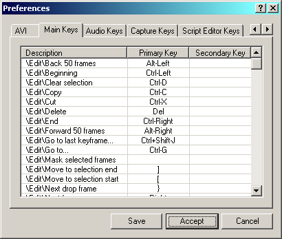

  24. I was frustrated today but did get some results.
    Other times I have asked is there a printed key for the navigation buttons? For instance-- a simple graphic that tells what the buttons do. At least on my copy, hovering does not work at all. Plus seeing the functions at a glance would be helpful.
    As mentioned I have arthritic problems with my hands. But I was able to do a couple of snips.
  25. Also thanks for the screen shot. I'll see what I can do with it. You have to admit this kind of thing is buried pretty deep.
  26. The tool tip should work if you're a bit patient. Something like two or three seconds without mouse movement. It's not instant, I assume so it's not constantly popping up in the way.
    I can capture the tool tip, or the cursor, but apparently both together is expecting too much.
    From the far left:
    Stop, play input, play output, back to beginning, back one frame, forward one frame, forward to end,
    Then the beginning with the buttons with the yellow keys on them (they do look like keys if you use your imagination):
    Back to previous keyframe, forward to next keyframe, scan back to last scene change, scan forward to next scene change
    And the last two:
    set beginning point, set end point.
    Lots of shortcut keys, but unfortunately I don't think you can change them.

  30. The screen shot given above to change to direct stream worked.
    It is a direct program change rather than something that can be added in to the program directory.
    This will save many keystrokes and errors.
