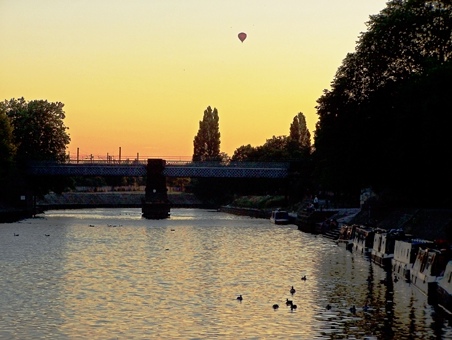

    B: Evening again, maybe 8pm or so. No way I was going to get lots of detail out of some areas, but I opened the lens a bit to get at least some outlines. This needed MDegrain2, some derainbow filters for light chroma noise, a low-power contrast mask to help the darks just a bit more, then some light NeatVideo and sharpening. With shots like this you just have to decide what's important and what isn't. Or find a better time of day.

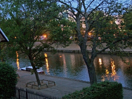

    V: Night shot, mostly spill light from tungsten lighting. The camera's meter tried to make this look like daylight (terrible!). I used a mild amber filter to kill some of the excess blue from unlighted areas.
