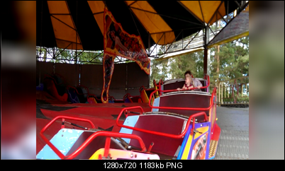

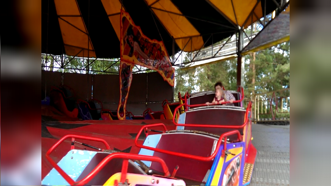

    By blur and stretch I meant that I could use a script like this to overlay the clip on a severly blurred and stretched clip:
    DirectShowSource("MY FILE")
    main=last
    BilinearResize(30,20)
    LanczosResize(1280,720)
    Overlay(main.LanczosResize(960,720), 160, 0)

    I don't think he means to stretch and blur the 1.33:1 video, but rather than adding pillarbars, take that same 1.33:1 video, stretch and blur it heavily and use it as a replacement for pillarbars with the 1.33:1 video in the middle (overlay the clear stuff on top of the blurred and stretched stuff). I don't think I'd do it with that downsizing/upsizing trick, but with a real blur filter, ones such as MedianBlur or AverageBlur.
    I see that a lot these days in Nat Geo documentaries when mixing 1.33:1 and 1.78:1 footage and find it reasonably attractive. On our local news when using 1.33:1 footage, the pillarbars are replaced with geometric designs. I don't mind pillarbars at all, but blurred footage on the sides of the clear footage is a good alternative, I think.
    Or did I misunderstand you completely and you really don't like that blurring on the sides?

    You got it completely right, I did a quick test after I wrote my last comment and I think it looks okay with the resizing method. I've used resizing before to blur since it renders quicker than any blur filter, but render speed is no concern this time.
    I'll try to find some time this weekend to check out QTGMC, MedianBlur and AverageBlur I still have 10-15 hours of video to sort through.
    Anyways here is a still with the blurred and stretched background.
