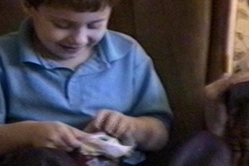

    A few details from various versions I tried. Below, frame 36 (original, interlaced). The usual combing, but look how blurred and soft the detail are in motion. The girl's hands on the right aren't even moving.
    Name:  Frame 36 original detail.jpg

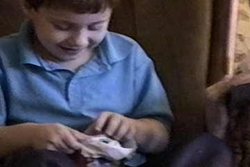

    frame 72 (deinterlaced frame 36), QGTMC slow. Looks like motion artifacts in the boy's hands, other details that aren't moving are still blurred and indistinct.
    Name:  Frame 72 deinterlaced - GTGMC slow detail.jpg

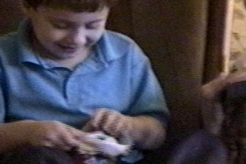

    frame 72 (deniterlaced frame 26), QGTMC slow + MDegrain2. Fingers have double edges, girl's hands are badly blurred, grain in contour details. These all look like low bitrate compression artifacts to me, yet the capture was supposedly lossless. And cloth in the chair still has too much noise, and it's not moving very much. Some artifacts on the boy's nose.
    Name:  frame 72 deinterlaced - QTGMC-MDegrain2 detail.jpg

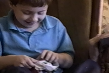

    frame 72 (deinterlaced frame 36), QTGMC fast + MCTD high. Smoother overall, most of the noise in the chair is gone, girl's detail are a bit more distinct. I kept this as the best compromise.
    Name:  frame 72 deinterlaced - QTGMC-MCTD detail.jpg
    [Attachment 32666 - Click to enlarge]
    I think it's just how the camera sensor coped with low light. Maybe rudimentary noise reduction performed by the camera or EV-C100 player though.

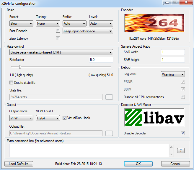

    How about a screenshot of your "x264vfw configuration" window? (PNG is better for window screenshots than JPEG and usually smaller, BTW.)
  7. Here you go.
  8. Formerly 'vaporeon800' Brad's Avatar
    Apr 2001
    Vancouver, Canada
    Perhaps set Preset to Ultrafast, tick Fast Decode, tick Zero Latency, and see what happens. Not that I would suggest to actually use that even if it removes the error. Otherwise, I dunno.
