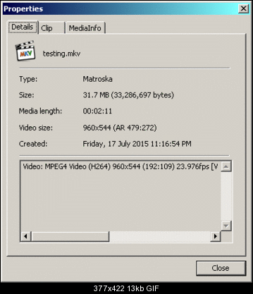

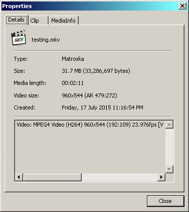

  2. Avidemux doesn't seem to keep the aspect ratio information when you're just copying the video (I'm assuming you're copying), but it makes it hard to know for sure what's happening as the aspect ratios being displayed in your screenshots are no doubt being rounded up and/or down to 1.76 and 1.78.
    960/544 = 1.7647
    Here's what a 960x544 video with a 1.76 aspect ratio looks like when opened with MPC-HC and after using the File/Properties menu (I just made one for testing, so it'll probably be different to the video in your screenshot):
    The bottom aspect ratio is the actual aspect ratio (as it's written to the container and only displayed if it's different to the resolution) and the top aspect ratio is the display aspect ratio. The two are virtually the same but the top one is rounded to the nearest whole pixel as it's how the video needs to be displayed (I'm pretty sure that's how it works). ie

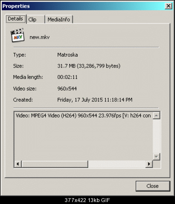

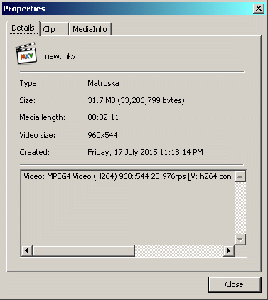

    After remuxing with Avidemux, the aspect ratio info is gone.

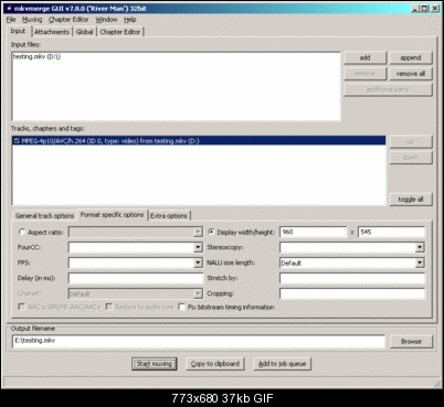

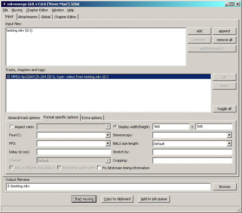

    If the output file is MKV it's easy enough to fix. Open the original file with MKVMergeGUI and check under the format specific options tab. My 960x544, 1.76 aspect ratio MKV looks like this:
    Same aspect ratio as above, different way of expressing it.
    544x960/545 = 958.239
    Make note of the display dimensions, open the MKV saved by Avidemux, add the correct dimensions, then save that as a new MKV and you should be back where you started, aspect ratio-wise.
