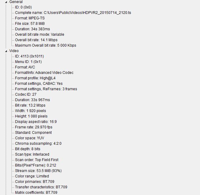

    @SHS and @jagabo
    Not entirely sure what you guys mean by the whole 1920x1080 interlacing thingy but I did a quick recording and using MediaInfo - here is what it told me...
    Is there anything listed there that is wrong and I should change in the settings menu or does it look right?

    As expected, you are recording 1080i as 1080i.

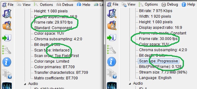

    distinctive2004, Look at Scan type it will say interlaced or progressive

  23. Member
    Apr 2014
    Originally Posted by distinctive2004 View Post
    @SHS and @jagabo
    Is that bad?
  24. Member
    Apr 2014
    CGMSA copy protection only work under S/Video and Composite not Component for the 1000's time as it dosen't support VBI (Vertical Blanking Interval) signal just like there no CC (Closed Captioning) support umder Component
    I used to think so too but that is incorrect. See https://forum.videohelp.com/threads/367416-Broadcast-Flag-Removal-%28Looking-for-softwa...=1#post2348188 Enough of the VBI is present for CGMS-A. Besides, there is eye-witness evidence to the contrary, which I linked to in my earlier post. If distinctive2004 isn't having a problem, maybe his TiVo doesn't apply CGMS-A to component out but a DirectTV receiver does.
    I had DirectTV receiver before this and now have Dish receiver never ocen did I see CGMS-A on HBO or any other channel
    Yes, I see. It says interlaced. That's ok, no?
  25. Member
    Aug 2006
    Yes, recording 1080i as interlaced is fine. The original recording on the TiVo is interlaced too.
  26. Member SHS's Avatar
    Oct 2000
    Vinita, Oklahoma
    Yes that fine
    But if there are any real show that are display as progressive then thet HD-PVR 2 will record as progressive that if your using HDMI ever know Component dose support 1080p60 that TV settop box receiver will not output it that over component only device like PC Video card, Xbox 360 or PS3 dose progressive over component
