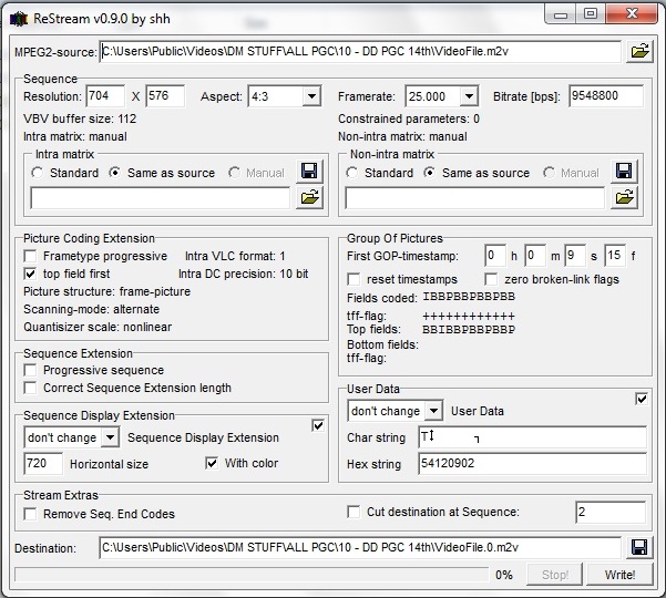

    May 2015
    Australia
    Hello,
    I have attached a screenshot of Restream when I load in my original 704X576 .m2v file.
    Could you please tell me what settings I select/deselect, tick/untick, and what to fill in the boxes?
    This is lossless correct?
    The other 20 m2v's I'm trying to get Muxman to add with this file are 720X576 PAL 25fps 4:3.
    Thanks for any help.

  9. Where it says Resolution: 704x576 , change it to 720x576
    Yes it's lossless
    Open up one of the other 720x576 videos in restream and/or gspot and have a look to see if anything is different too
    But as Skiller said earlier, it might cause problems in some programs and players
    Aug 2006
    You would simply change the resolution to 720x576. All you are doing is changing the resolution information in the headers. You are not changing the video itself.
    Maybe you will be lucky, but I can tell you from personal experience that not all video players (particularly video player software) will play a video correctly when the resolution in the headers doesn't match the real resolution,

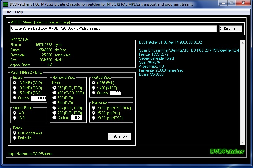

    Hello,
    I have attached a screenshot of DVDPatcher when I load in the 704 x 576 m2v, the settings in the screenshot are all left untouched as they were when I downloaded the programme, when I export the only thing I change is in the "Horizontal Size" box I change Pixels to 720, is that the only thing I need to change, to keep lossless?

  13. You should probably patch the entire file. But, your max bitrate as shown in your earlier picture is still too high so you'll most likely have to use the MP2 audio. Or, better, make an AC3 file.
    May 2015
    Australia
    I have no idea what difference it makes but if you think it's best to patch the whole file I will, better to be safe than sorry, thank you.
    Is it OK to leave the bitrate box set at 3.5MBit DVD and not 8.0MBit DVD?, I don't understand how this can be lossless as it's altering bitrate but I'm sure I'm getting the correct advice here.
    The original file bitrate says 9,548,800 bits per sec, so isn't the selection box which is selected as 3.5MBit be 3,500,000 bits per sec, which is far less than the original, is that making it lossless?
  15. Originally Posted by efc1978 View Post
    I don't understand how this can be lossless as it's altering bitrate...
    It doesn't reencode but only changes a figure in the header. It makes no difference in anything. You can leave it alone or fill in anything you like. Many commercial DVDs will say 9800 even though that's not the real max bitrate.

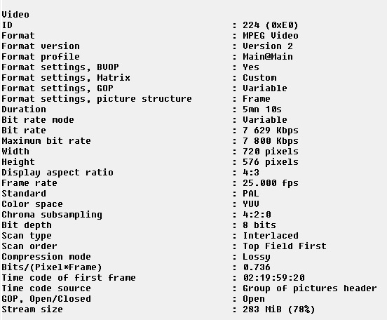

    I really need something that would output .VOB, or .m2v, as I need to demux and mux with Muxman to add my new audio.

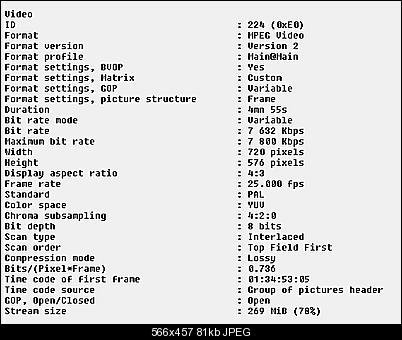

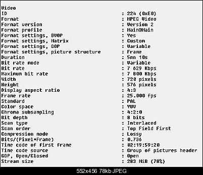

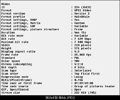

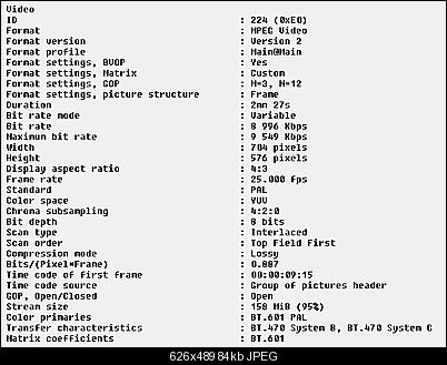

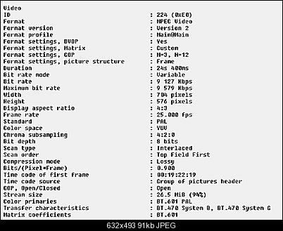

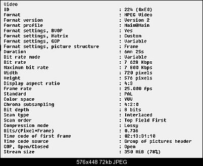

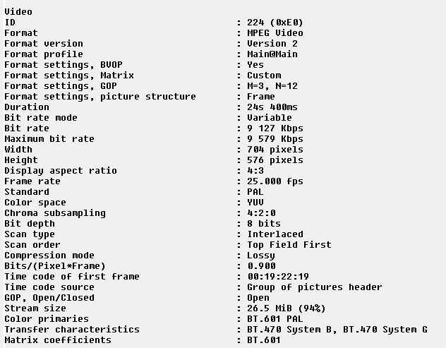

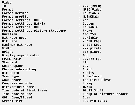

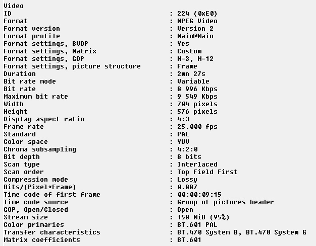

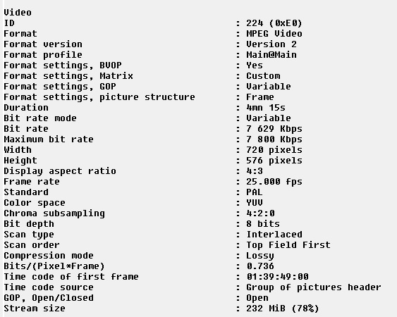

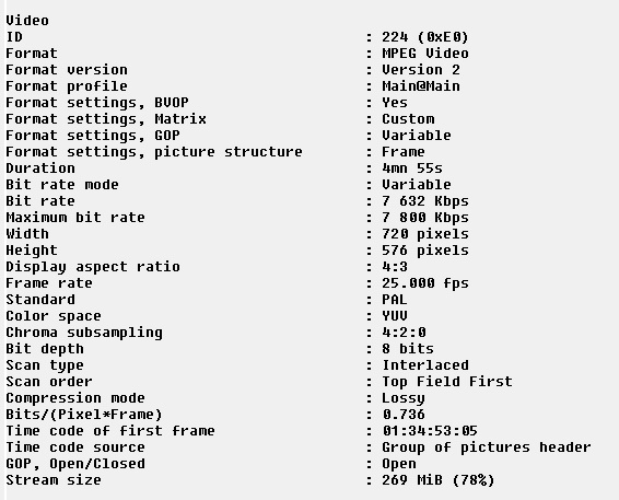

    If you post MediaInfo reports (View->Text) from one of the 720x576 VOBs and the 704x576 VOB, someone should be able to tell you how to re-encode the problem file. It is late here, so chances are that person won't be me.
    Hi,
    Here's the "video" info from Medianinfo.
    There are 2 videos I have which will need re-encoding as they are both 704, the other 20 videos I have are 720.
    I will post the Medianinfo for the odd 704 files, plus the 720 files which I want either side (before and after) the odd 704 files.
    The order of 1,2,3 is the order I wish to mux them together eg. the odd 704 file is in the middle with the 720 files first and last.
    So the first set of 3 screenshots is 720 + 704 + 720, the last set of 3 screenshots is 720 + 704 + 720.
    Some info which might be useful, these are the selections/lengths I want to keep for my project, I cut them out of full length DVD's using DVD Shrink in lossless (no compression), so they are individually in their own DVD folders (VIDEO_TS).
    Any help would be greatly appreciated, obviously I would prefer to demux them all losslessly to m2v and then mux them all together but it won't work, if re-encoding the middle (odd 704) files to highest quality is the only option I have then I guess I have no other choice... But I would really need all the help I can get to do that, including which free programme to use and recommendations for all the correct settings, and obviously I would need to export as .VOB (which includes .IFO as PGCDemux works with the .IFO), or .m2v.
    Here's the first set of 3 (with the odd 204 file in the middle of the 2 files I wish to have either side).

    And here's the second set of 3 files, once again the middle one is the odd 704 file.
    (it's actually only about 24 seconds).

  29. I said it may work (or not) but definitely it is simplest, lossless and if DVD follow H.262 standard legal.
    Excerpt from H.262 http://www.itu.int/rec/T-REC-H.262-201202-I/en :
    D.14 Concatenated sequences
    Sequence concatenation occurs when an elementary stream contains a sequence ending with a sequence_end_code that is
    followed by another sequence starting with a sequence_start_code. Any parameter including but not limited to profile,
    level, VBV buffer size, frame rate, horizontal size, vertical size, or bitrate, which is not allowed to change within a single
    sequence may change from sequence to sequence.
    The behaviour of the decoding process and display process for concatenated sequences is not within the scope of this
    Recommendation | International Standard. An application that needs to use concatenated sequences must ensure by
    private arrangement that the decoder will be able to decode and play concatenated sequences.
    Applications should ensure that decoders will have an acceptable behaviour when parameters change. For example
    changes to the
    – frame size;
    – frame rate;
    – field parity of the first displayed field of the new sequence versus the field parity of the final displayed
    field of the previous sequence;
    – buffer status,
    amongst others may cause problems.
