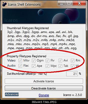

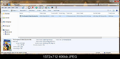

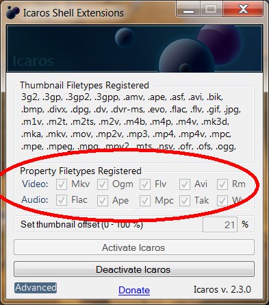

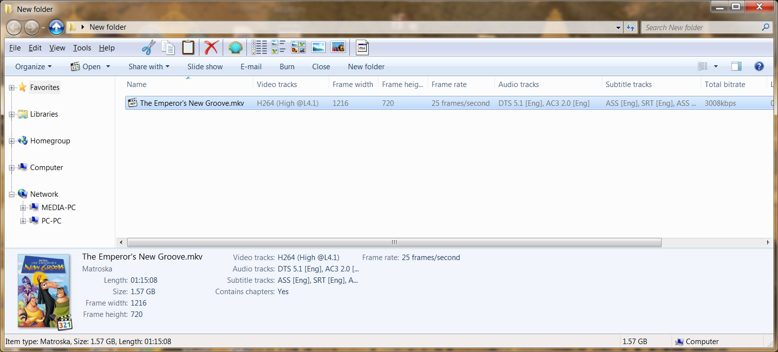

  10. When Icaros Property filetypes activated:
    Then column in windows file explorer for MKV or MP4 can displayed:
    Sep 2012
    Australia
    Yup, "icaros", that's what the codec pack uses too.
    Problem solved.

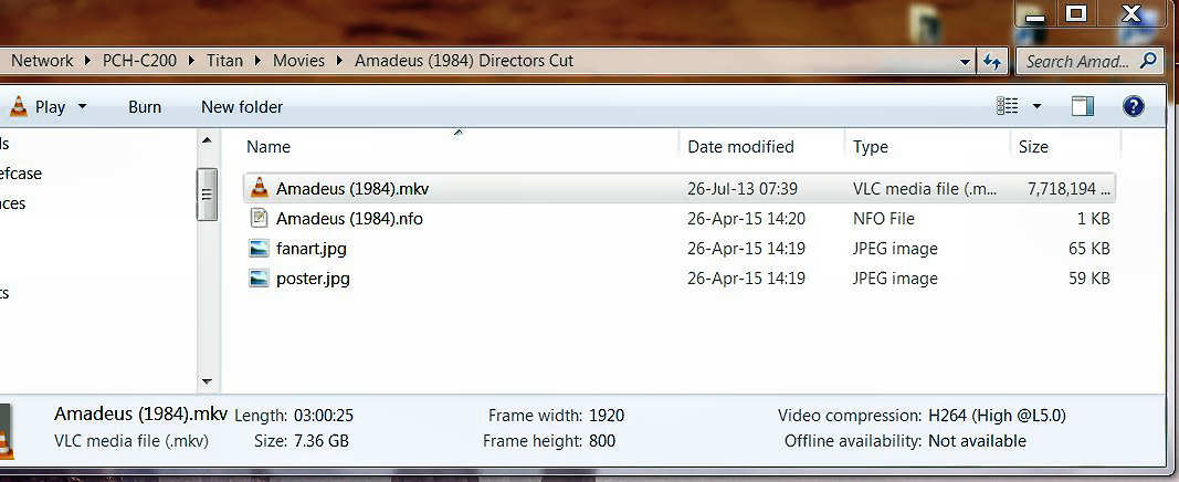

    Well I don't use a codec pack below is the capture of the a window. The file itself is at the end of my network on an attached drive to my Popcorn C200. I have also looked at a file on my C drive in Videos and it's the same for all file types including .TS
