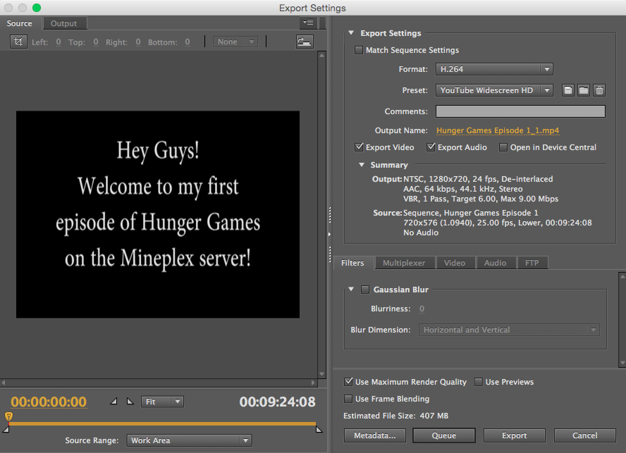

    I attached a screenshot of my Premiere export settings. Is this what you need?
Name:	Screen Shot 2015-07-12 at 16.55.01.png

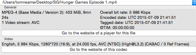

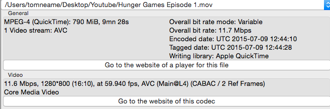

    Jul 2015
    England
    FIrst one is of the QT recording. Second one is after being exported from Premier Pro. Is this what you need?

  12. You have major issues with your settings.
    If you record 1280x800 @ 59.94 FPS, you should use the same sequence settings - not 720x576 interlaced
    Not only is it going to reduce the resolution, it's going to be deinterlaced when you export it (the scaling and deinterlacing will severely reduce the quality)
    The frameate conversions will cause problems too. 59.94 => 25 interlaced => 24p . You should keep it the same. By default, PP will use frame blending, so it will be blurry from blends added, blend deinterlacing and down/up scaling
    (And when you upload to YT, it will re-encode again, but you can't control that part)
    The "easy" way to match everything is to use the "match sequence settings" both when creating the sequence, and in the export dialog

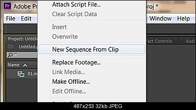

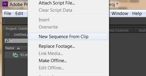

  13. You editing in lower resolution
    To create sequence matched to the clip
    in premiere right click on imported MOV file and select New sequence from clip :
    also try if possible change video resolution of the game to higher resolution
    if you want higher quality

  16. When you start editing its more easy to create sequence/timeline matched resolution to the clip
    by right click on imported MOV file and select New sequence from clip
    previously you edited on lower resolution 720x576
    Jul 2015
