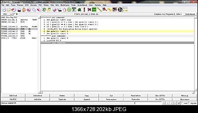

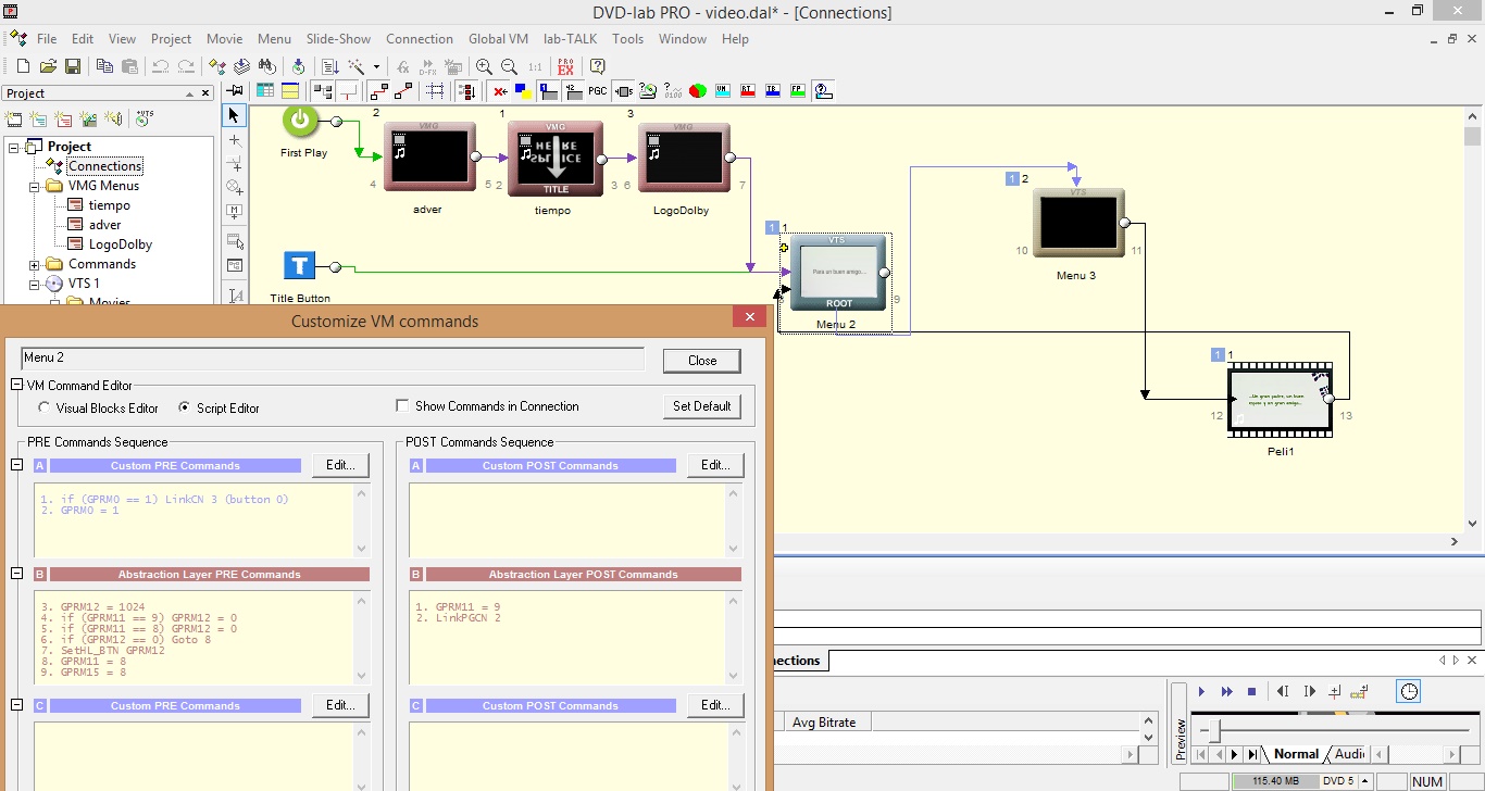

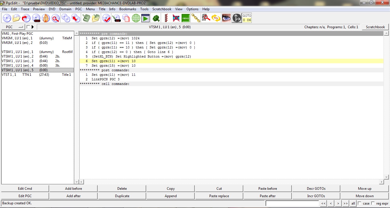

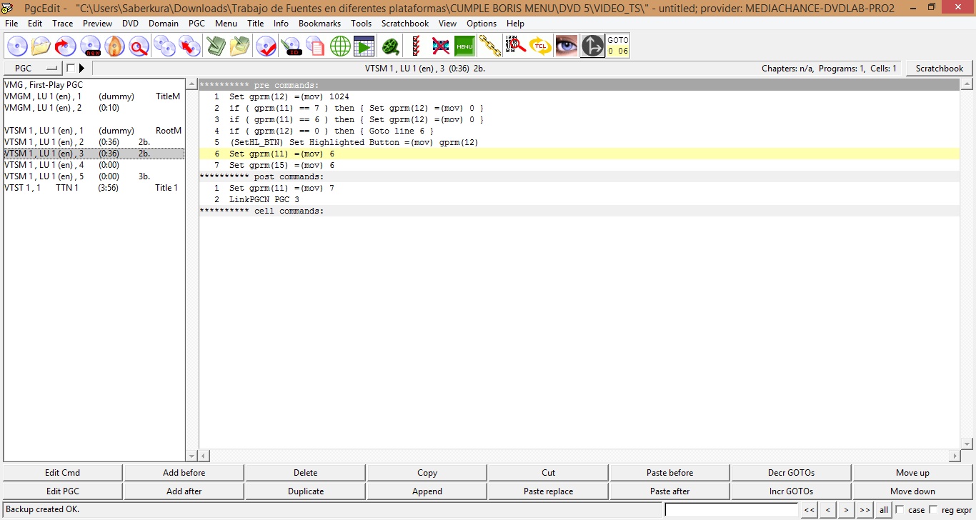

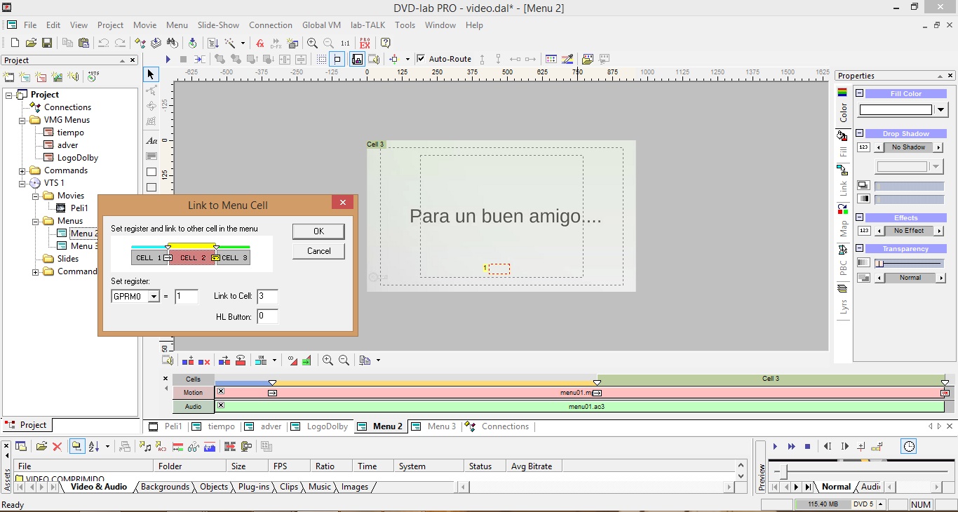

    Hello, I want to help this little problem, since before an image of codes published on cells (since I'm working on it), in the post of the summary of the play button.
    The code would look like this:

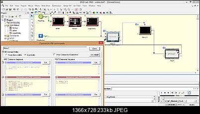

    The ROOT MENU in the pre-command put:
    if (GPRM0 == 1) LinkCN 3 (button 0)
    GPRM0 = 1
    As this image shows:

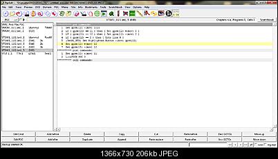

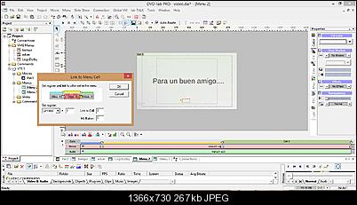

    Just inside the ROOT MENU, in the third cell it registers as GPRM0 = 1 as the following image shows:
    Now, after compiling my project, and run on media players PC, especially since there is working at 100%, but in a desktop DVD player does not work perfectly.
    The only problem is when I start the movie and return with any 2 buttons Title or Top Menu, go to the specified cell, from there everything goes right, but when bind again any of the buttons for some time returns to the movie, which should not be so, you should always go to the Main Menu (MENU ROOT).
    I would like to help and resolve this error, if you can change in the code is the same DVDlab PRO or PCGEDIT, just as the Post RESUME PLAY. Thanks to you solve the problem.
    As if there is another method to do, without the need to use these syntax, making a guide.
    What if he was seeing, it is that some publishers to its menu with animation, inserts it into two VTS's, one is the ROOT and the other VTS, but not how to do it so that you synchronize (Links, buttons, etc.) and Boton much as the Title and Top Menu do as double function, first enter the animation (INTRO) which appears after selection buttons, and when pressed again any of the two buttons between the loop without animation (INTRO) .. . not if I understand ... and that if I can make an example as a guide.
    I await your response.
    Ah !, my desktop DVD player is a Sony DVP-K80P
    Sorry my bad English.... I hope you can understand what I say.

    Let's see a little more detailed. I have a single menu navigation or rather the MENU ROOT that only unique is the PLAY button, no more navigation buttons.
    I did all connections and as well in the VMCOMAND, I put that syntax, apart that I've registered to a GPRM in one of the cells and then compile the project and burn it to DVD-R for testing in a desktop DVD player.
    Well, to start the DVD, comes what is the warning, logo, trailer, etc., until the beginning of the main menu with the animation until the appearance of the PLAY button and making the loop in the main menu .... So far so OK.
    Now, pressing the PLAY button, the movie starts and when I want to return to the main menu (part where the loop is done), you return to the Top Menu or Title button on the remote ..... until then everything ok.
    Now the problem is, being in the main menu and pressing the same button again before you press on the remote control (Title or Top Menu), it automatically returns to the movie, which should not be so. Should lead in the loop of the animation.
    Now if you understand what the problem is, that's why I need your help, whether to modify the code syntax in VMCOMMAND, whether in the DVDlab PRO or PgcEdit.

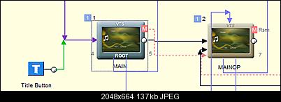

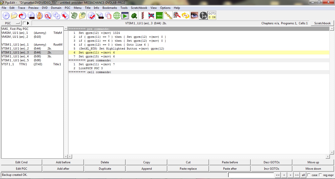

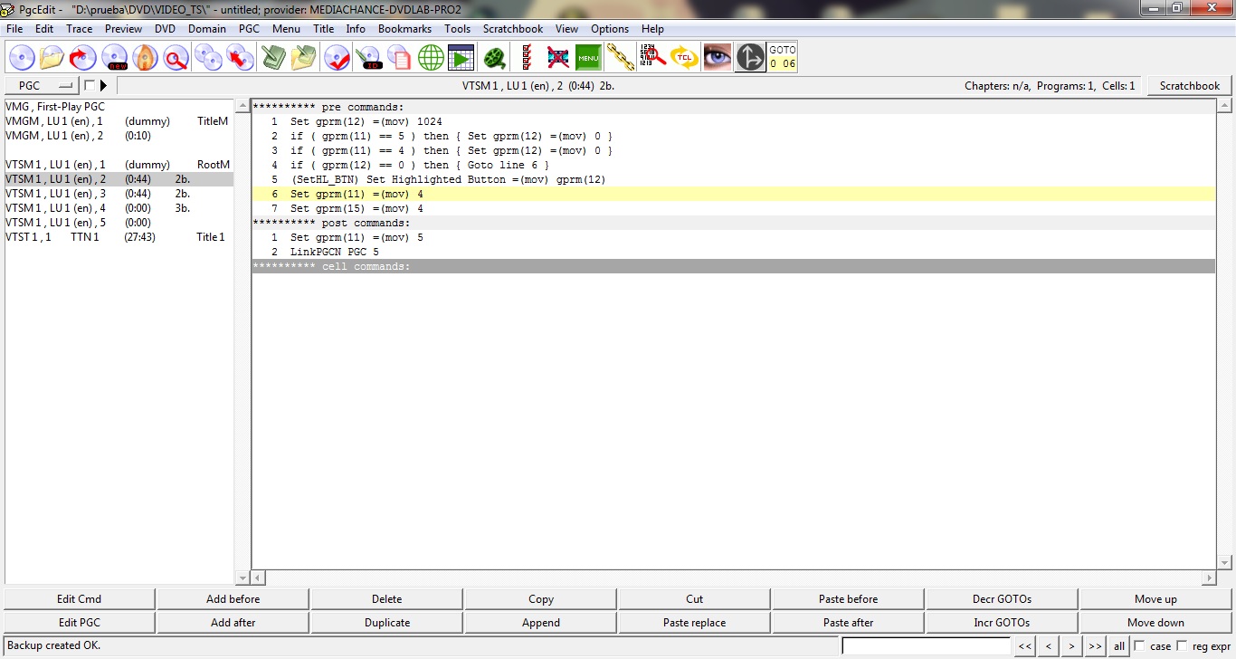

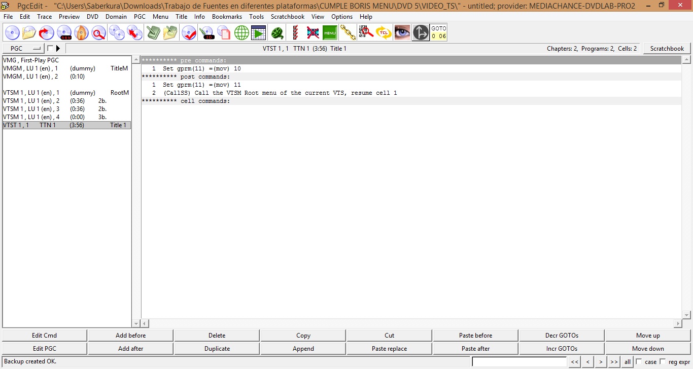

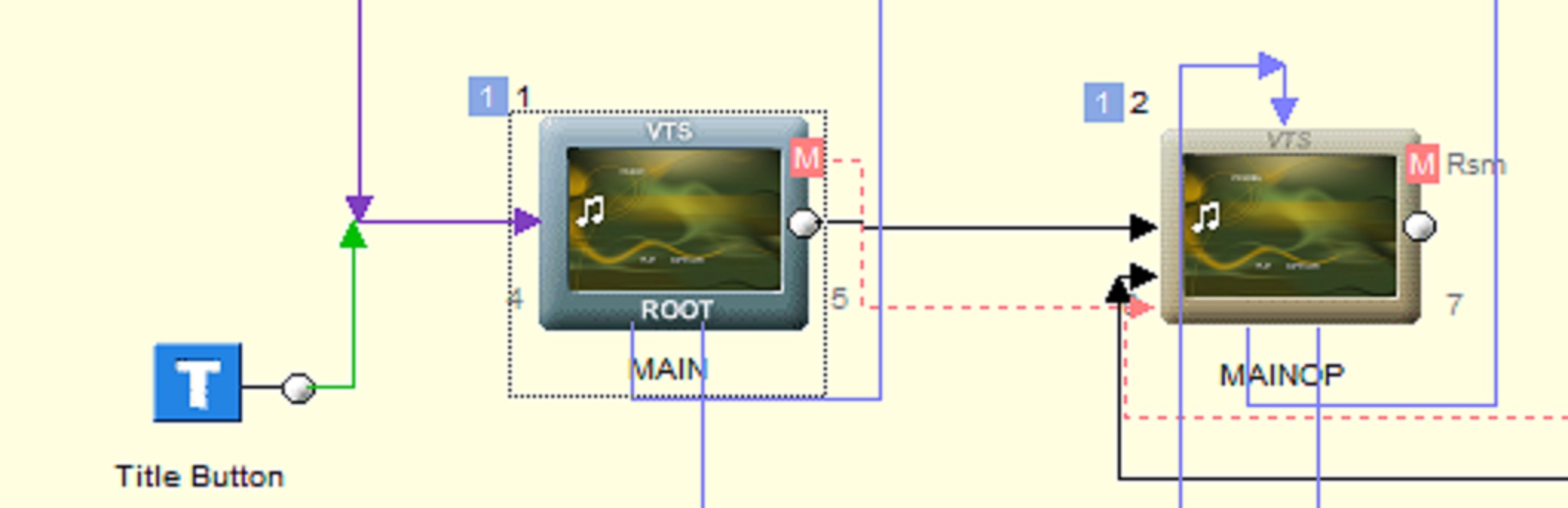

    Rather, other help friend, wanted to know how synchronized two menus connected. What this image shows:
    ROOT MENU VST structure connected to the VTS
    ROOT MENU VST connected with VTS
    As I said earlier, most DVD's have this structure (not if is correct or not), and previously worked with cells and it was easier, without any problem.
    In contrast with this structure is that it is a bit difficult as navigation buttons must be synchronized with the other buttons, for example if the Navigation VTS ROOT menu is right, the time between the VTS connected to the VTS ROOT, this must remain in the same position as above (VTS ROOT).
    Besides the Title Button to jump as much as the ROOT VTS and VTS, and when I press the Title button again, this should make the loop at the VTS, not the VTS ROOT.
    Well, not if I will understand what I say, but I know the PgcEdit program could perform such function commands, by amendment.

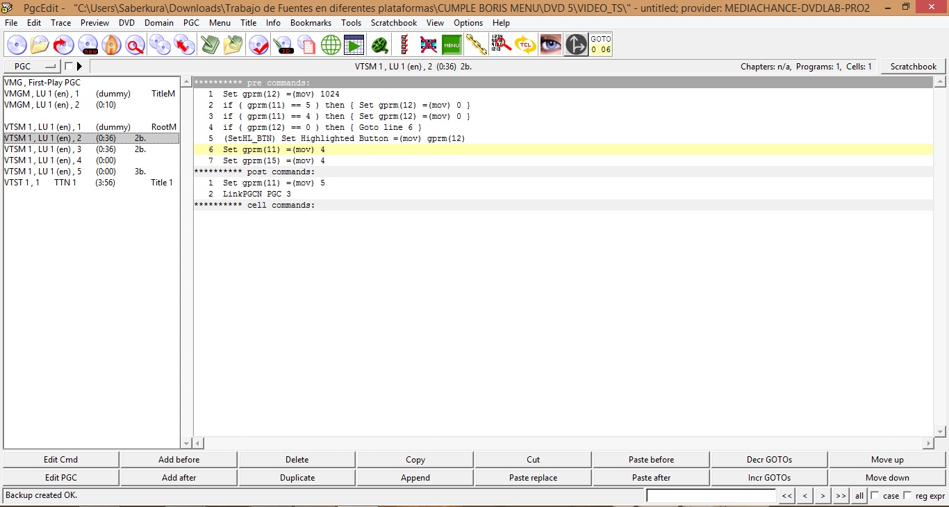

    And assuming curiosity in the PgcEdit I get two equal VTSM:
    VTSM1, LU (en), 2 - 2b
Name:	VTSM 1,2- 2b.jpg
    VTSM1, LU (en), 3 - 2b
Name:	VTSM 1,3- 2b.jpg
    There you have to do ?, as I can sync?
    Hopefully you can help me, giving me a guide to how..... Sorry my Bad English XD!!

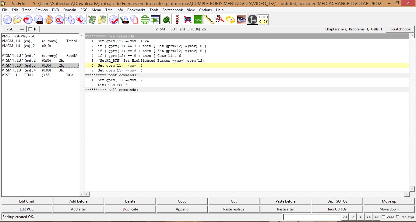

    Hello again:

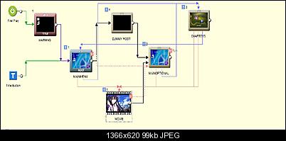

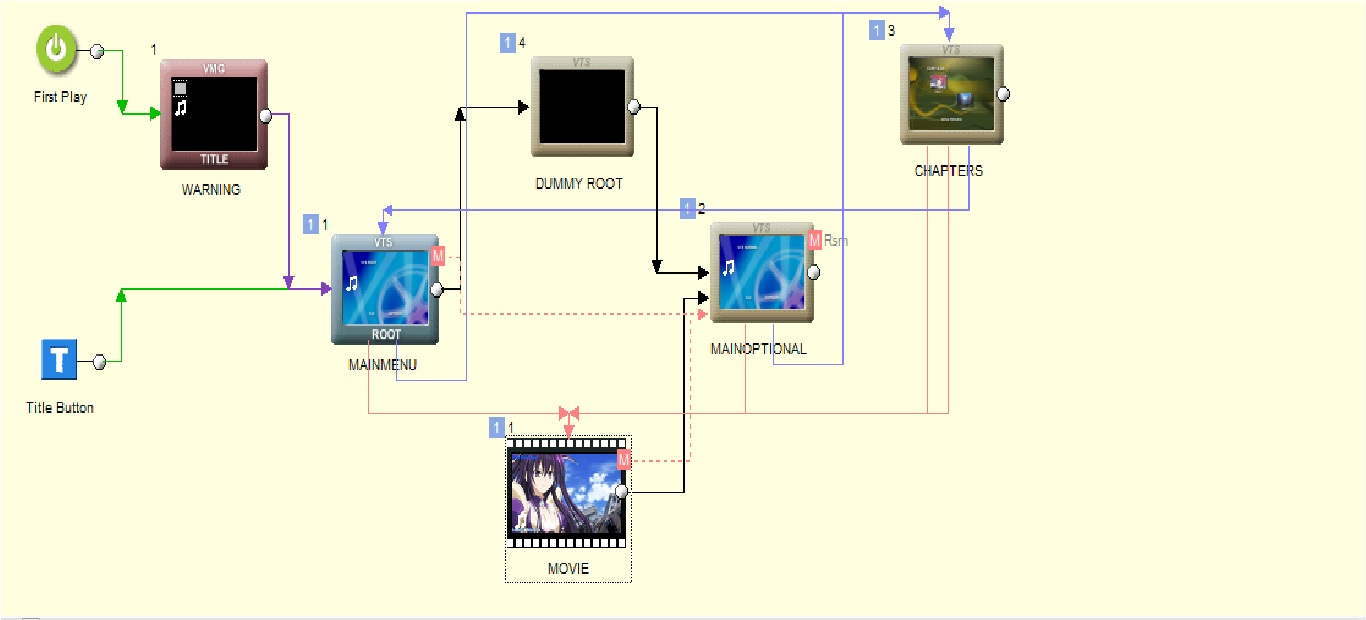

    Well, do not specify what the option menu in the PgcEdit, but here a new project I did, with only the indication of the third point or paragraph that these mentioning me, I mean add a VTS DUMMY.
    Here the picture:
    I do not know if it will be well made, but my question is about the "Title Menu" I do not know if that VTS connect the VTS ROOT or Optional Menu.
    Well, here other images after being compiled the project and led to PgcEdit. Indicating what kind of VTST 1 is:
    VTSM1, LU (in), 2 (0:44) 2b - - -> MAIN MENU (ROOT MENU)
Name:	02 MAINMENU.jpg
    VTSM1, LU (on), 3 (0:44) 2b - - -> OPTIONAL MENU
Name:	03 MAINOPTIONAL.jpg
    VTSM1, LU (en), 4 (0:00) 3b - - -> MENU CHAPTERS
Name:	04 MENUCHAPTERS.jpg
    VTSM1, LU (in), 5 (0:00) - - -> DUMMY connected between the MAIN MENU AND MENU OPTIONAL
Name:	05 DUMMY (ROOT - VTS).jpg
    Each VTSM1 contains codes in the PRE, POST and CELL COMMAND.
    As I say, there in that program (PgcEdit) do not know where to start, it would be good guide me as the post of "RESUME PLAY". Since not much is on schedule in VMCOMMAND.
    I hope to count on your help. Hopefully it is not something annoying not being able to capture your idea, since I am a relative novice at it ....
    Sorry My Bad English XD!!
    Ah! I forgot. Do not forget also how to synchronize navigation buttons ROOT MENU (MAIN MENU) with the MENU OPTIONAL, here in this guide.
  10. sorry, but I still do not know, what is the optional menu for, why is there, when you should go there and when into main menu
    -and therefore I have no idea what that "dummy root" pgc suppose to do and you did not show it in PgcEdit

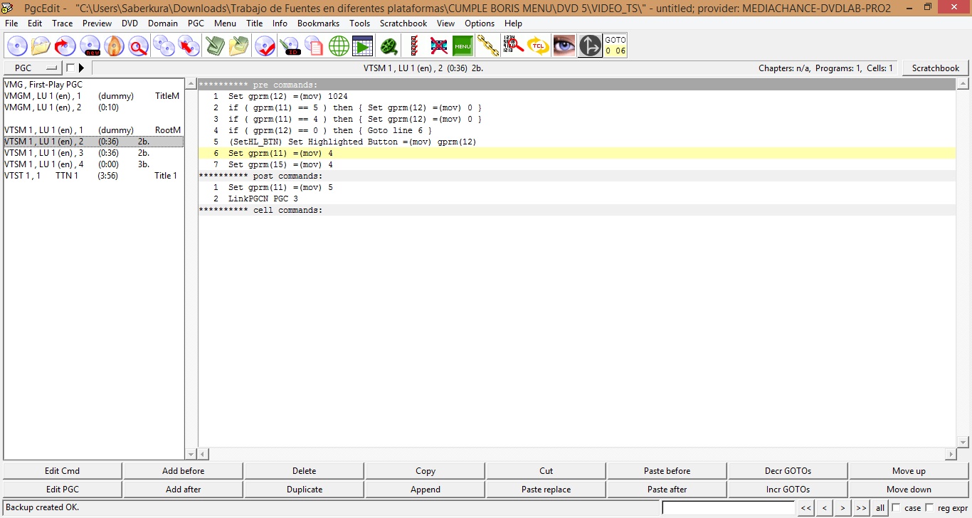

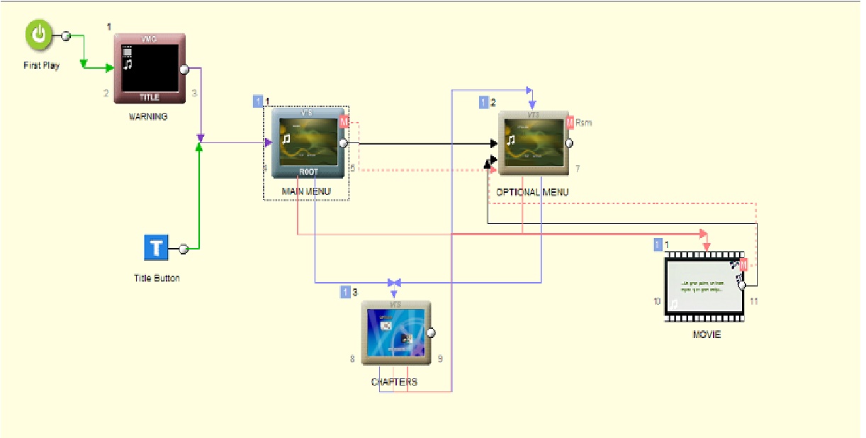

    Aug 2014
    lima

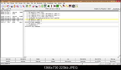

    Sorry, I think I did wrong, but here's what you told me now I've improved. See if that'll understand a little better:

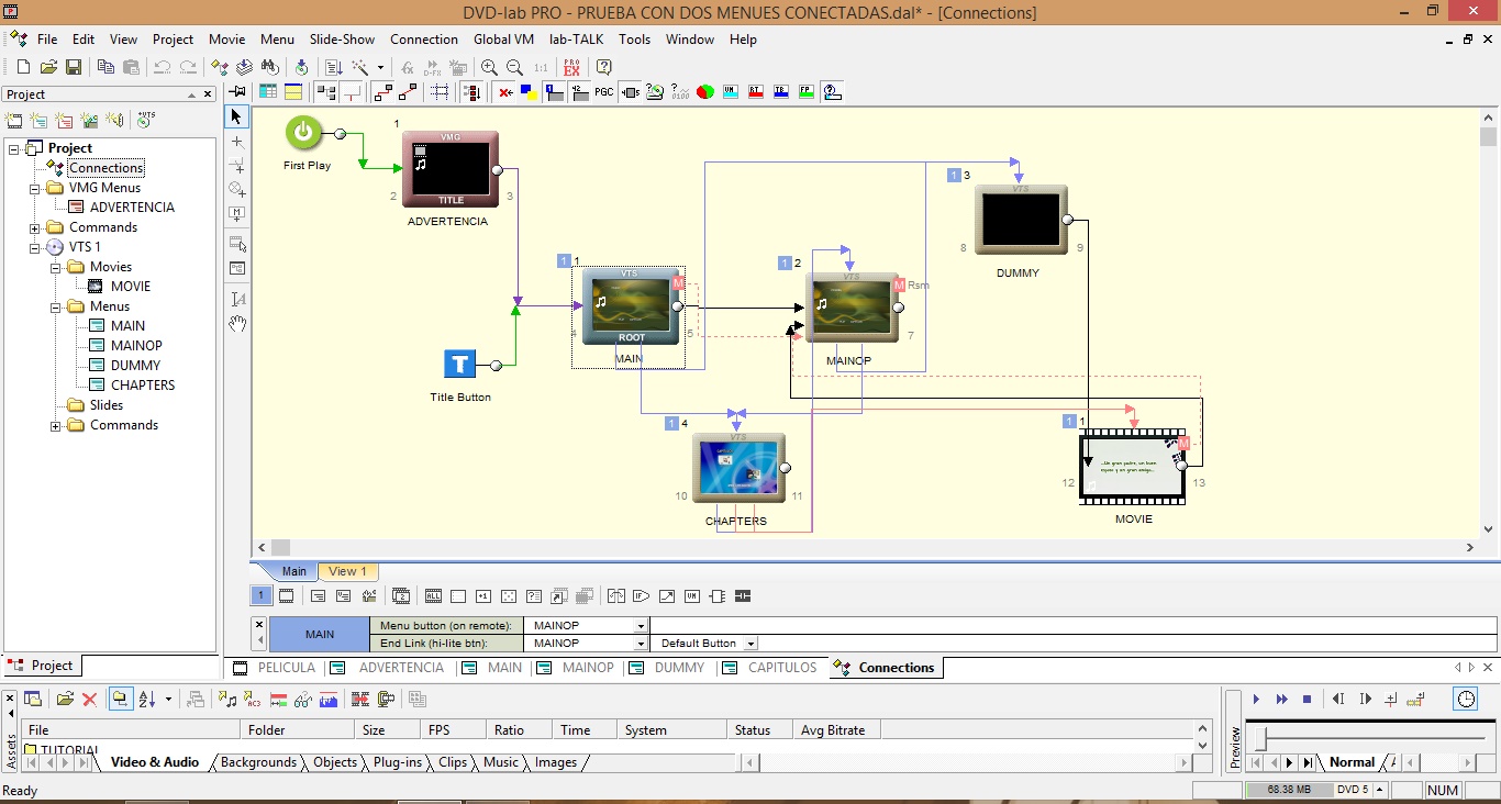

    The first VTSM 1 LU 1 (en), 2 (0:36) 2b would be the Main Menu.
Name:	02 MAIN MENU.jpg
    Second VTSM 1 LU 1 (en), 3 (0:36) Option 2b would be the optional menu.
Name:	02 OPTIONAL MENU.jpg
    The third VTSM 1 LU 1 (en), 4 (0:00) 3b would be the chapter menu.
Name:	03 SUB MENU.jpg
    And the fourth and last VTST 1, 1 TTN 1 (3:56) would be the film.
Name:	04 THE MOVIE.jpg
    Now as this enhanced and hopefully not be another mistake, and I ask again: How I have it perform? And Where should I start? Or rather, it is set in the pre, post or CELL COMMADS ?. As well as program the button title. Giving me a guide or instruction manual as the previous POST.
    And do not forget again, about the timing of the navigation buttons for both VTS ROOT and OPTIONAL MENU.
    Again, apologies .... Sorry My Bad English XD
  12. We are lost in translation,
    you do not answer questions, in DVD navigation one has to know when going into main menu and when into optional menu.
    You just say I need to go to menu options, but not saying why. So how can one write a code not knowing what is going on in you navigation?

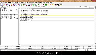

    Ok, good, to summarize everything, it would be:
    How I can make a menu like the Transformers 4 and the passion of Christ?

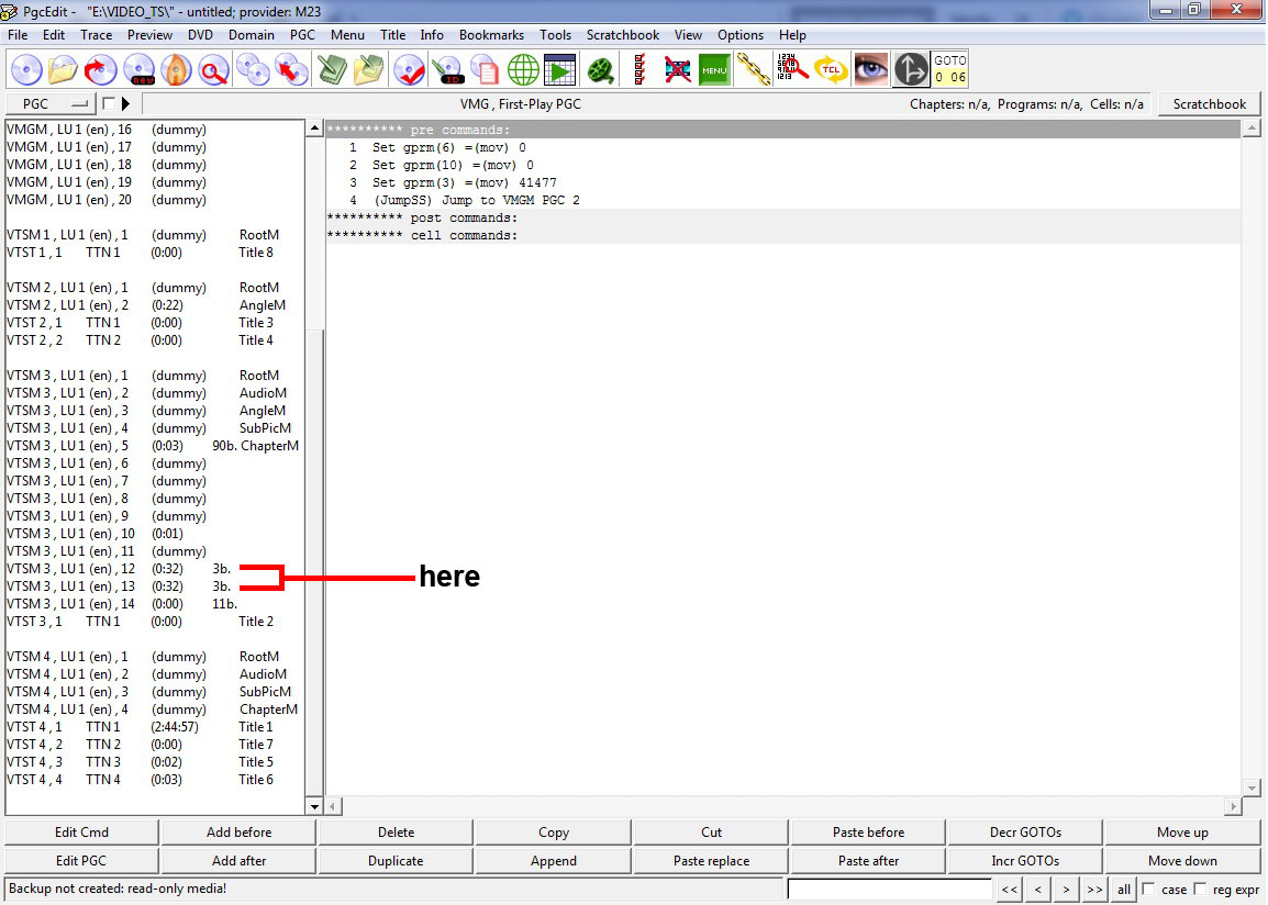

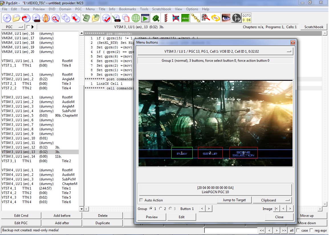

    Since I was checking in PgcEdit of the two DVD's, and there is a part that caught my attention:
    Viewing the content of the DVD of Transformers 4 in the PGCEdit

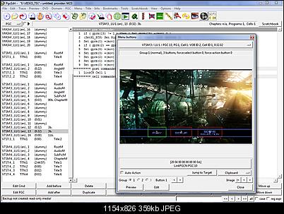

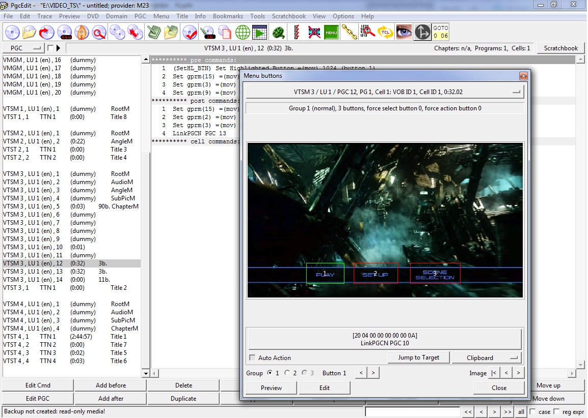

    As you can see, there are two VTSM - 3b equal.
    And when viewed with the "Show Menu Button" each, which is displayed:
    VTSM3, LU 1 (en), 12 (0:32) 3b
    VTSM3, LU 1 (en), 13 (0:32) 3b
    As the first image shown it would be it animation INTRO until the appearance of the navigation buttons.
    And the second image would be the animation with the navigation buttons.
    There do not use cells, and are linked and synchronized with the navigation buttons, "Title" button and "Menú" button (for jumps), as if a general menu working with cells.
    I do not know if that is you clarify your question.
    Also, as not is if it will be well structured in my project it is, the "Title" button, VTS ROOT and what this linked with the ROOT VTS and other connected objects.
    So as you would in the DVDlab PRO and PgcEdit ?, giving me details of how to do it.
    I await your prompt response.
    Once again... Sorry my bad English XD.... Hopefully not too much trouble to ask and get the point I want.
  14. I guess they are two DIFFERENT menus. Probably the first menu has an introduction, and the second menu not. It's very common in commercial DVDs.
    The idesa is that when you insert the DVD, the first menu is shown, with the intro. But when you press the menu button or when the navigation comes back to the menu after having played a title (or another menu), than the intro should be skipped, and therefore the second menu is shown.
    However, I'm not sure it's the case in the example posted above, because the two menus have exactly the same duration. But if the two menus have exactly the same content, I don't see the benefit in jumping to the second menu instead of the first. The content and navigation will be identical anyway, and therefore it's just more complex, without reason.
    Have I missed something?

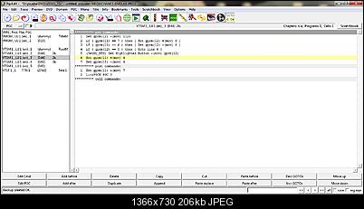

  16. OK. I haven't read the whole post (because it's a pain), but I suppose that you want the first menu (with the intro) to be called when the DVD is inserted, and the second one when the Root menu button is pressed. It's easy.
    1. In PgcEdit, use Info -> GPRMs. You will see a little window with the 16 GPRMs. Locate any free GPRM. (It has a light green background and "free" in the button at the right side, instead of the usage count.) Note the number of the free GPRM. In this explanation, I will use GPRM 14.
    2. Select "VTSM 1, LU 1, 2" (the first menu, with the intro). Inserts these pre-commands at the very beginning:
    ********** pre commands:
    [20 A4 00 0E 00 01 00 03]   1  if ( gprm(14) == 1 ) then { LinkPGCN PGC 3 }
    [71 00 00 0E 00 01 00 00]   2  Set gprm(14) =(mov) 1
    [original commands follow]
    (Of course, change the two GPRM(14) to the free GPRM located in step 1.
    That should be sufficient.
    How it works:
    When the DVD is inserted, the free GPRM has the value 0.
    The first pre-command checks if the value of the GPRM is 1, and if it's true, it jumps to the second menu (to PGC 3).
    Since the first time, the free GPRM has still the value 0, the jump is not executed, and the navigation continues to the second pre-command.
    At that point, the value of the GPRM is changed to 1, and the original commands are then executed normally: the menu is played, with the intro.
    When the navigation returns to the first menu, the value of the GPRM is now 1. Therefore, the condifion of the first pre-command is true, and the jump to PGC 3 is executed.
    In PGC 3, the pre-commands are executed normally and the menu without intro is played.
    OPTIONAL:
    Note that with that method, the intro is played only once per session. You can force the intro to be played again if you wish by resetting the free GPRM to 0. For example, if you insert [71 00 00 0E 00 00 00 00] 1 Set gprm(14) =(mov) 0 as the first POST-command of the movie PGC, you can force the intro to play again when and only when the very end of the movie is reached. (The intro will not be played if the menu is called by the user during the playback of the movie with the ROOT menu button. It will be played only if the user does not interrupt the movie.)
    You can also force the playback of the intro if the user press the TITLE menu button of the remote during the playback of the movie, instead of the Root Menu button. Currently, your DVD has no Title menu PGC (and that means that pressing the TITLE menu button does nothing), so if you want to do that, you must create a Title Menu PGC. Right-click any VMGM PGC and select "New Dummy PGC". The "VMGM, LU 1 (en), 3" will be created. Right-click it and select "Set Entry Menu Type" and select "Title menu". Now, that PGC will be called when the user presses the Title menu button.
    Replaces the NOP pre-command in the PGC with this:
    [30 06 00 01 01 83 00 00]   2  (JumpSS) Jump to VTSM 1, Root menu (TTN 1)
    You should be able to understand what these commands do. Right?

  17. Sidenote:
    You use the term "VTS" incorrectly, and that was a major problem to understand what you mean.
    VTS means "Video TitleSet". In your DVD, there is only one VTS. In the example in post #13, there are 4 VTS.
    A VTS has usually two parts: the VTSM part contains the menu, and the VTS stricto-sensu (VTST in PgcEdit) contains one or several titles.
    As explained elsewhere, a menu can be divided in LUs (Language Units) but that's not really important.
    Each domain can be divided in several PGCs. In your DVD, the VTSM 1, for example, contains 4 PGCs.
    Each PGC can contain a certain number of video cells. (You can see them when you open the "PGC Editor"). A menu PGC can also have no video content (0 cells), and in that case it is called "dummy PGC". (A Title can also contain dummy PGCs, but only in certain rare situations, too complex to be explained here.)
    The chapters and programs of a title must point to a cell, and therefore a Title with several chapters must have at least the same number of cells.
    I guess that most of the time, when you use the word "VTS", you mean "PGC". For example, in my explanation in the post above, I have explained how to jump to PGC 3 from PGC 2 when the value of the free GPRM has changed. The VTS do not change: you are still in VTSM 1.
    Your terrible English combined with the bad DVD terminology were responsible of the difficulty to understand you. I hope that I have now replied correctly to your original question.
